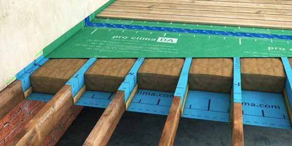

Iceverge Posted October 18, 2024 Share Posted October 18, 2024 For the amount of work that renovation will take your best option is a demolition and rebuild of a simple compact house. If you must stick with the current design central heating is a good chunk lower down the list than other issues. 1. What is you ventilation plan? 2. What is your airtighess strategy? 3. How much insulation can you fit? If you do a top job on all three of these you can really really cheap out on the central heating. Maybe an A2A split unit with 2 fan coils, electric UFH in the bathrooms and an ESHP for DHW. Assuming you just want advice on the heating. 1. Dig out all floors, install a good chunk of insulation 150mm PIR or 200mm EPS minimum and do UFH with closely spaced pipes in a shallow screed for high power output to suit a high heat demand house. 2. Insulated the suspended floor with this method. If the joists are shallow you can allow the blue membrane to droop below them for more insulation. Then install high output radiator's and large diameter piping throughout. Beware UFH over poorly insulated floors will be very expensive to run. Link to comment Share on other sites More sharing options...
