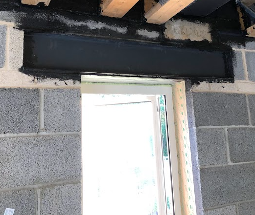

crispy_wafer Posted October 12, 2024 Posted October 12, 2024 I have this steel above a window, what should I do to prepare for plasterboard, plasterboard will be dot/dabbed on this wall. Should I set timbers into the web and screw cement board flush to the block?

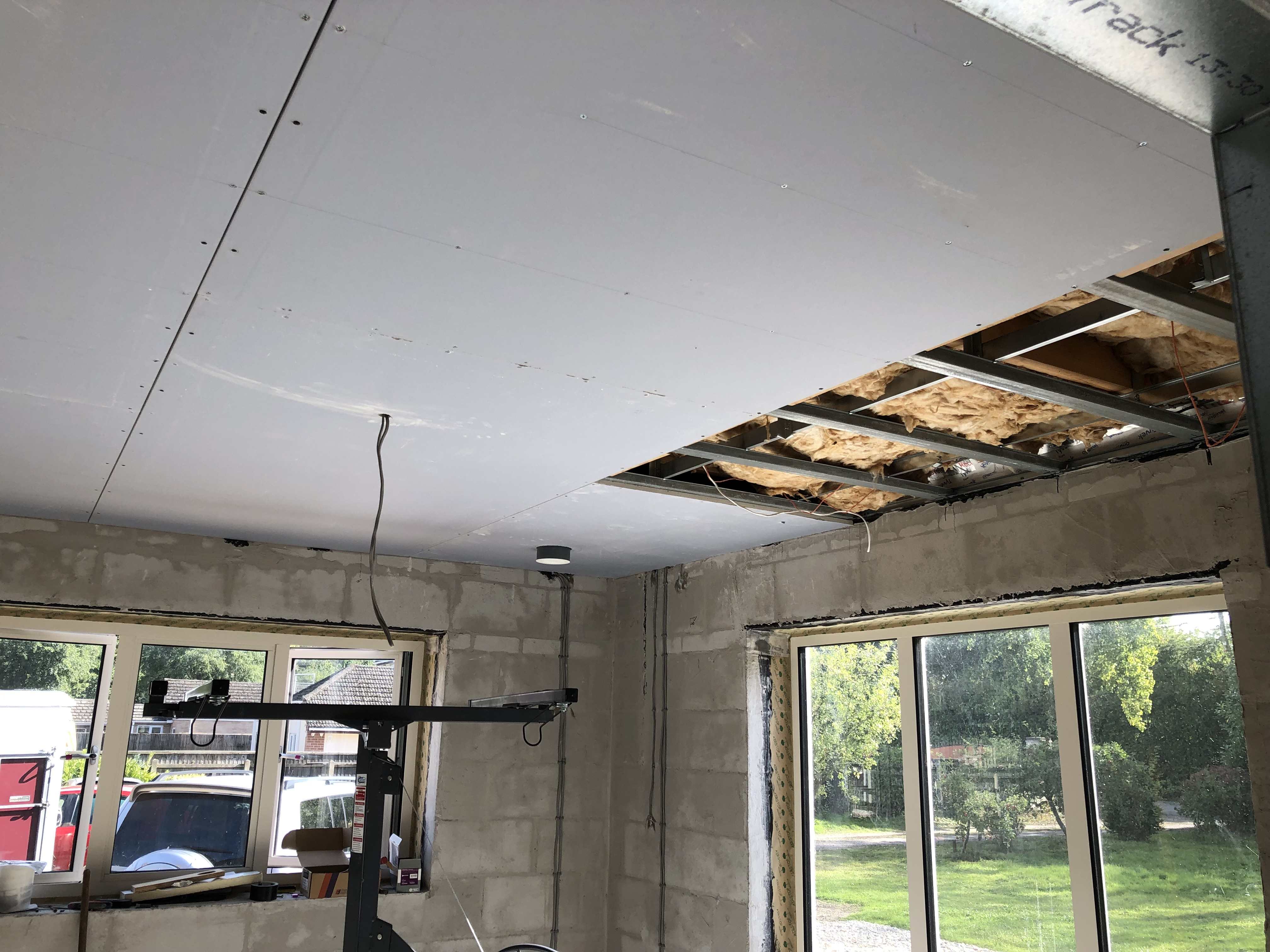

Conor Posted October 12, 2024 Posted October 12, 2024 Our guys just used a single board to span our steel heads entirely. Nothing done apart from some wool insulation. 1

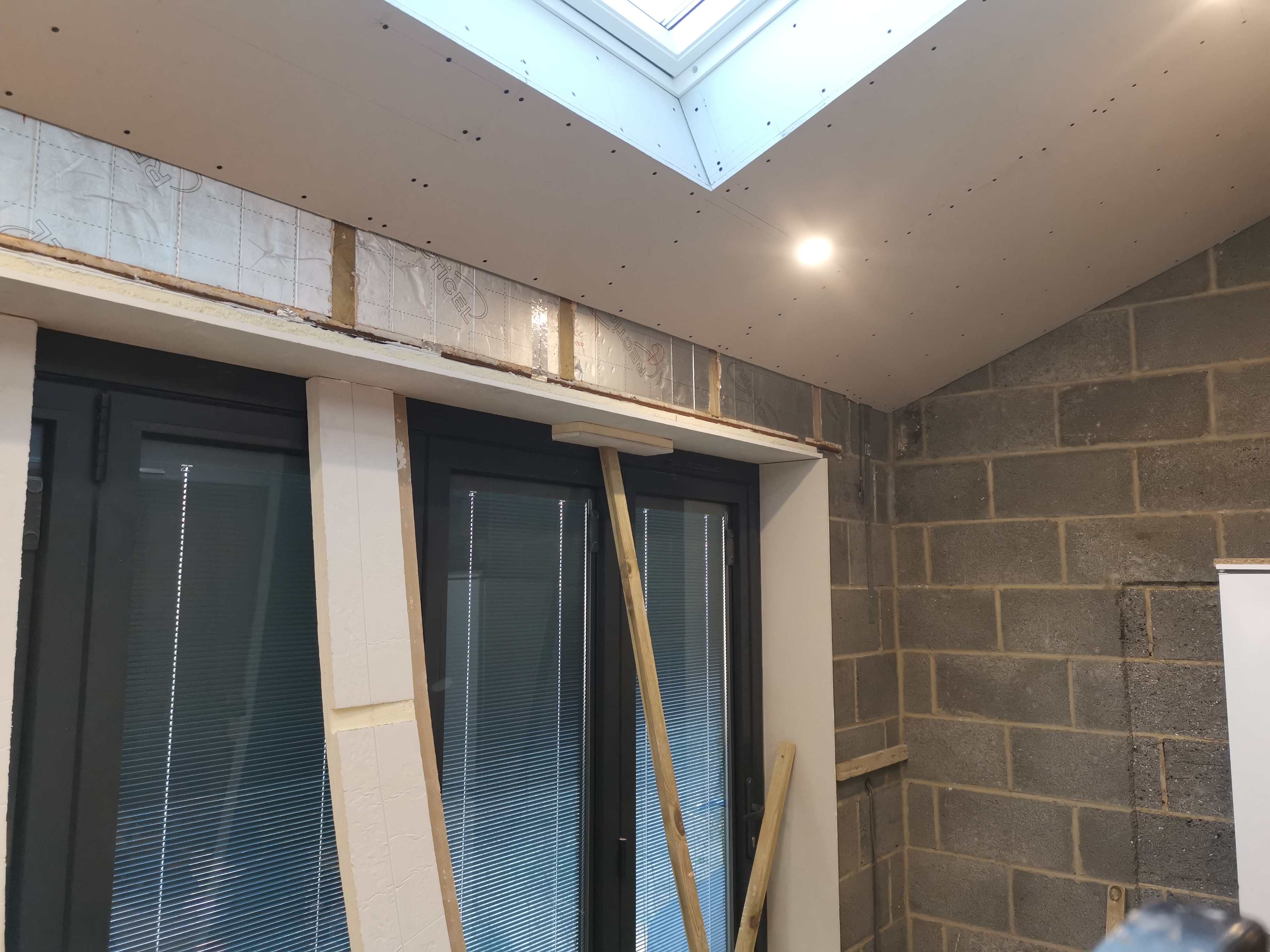

Super_Paulie Posted October 12, 2024 Posted October 12, 2024 (edited) I filled in with slim PIR, then hammered in timber wedges just proud along the length. Then filled in-between with thicker PIR, foamed and screwed the board on. Insulated board underneath attached with Sika EBT. Seems to work! Edited October 12, 2024 by Super_Paulie 1

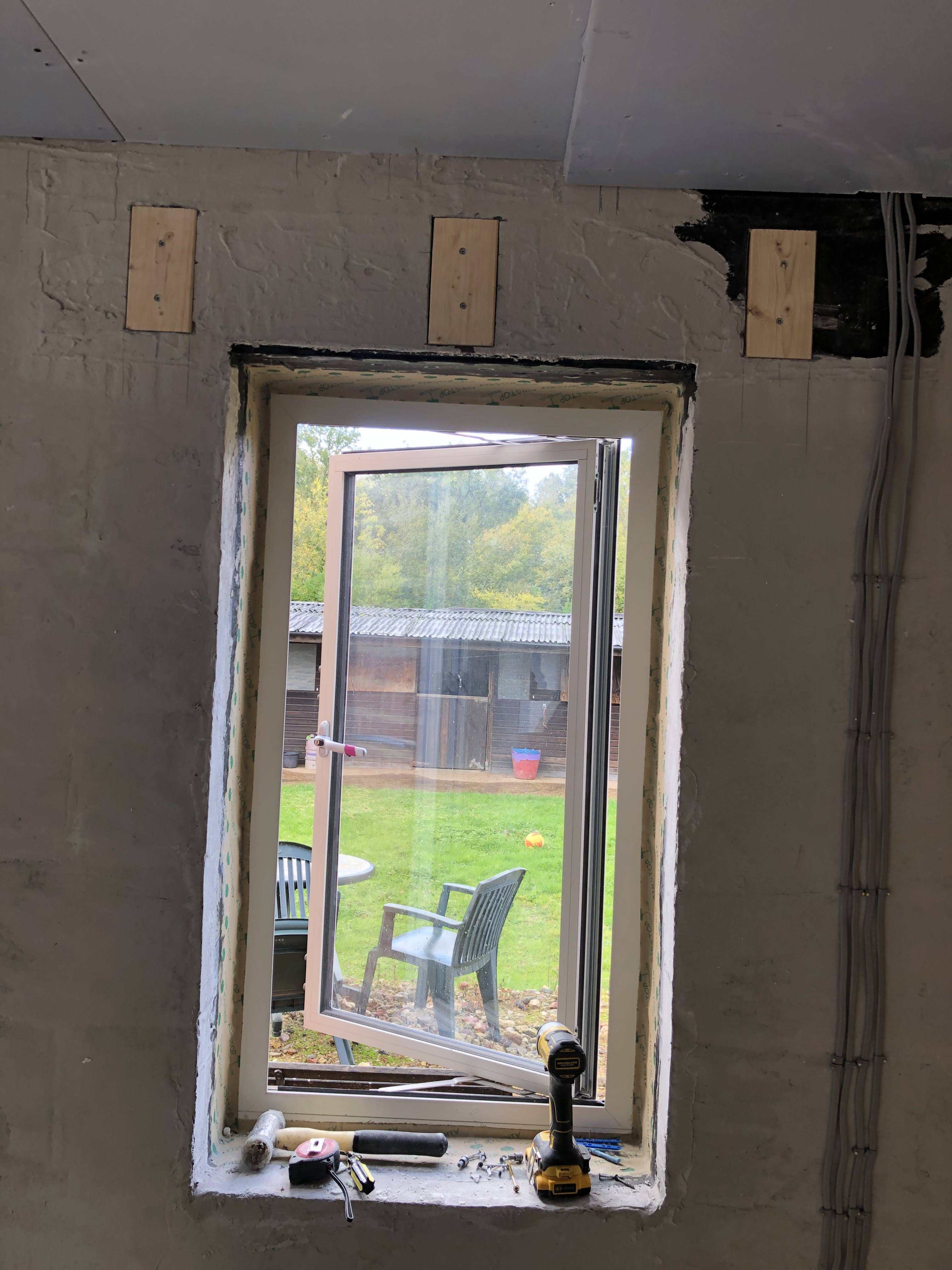

crispy_wafer Posted October 13, 2024 Author Posted October 13, 2024 Done! Cut out some of the PIR and Knocked in timbers, and tekscrewed though the steel. Some more of mine and missus rough arse parge on show too!
Super_Paulie Posted October 13, 2024 Posted October 13, 2024 Wont the screws be a cold bridge though, if they are through the beam? Miniscule in the scheme of things I'd have thought, but I kept away from going through the beam just incase. I didn't have access to the outside face as it had already been bricked in order to insulate from that side.
crispy_wafer Posted October 13, 2024 Author Posted October 13, 2024 Possibly, The steel is on the warm side of the cavity insulation and if the screws are an issue then I think the steel flanges top and bottom are probably more of an issue... I think I can live with it.
