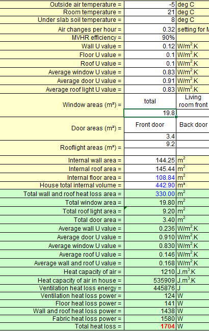

Dunc Posted October 9, 2024 Share Posted October 9, 2024 Apologies for yet another "how big does my ASHP need to be" question; I've read a lot but understand very little. ASHP to drive UFH for a 1.5 storey house, well insulated (U=0.1/0.12/0.1 W/m2K roof/wall/floor) and airtight (<0.6ACH) with MVHR. JHarris spreadsheet heating demand 1.7 kW (-5C out/21C in, to match UFH design quotes). Various quotes from ASHP/UFH designers suggest heat losses and pumps sizes: 4.8 kW loss/8.5kW pump, 4.7 kW loss/5kW pump, 3.9kW loss/5kW pump. All seem to be using -5C out/21C internal temps, flow temp 45C, return temp 5C SAP calc indicates 4.45 kWh/m²/yr, if that's relevant. 3 key questions: 1. Have I done something wrong in the JH spredsheet? 2. Can the ASHP be too big? i.e. supplier recommending 8.5kW pump for a load of 4.8 kW (or 1.7 if I'm right!)? 3. If the 4.7 or 3.9 kW load is correct and paired with a 5kW pump, is there enough overhead for DHW duty? Bonus Q: One supplier suggested that fitting a buffer will "deal" with an ASHP that is oversized. Does that sound right? Link to comment Share on other sites More sharing options...

JohnMo Posted October 9, 2024 Share Posted October 9, 2024 19 minutes ago, Dunc said: @JohnMo are you suggesting that a 4kW pump would be fine because the heat load is being over estimated, and my 1.7kW figure is correct. Or that even if heat load is ~3.9-4.8kW a 4kW pump is sufficient? @Beelbeebub not built yet but rather late to make a subtantial change in the overall plan! If it 1.7kW it would be fine. If its 3.9-4.8kW obviously not big enough, then you are looking at a bigger heat pump. The JH spreadsheet is pretty close to reality, in my experience and our house. We are around 200m2, very poor form factor, (single storey, all vaulted ceilings, long thing building) not Passivhaus, we have a heat loss of around 3.5kW at -9 and a 6kW heat pump. Link to comment Share on other sites More sharing options...

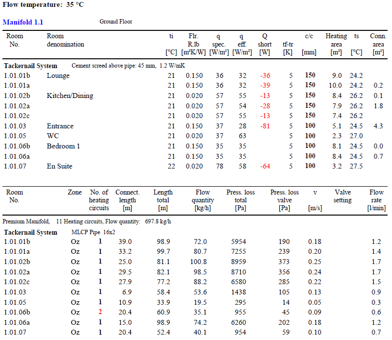

Dunc Posted October 11, 2024 Author Share Posted October 11, 2024 Thanks for the thoughts, everyone. Very helpful! Clarifications: @ReedRichardsTypo (I can't edit the orignal post). Companies I've requested designs from all use flow 45C and return 40C, deltaT 5C. @Chanmenie U values should be correct, MBC Timberframe "pasive" frame with blown cellulose fill...so yes, we should be on the way to passive levels for both insulation and airtightness. Form factor is reasonable but not perfect, 1.5 storey but with a lean-too entry/utility, and thermal bridging not perfect. @BeelbeebubYes, we are far north: Inverness-shire. We can see snow on Ben Wyvis this morning 🙂. Great point on future proofing the installation site! I'm really curious about the design temps. Only one company will share the details prior to me coughing up significant cash. This one calculated transmission heat loss of 2.373 kW and ventillaiton loss of 1.506 kW for a total of 3.879 kW (26 W/m2, 9 W/m3). I asked them to recalculate performance for flow 35C / return 30C and they sent the data below...seems to suggest that with a 26C temperature differential, a flow of 35C is not sufficient? Link to comment Share on other sites More sharing options...
JohnMo Posted October 11, 2024 Share Posted October 11, 2024 Couple of issues The W/m2 looks huge for your heat loss value. With MVHR your ventilation heat loss, drops to 100 to 150W. Not 1.5kW. So reality your W/m2 should be half they are quoting. The dT quoted is rubbish, you would be in 3 to 5 range heating the floor direct from heat pump. The smaller the dT the higher the output for a given flow temperature. So would really be flowing 30 or less. It also makes the flow rates quoted as rubbish, the lower the dT the bigger the flow rate. The other thing you need to look at is your house design temp, is -5 low enough, really depends where in Inverness-shire you are. I am in Elgin, we had a month worth of days that hit -9 last year and the year before. 1 Link to comment Share on other sites More sharing options...
