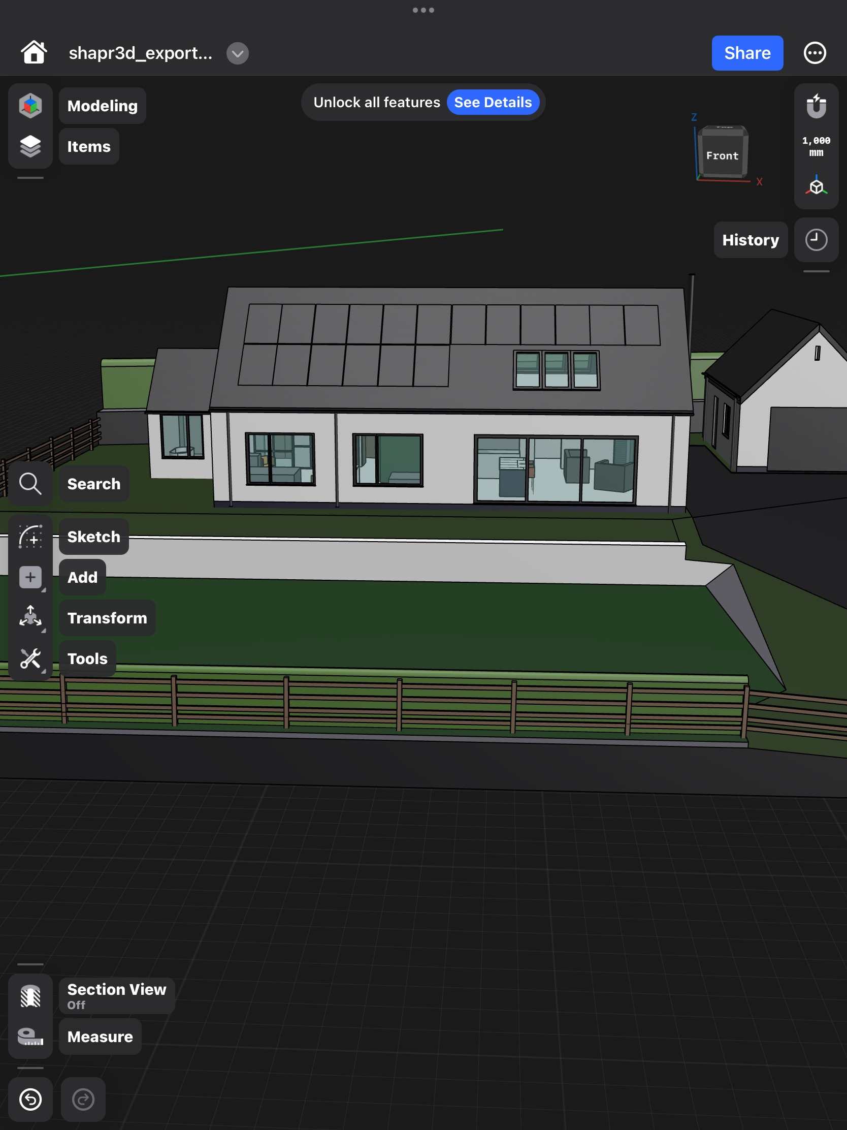

DannyT Posted October 8, 2024 Posted October 8, 2024 Has anyone here had similar doors supplied in aluclad or just aluminium? What kind of money did you pay? Had a quick online quote with windows24. 8 windows were at £15k, about what I expected but the sliding doors in 3 panes, triple glazed came in at £27k and front door 5k. if I was not sitting already, I might have fell over! At that price there would be a redesign. cheers
