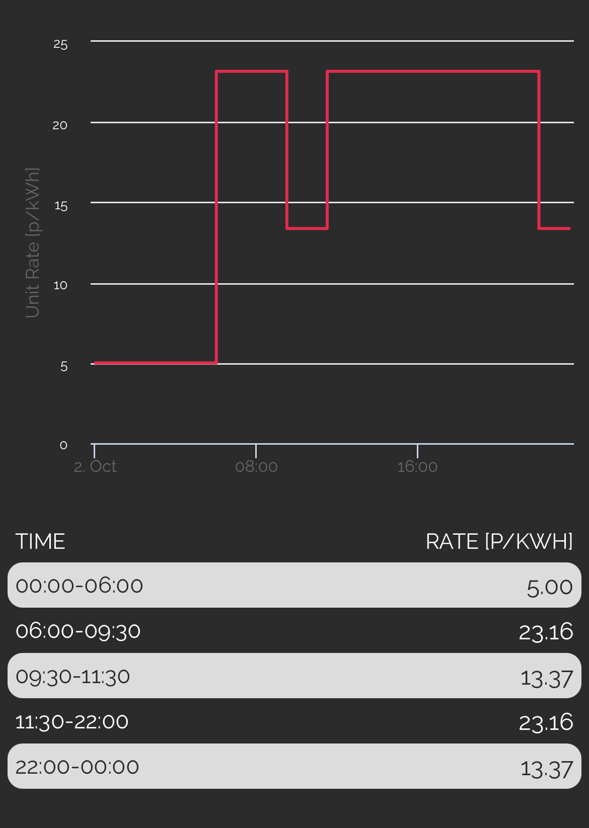

PNAmble Posted October 2, 2024 Posted October 2, 2024 (edited) 10 minutes ago, sharpener said: Can you post a link? Tried to investigate this but they have an automatic lookup so I cannot see their smart meter tariffs as it's not going to be installed until tomorrow. the quote on the website is dependent upon what you have, my quote with heat pump EV, Battery,Solar is shown below. There is no link until you ask for a quote. The other big thing was also the 40p standing charge as opposed to OIG which was going up to 72p. Edited October 2, 2024 by PNAmble
sharpener Posted October 2, 2024 Posted October 2, 2024 Thanks. The shoulder price at 13.37p is not much more than the Cosy cheap price of 12.11p. But the cheap period is all in one lump so I would not be able to round-trip the batteries 3x per day. Time for some serious modelling. Once I have the smart meter I will certainly ask Tomato for a quote. How have you found their customer service?
PNAmble Posted October 3, 2024 Posted October 3, 2024 (edited) 7 hours ago, sharpener said: How have you found their customer service? The cheap slot enables me to fill my battery and put a good charge in my car (low mileage). If predbat needs to top up during the day it uses a bit during the shoulder period. However my heating hasn’t come on yet so that test is still to be had. Only joined a few days ago, they have problems billing apparently and their mywhatts site is ropey. But I’m sure it will get fixed. Im in a complaint with octopus and their customer service has fallen off a cliff. To me, I record my info, I down load my DCC data, so I don’t really care what the service is like as long as I get power as cheap as possible. Edited October 3, 2024 by PNAmble
