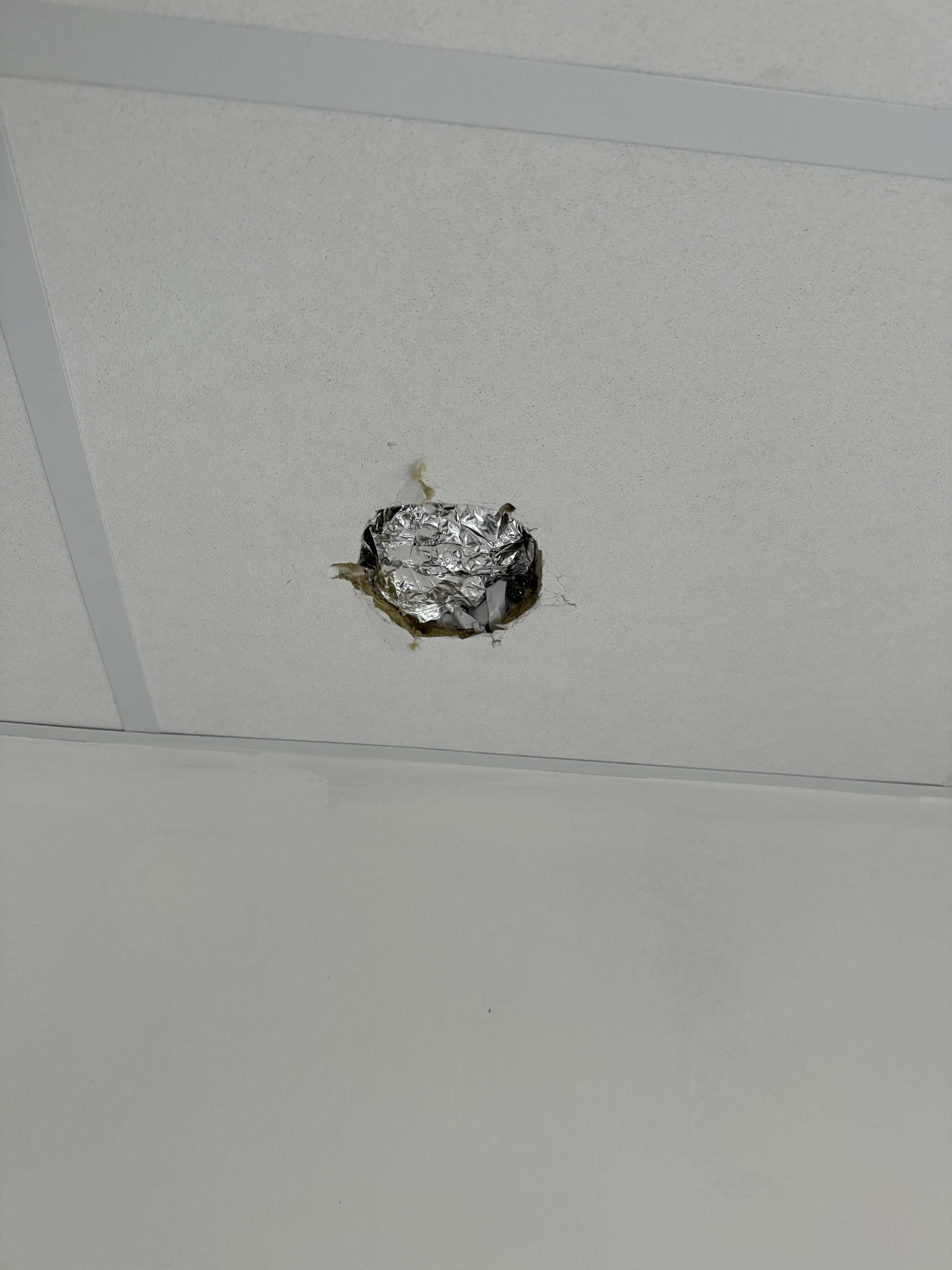

Pocster Posted October 25 Author Share Posted October 25 2 minutes ago, Thorfun said: if all you want to do is pass then i think the value might still be 10ACH? (someone can correct me if i'm wrong) as building regulations suck. i believe that anything below 5 requires MVHR so anything above that then you've wasted your money on MVHR. the lower it is the better it is. your place is a concrete box, right? so should be pretty low. good luck! Read conflicting things on mvhr . Turn it off obviously but close all vents or remove outlet pipes from mvhr ? . I won’t do anything to guy arrives - just wondering Link to comment Share on other sites More sharing options...

Thorfun Posted October 25 Share Posted October 25 Just now, Pocster said: Read conflicting things on mvhr . Turn it off obviously but close all vents or remove outlet pipes from mvhr ? . I won’t do anything to guy arrives - just wondering ours wasn't commissioned at the time so we just blocked off the external incoming/outgoing vents. we taped airtight membrane to them. i wouldn't bother with closing off all internal vents tbh. just block the route to the outside and job done. also need to block off soil vent pipe and any bathroom fixtures that haven't got water in the trap. basically any hole that leads to outside. Link to comment Share on other sites More sharing options...

Pocster Posted October 25 Author Share Posted October 25 Just now, Thorfun said: ours wasn't commissioned at the time so we just blocked off the external incoming/outgoing vents. we taped airtight membrane to them. i wouldn't bother with closing off all internal vents tbh. just block the route to the outside and job done. also need to block off soil vent pipe and any bathroom fixtures that haven't got water in the trap. basically any hole that leads to outside. Blocking the route to the outside apart from getting on the roof would mean disconnecting the internal mvhr pipes to the unit . Link to comment Share on other sites More sharing options...

Thorfun Posted October 25 Share Posted October 25 Just now, Pocster said: Blocking the route to the outside apart from getting on the roof would mean disconnecting the internal mvhr pipes to the unit . oh. 😞 ours were easy access. 1 Link to comment Share on other sites More sharing options...
Pocster Posted October 25 Author Share Posted October 25 Just now, Thorfun said: oh. 😞 ours were easy access. See what he says . I suppose he could suggest just turning mvhr off and run the test and see . Link to comment Share on other sites More sharing options...
Thorfun Posted October 25 Share Posted October 25 Just now, Pocster said: See what he says . I suppose he could suggest just turning mvhr off and run the test and see . the problem is that every vent has a route to the outside, right? and you can't close off the vents of each individual room as they're fixed in place to ensure the correct flow rates. i guess you could cover them in an airtight material somehow. maybe your tester will know of a way 1 Link to comment Share on other sites More sharing options...
Pocster Posted October 25 Author Share Posted October 25 Just now, Thorfun said: the problem is that every vent has a route to the outside, right? and you can't close off the vents of each individual room as they're fixed in place to ensure the correct flow rates. i guess you could cover them in an airtight material somehow. maybe your tester will know of a way Erm - who said my vents are set to the correct flow rate . Erm , commissioning / balancing the mvhr - who said that was done 🤣. I’ll just close all the (expletive deleted)ing vents ! 🤣🤣🤣🤣 1 Link to comment Share on other sites More sharing options...

Pocster Posted October 25 Author Share Posted October 25 Just now, Thorfun said: you are the master of cowboys! Remembered this vent had ‘issues’ so quickly stuck a sponge in it and taped over it in a hurry !! Link to comment Share on other sites More sharing options...
