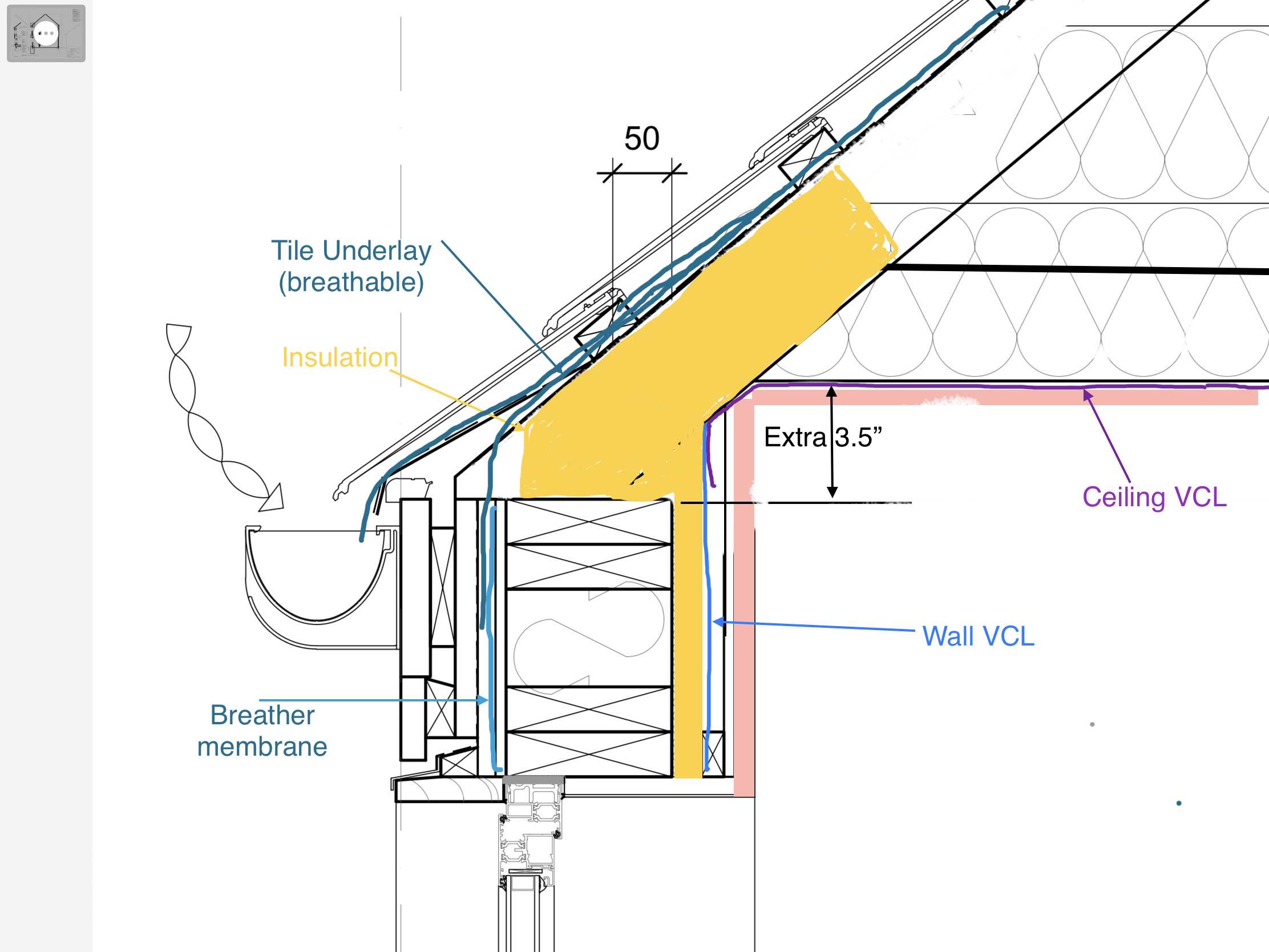

September 29, 20242 yr Author 10 hours ago, Iceverge said: A quick sketch. Couple of things. I'Ve assumed a 35 deg roof pitch. PIR in the walls......................between timbers........................groan..............Anyhou. Here's a sketch of my idea. A fink truss with extended 300mm tails to allow for increased ceiling height. I was braced for the grimace re PIR in the frame! I do note your concerns…. and I will price up blown cellulose for the loft….. however as for the ceilings….. I think I’ve understood, so I’ve drawn up what will be our version. I know we could easily raise the ceiling more, but I hate chamfered rooms. I did briefly consider raising the tie enough to accommodate everything, wires and ducts. But it feels like more work and materials thus more time and money than plasterboarding straight onto the bottom chord of the trusses.

September 29, 20242 yr 2 hours ago, G and J said: But it feels like more work and materials thus more time and money than plasterboarding straight onto the bottom chord of the trusses. Don't do this. Who ever is installing the plasterboard will tear the membrane. Use 70*20mm strapping to make a service cavity below. It might enable you to push the trusses to 600cc too rather than the standard 400mm needed for 12.5mm plasterboard

September 29, 20242 yr Author 5 hours ago, Iceverge said: Don't do this. Who ever is installing the plasterboard will tear the membrane. Use 70*20mm strapping to make a service cavity below. It might enable you to push the trusses to 600cc too rather than the standard 400mm needed for 12.5mm plasterboard Plasterboard ceilings need to be supported on 400mm centres? Good heavens, I’m so out of date. I’m standing in my kitchen and both upstairs and downstairs ceilings are 12.5mm plasterboard straight onto 600 centres joists or trusses. But then, this house was built a third of a century ago. How times change.

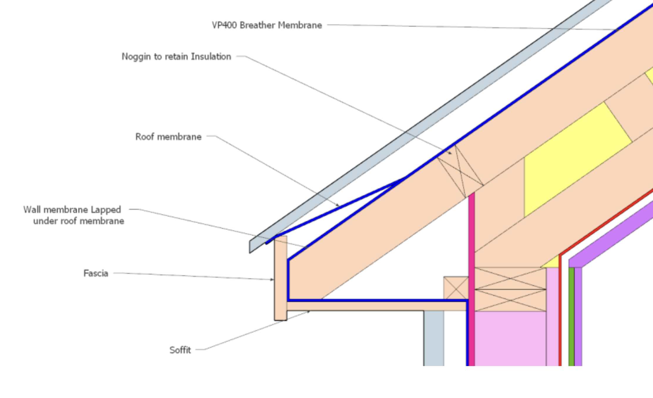

September 30, 20242 yr Author Just thinking through all this, and I can’t work out how the membranes would be done in practice. Is there a way of sealing the lapped wall membrane to the roof membrane? It could be just laid underneath it but I can’t see a way of that join being taped up.
October 7, 20251 yr On 30/09/2024 at 08:46, G and J said: Just thinking through all this, and I can’t work out how the membranes would be done in practice. Is there a way of sealing the lapped wall membrane to the roof membrane? It could be just laid underneath it but I can’t see a way of that join being taped up. I thought I would resurrect this post as I'm faced with a very similar position as you and would be keen to know how it went. I have been researching methods to remove ventilation in our attic roof space (cold roof construction) during a major property renovation and came across this discussion. As we are installing EWI and taking lots of steps to improve U Values and air tightness, I believe the draughty attic is a weak link in our quest. I have shared this "method" with my builder and he has responded with the same questions, especially the detail around the wall plate and how to airtight seal around all the trusses as we simply can't "wrap around" the Tyvek Supro. Any further pointers appreciated.
April 6Apr 6 I think you're likely to have problems. You are essentially building a cold roof setup, which relies on ventilation to remove moisture from the roof. The moisture will get there, either from an imperfect vapour control layer installation (inevitable) above your ceiling. It will will naturally occur due to changes in the weather. For instance the roof might be perfectly happy on a warm day with 60% humidity inside the loft and outside. Then overnight the temperature drops and the loft gets cold, then condensation will occur in the loft just like due forms outside. Without ventilation, this could become an issue over time. No point taking the risk really, just ventilate it and no harm done. It won't affect the temperatures inside the house.
April 11Apr 11 you wont pass building control inspection if your cold roof isnt correctly vented. The tyvec at ridge needs cutting out as it will be overlapped with dry kit for the ridge. eggboxes at eaves where cavity insulation is covered by loft roll etc. you can only get condensation if heat is escaping into the loft, 400mm min of loftroll everywhere and no probs. Forget using loft as storage.
April 11Apr 11 Author Crumbs, this post brings back memories. We got sign off for a cold, unventilated roof, but we went for a ridge vent anyway. Turns out just having a ridge vent gives ooodles of ventilation. Making the roof truly airtight would have been impossible. So our airtight layer is the VCL above the ceiling plasterboard. Hopefully this will keep our steam out of the loft.
