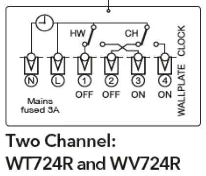

marshian Posted October 24, 2024 Author Posted October 24, 2024 Well time to round this out (Not quite there but damn close) No mater what I did with the Wiser Hub (controller) - All Off, HW On, HW Off, CH On, CH Off or Both CH and HW On the wire from the wiser unit to the wiring centre to trigger the HW was live all the time. I was completely confused by this as it shouldn't be live unless the timer is calling for HW but I checked the wiring instructions and it was all wired correctly 3 for HW and 4 for CH I swapped to a different (spare wire) - same result 240V all the time unless the power to everything was killed The CH wire is only live when the timer and the room stat is calling for heat Every time I check wiring in the wiring centre or remove the Wiser Hub I switch off the power to it all at the Fused Spur that feeds it all I don't know why I did what I did next but I took the Wiser hub off the universal back plate without powering down and I heard an audible click and I stopped - a penny (very large one dropped) - selecting CH or HW had always made an audible click but since the boiler install and change of wiring that had been missing for HW the light comes on but no audible click. I switched off the fused spur - re-attached the Wiser hub and if I selected HW I got a audible click, CH again I got an audible click Going up to the wiring centre with nothing selected on the hub I had no power to either HW or CH signal wires Selecting HW gave me 240 volts and same with CH with nothing selected I got no Volts on either HW or CH My only thought is that somehow the relay or contactor for HW had stuck closed and even powering down the unit was not causing it it open. Anyway everything now works and just need the gas engineer to confirm with Viessmann that a switched live back to the boiler is needed (I'm damn sure it is but I'm not about to fit that) I actually need to think about how the boiler gets that in summer or if heating water outside of the CH period because I can't have both CH and HW linked to the same switched live signal to the boiler or CH will drive HW I might have to either A. think about a relay solution or B. think about a switch (Summer / Winter setting) I can only have one SL wire at the boiler so for Summer the SL comes from the HW side but for winter when I only heat water during the CH timed period it can come from the CH side.

marshian Posted October 31, 2024 Author Posted October 31, 2024 In other news Gas Engineer has had it confirmed from Viessmann that boiler (in current configuration) needs a switched live from the programmer to the boiler - at bloody last!!!
