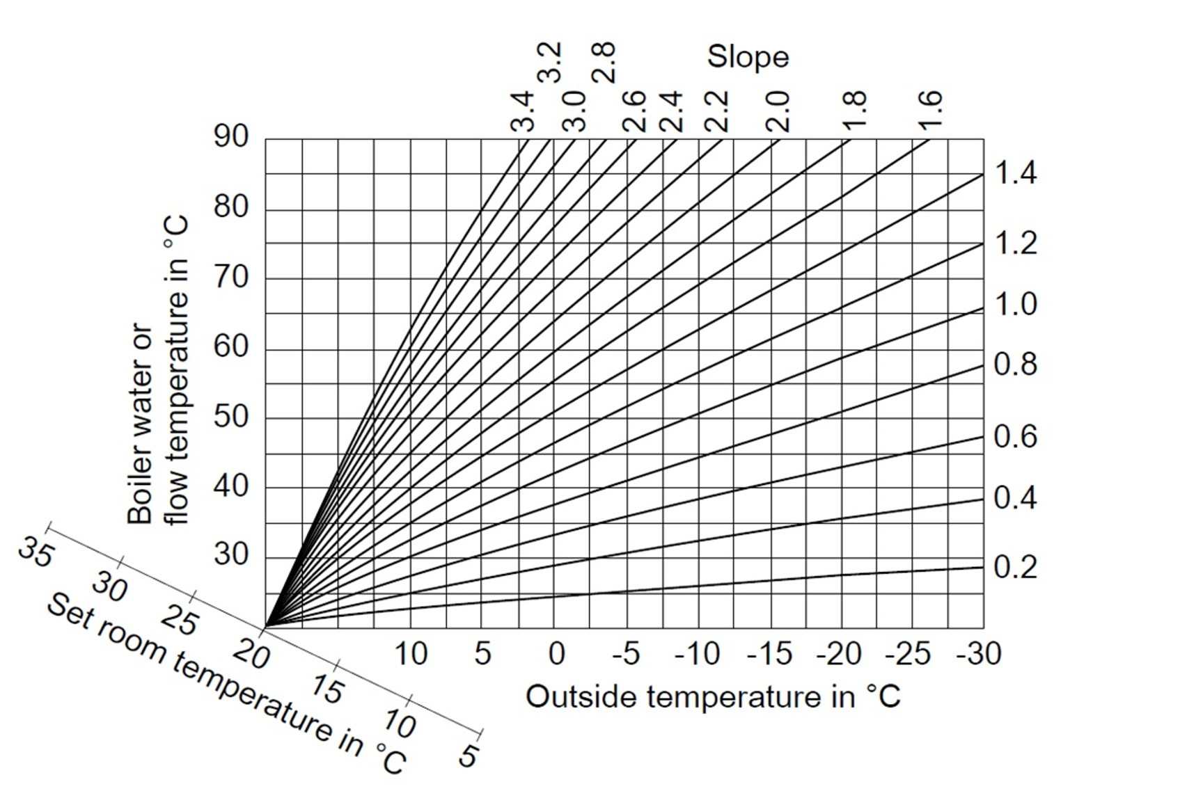

Posted
1 hour ago, Lofty718 said:
I run a curve of 0.25 for rads and 0.2 for UFH, over 1 is very high
I've just looked at the curves for the boiler at 0.2 slope Outside temps and boiler flow temps is in the table below
Outside / Flow temp
20 - 20
15 - 22
10 - 23
5  - 24
0  - 25
-5 - 26
Mighty impressive - I'd have to rebuild the house to achieve that - I think I'll be doing really well to get down to 1.0 :D
Posted
7 hours ago, Lofty718 said:
The curves on Viessmann must be different, my flow temps are a fair bit higher than that. Always between 26-40
Viessmann curves below

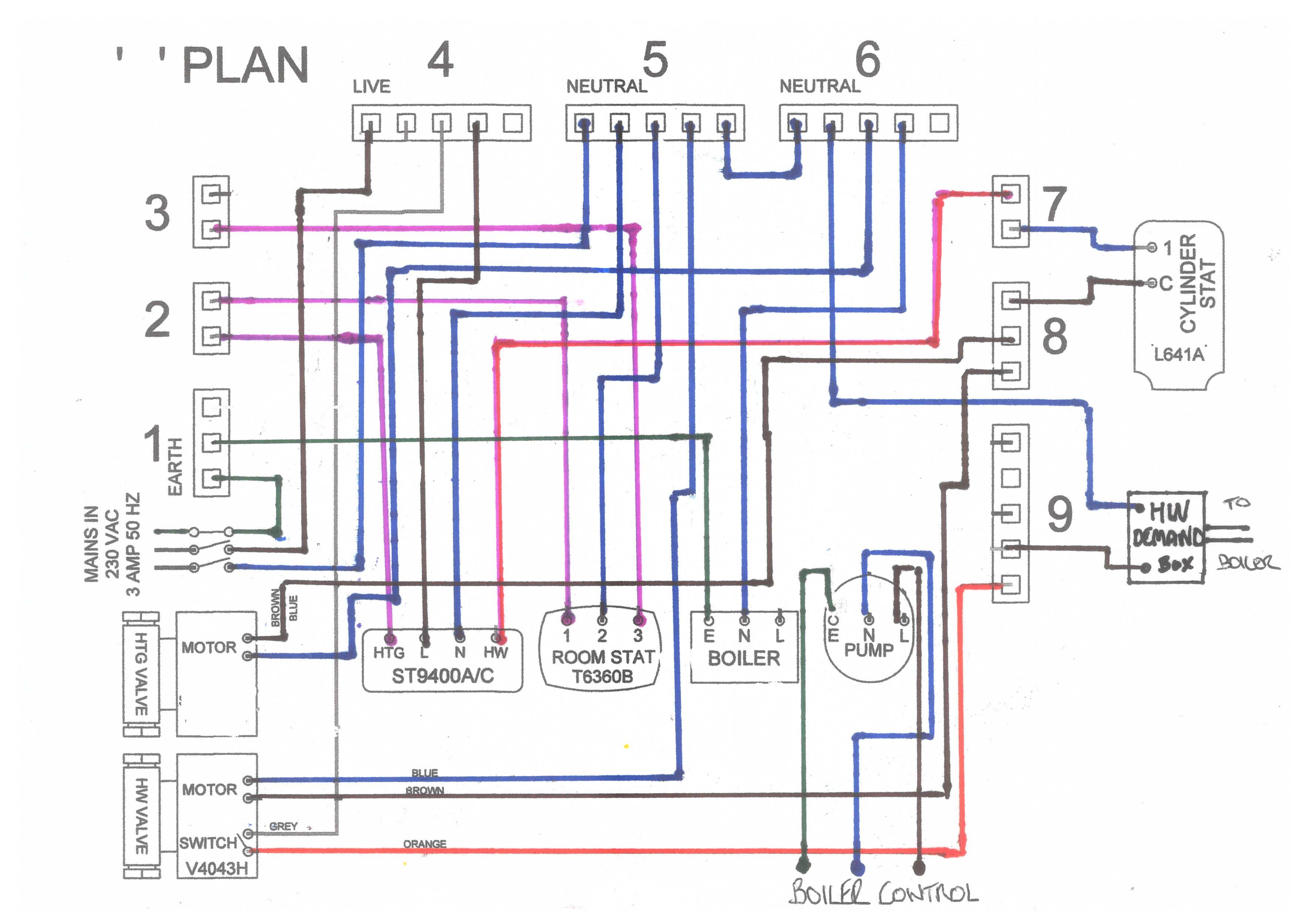

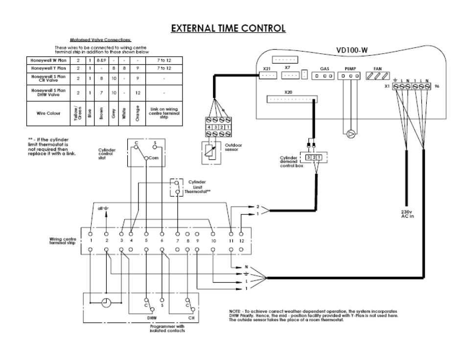

Right I'm resigned to sorting out the control side of the boiler myself
HW demand is now working fine - ramps up temp and modulation and tops up a tank of water to 55 deg in 15 mins so no issues there
The problems I have are
I can't find a wiring diagram where a NO valve is used for CH and a NC valve is used for HW
Often X plans are on boilers where HW/CH selection is done with 2 switched lives
Closest I can find is
However whilst it gives some valve wiring options it doesn't cover the X plan set up
I don’t have an NTC sensor (Shown as Cylinder limit Thermostat) so ignore that
The HW tank supply has the 2 port Normally Closed valve
NC Valve has 5 Wires Live (Brown), Neutral (Blue), Earth (Yellow/Green), Grey (Live feed for the internal Switch) and Orange (240V output when valve is fully open)
The CH supply feed has a 2 Port Normally Open Valve
NO valve has 3 Wires Live Brown), Neutral (Blue) and Earth (Yellow/Green)
I've set that side up so when the Cyl Stat calls for heat the brown “Live” powers up the Normally Closed Valve to Open (the grey wire has permanent power but it only goes to an internal switch that makes when the valve is fully open and puts 240v to the Orange – the power from that goes to the Cylinder demand box to tell the boiler it it’s doing HW – it ramps up to 80 deg C and modulates as high as it can based on return temps to heat the HW cylinder (coil) to the target stat temp in the shortest time possible
The same signal Live also powers the Brown for the Normally Open Zone valve for heating so it closes stopping elevated temp HW going round the CH circuit
As soon as the tank stat is satisfied the live circuit to the zone valve is removed, the HW zone valve closes, the CH zone valve opens – the Live feed to the HW demand box is removed and the boiler reverts to weather compensated flow temps
The only other issue on the HW side is if the HW tank stat picks up a significant drop in temp (the hysteresis is quite broad) then without anything being on the HW valve will open and the CH valve will close and the pump will start so I think I have a wiring issue in either wiring centre, Heating controller or very possibly Boiler.

This may be of some help?.
HW Priority Diagram.pdf
  • Thanks 1
Posted
Indeed it is - thank you sir
One issue I see is that it uses a relay arrangement which I'm trying to avoid as I think it's not needed with a NO CH valve and a NC HW valve
That diagram uses 2 NC Valves for CH and HW (hence the linking of the two oranges to energise boiler and pump)
But It gives me a start that is slightly easier for me to get my head round than the Viessmann diagram (which I find really complicated)

In an arrangement where you have NC and NO valves the NC HW valve controls the NO CH valve. You just connect the orange of the NC valve to the brown of the NO valve.

Layout
Posted
I need a feed to go to the HW Demand box
Putting Brown to Brown works and keeps the HW demand part simple
CH in normal operation the NO valve is consuming no power and idle
When HW is demanded - NC HW Valve and NO CH Valve share the Brown so both effectively energise
CH Closes from Open
HW Opens from closed
Why wouldn't that be OK?
Posted
43 minutes ago, marshian said:
It is a good video
But "Ideal Vogue" use 2 switched lives
If you watch through the video he describes how to convert an s plan to PDHW with a NO valve.
Posted
CH Closes from Open
Use the switched live orange from the NC valve to apply power to the NO valves live connection. Then when there is a call for HW the NC HW valve will apply live to the NO CH valve thus closing it.
