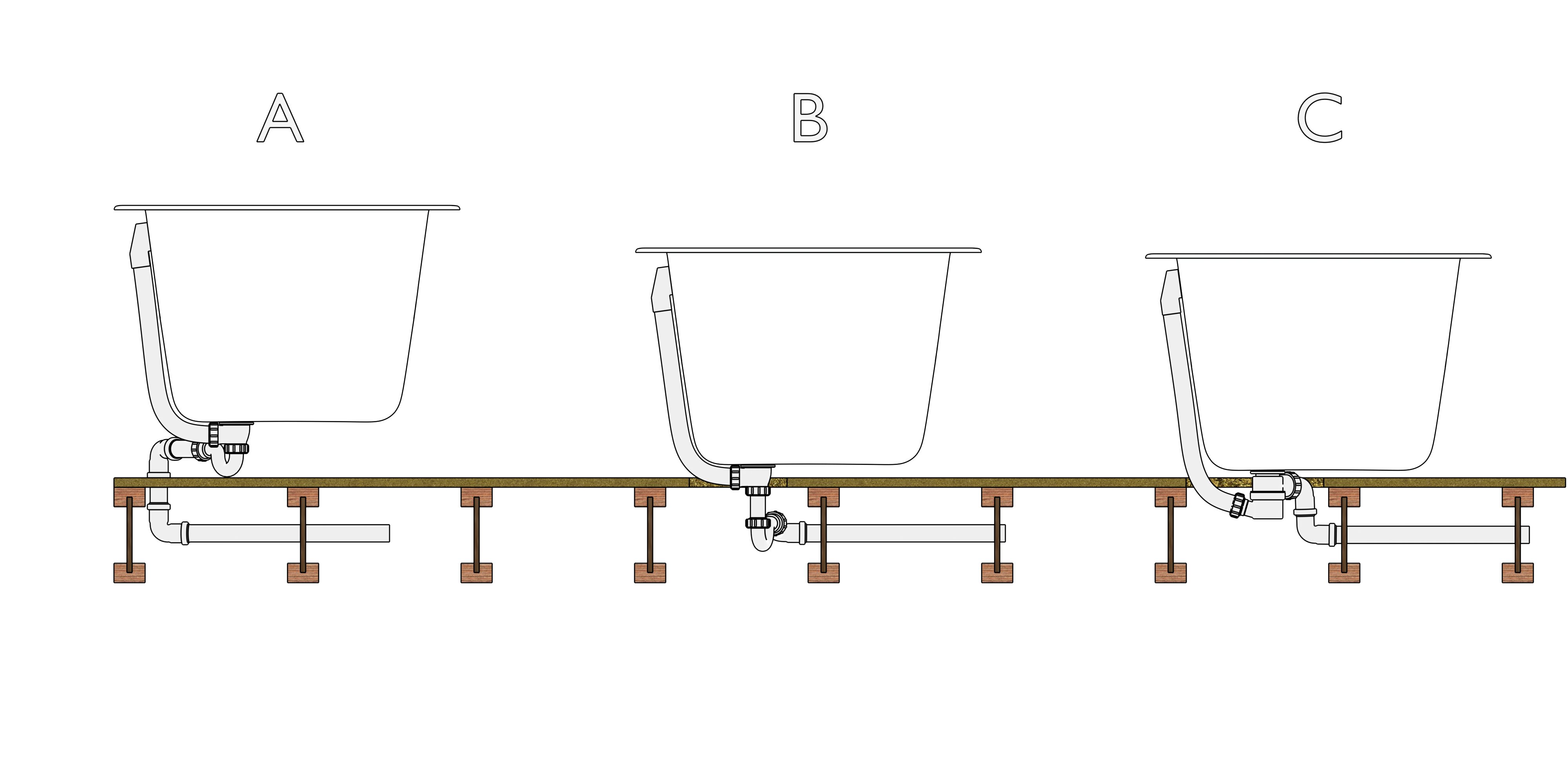

peteypops Posted Wednesday at 13:00 Share Posted Wednesday at 13:00 I'm designing the bathrooms for our new build and the bath we've picked is quite tall. The plumber will be providing the supply and waste to the point of access for me to fit the bathrooms to, so I want to get all the positioning right. The baths we want are quite deep, (image A), so I'm looking to minimize the height they sit at. My first thought was to simply cut a hole in the floor and lower the p-trap into it (image B). I don;t like the idea of the p-trap being inaccessible without removing the bath. So an alternative is McAlpine do a top access bath waste which would allow a low arrangement (image C) while still having access to the trap from above. Does anyone have any thoughts on this? Cheers Pete Link to comment Share on other sites More sharing options...
Onoff Posted Wednesday at 13:12 Share Posted Wednesday at 13:12 Solvent weld whatever you can where it's inaccessible. 1 Link to comment Share on other sites More sharing options...

peteypops Posted Thursday at 12:11 Author Share Posted Thursday at 12:11 22 hours ago, Onoff said: Solvent weld whatever you can where it's inaccessible. Thanks, totally agree. The drawing was push fit cos that's the models I had, but this is a good point. Link to comment Share on other sites More sharing options...
Temp Posted Thursday at 12:20 Share Posted Thursday at 12:20 We have two top access shower traps. They work great for us. I think building regs require a minimum depth of water seal in them and some shower traps on the market are a bit less. Not sure if this is an issue for bath traps as well. Link to comment Share on other sites More sharing options...
ProDave Posted Thursday at 12:24 Share Posted Thursday at 12:24 I did similar. Mcalpine top access trap with a click clack waste fitting. Our bath sits in an enclosure so I did not want the common, but horrible waste that pops up when you turn the overflow fitting, too much inaccessible stuff to go wrong. Our bath is above the utility room, so worst case in the case of something going wrong we could cut an access trap in the utility room ceiling. Link to comment Share on other sites More sharing options...
peteypops Posted Friday at 09:51 Author Share Posted Friday at 09:51 Thanks all. I'm definitely leaning towards option C. The limiting factor will be I don't know exactly where the joists will be underneath yet but I have the option of rotating the bath 180° to offset the other way so I think I'm covered. Link to comment Share on other sites More sharing options...
