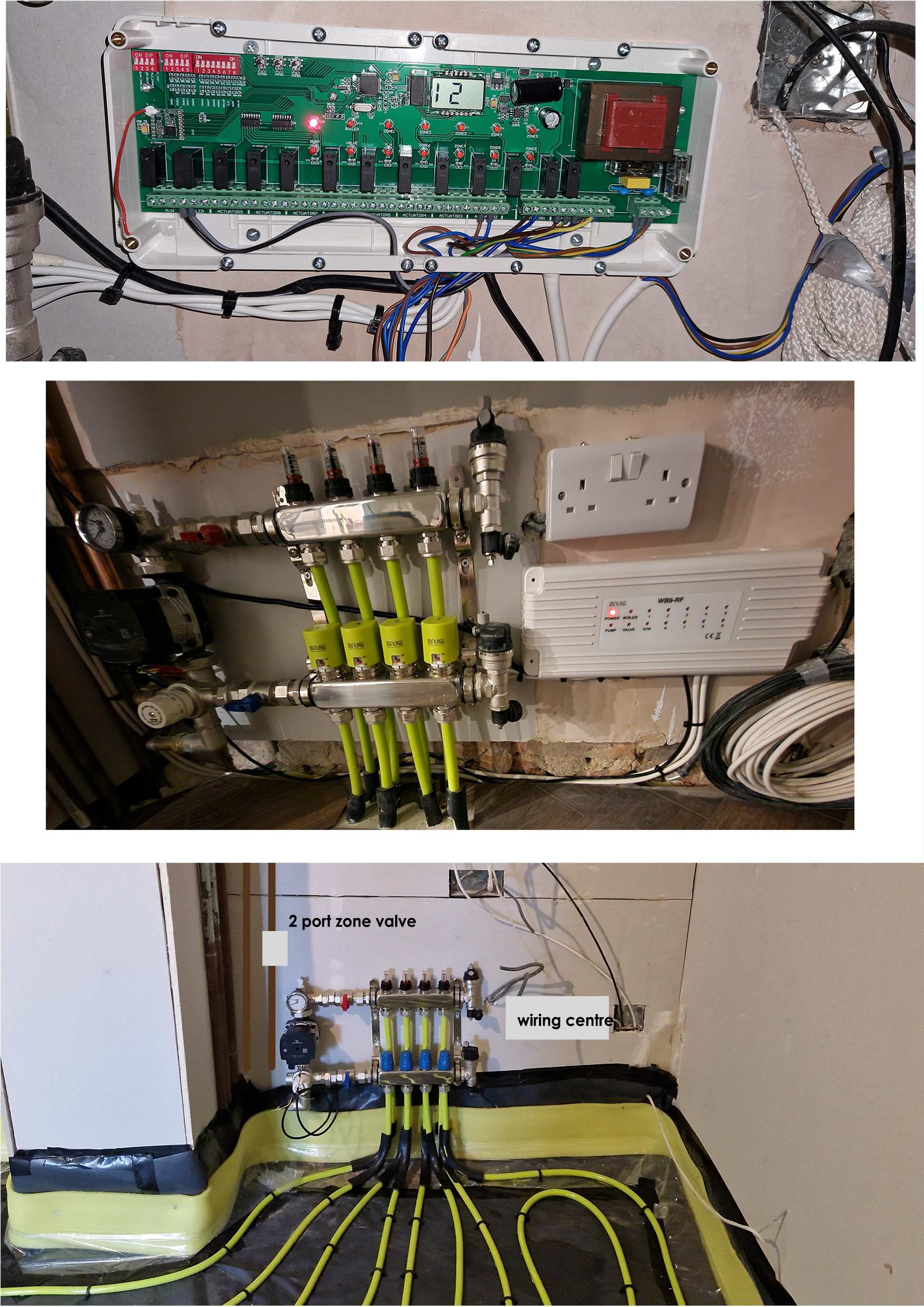

Burkle Posted September 16, 2024 Posted September 16, 2024 Apologies if this is posted in the wrong section - there is a bit of a crossover between plumbing / UFH / boilers / radiators / electrical. We have a combi boiler, with radiators, which runs from a hive stat. We had underfloor heating installed to the ground floor (manifold, pump, valve etc all on the ground floor) which runs off the same boiler, which has its own wiring centre and stats on RF signal to said wiring centre - so both can run together or on their own, and when it works it is great. My issue, which hopefully somebody might be able to advise on, is that the UFH heating every so often stops working to the schedule... its as though the wiring centre doesn't receive the signal from the stats. At first i thought this might be the RF signal, but i have tried this with the stats within a couple of metres of the wiring centre, and get the same issue (the room is a big open plan space, around 10m long x 6m wide, with 2 stats and the wiring centre in the same room). Even if i reset the stats or use the boost feature on them, it doesn't fire up the boiler through the wiring centre. There is power to the wiring centre (light is on to confirm this too), and the boiler, pump and relevant zones can be fired up using the test switches in the wiring centre (this is why i thought it might be something to do with the RF signal). But, the only way i can find to get it working again properly is to turn off the power to everything (via the fused spur to the boiler and everything attached), and turn it back on then everything works fine again... well, for so long anyway. As an example, the boiler was power was turned off / on again on friday evening, and everything has worked ok on the schedule until this morning (Monday) when the UFH did not come on as scheduled. Sometimes this might be less than a day, sometimes over a week, before the UFH stops working through the stats again. The radiators still work fine connected to the hive direct to the boiler (there is also a zone valve on this which works no problem to allow the radiators and UFH to work individually). The system is snugstat, with the RF stats, and the WB9-RF wiring centre. I have spoken to the manufacturer about the issues, and have replaced the wiring centre once, and the stats have been replaced twice, but still have the issue. An electrician installed everything with the plumber, and a separate electrician has checked all the wiring and cant find any issues either. Does anybody have any thoughts on why this might be happening? and what i can do to solve the issue? I have been pondering over getting hive stats to connect up to the wiring centre as we have never had an issue with the hive for the radiators, but don't want to spend the money on this yet in case it is something to do with the wiring centre and the way this all works. Any help, advice or general thoughts and comments on the issue would be much appreciated.
ProDave Posted September 16, 2024 Posted September 16, 2024 Post some pictures of your wiring centre and the UFH manifold and in particular did they install any 2 or 3 port motorised valves when fitting the system?

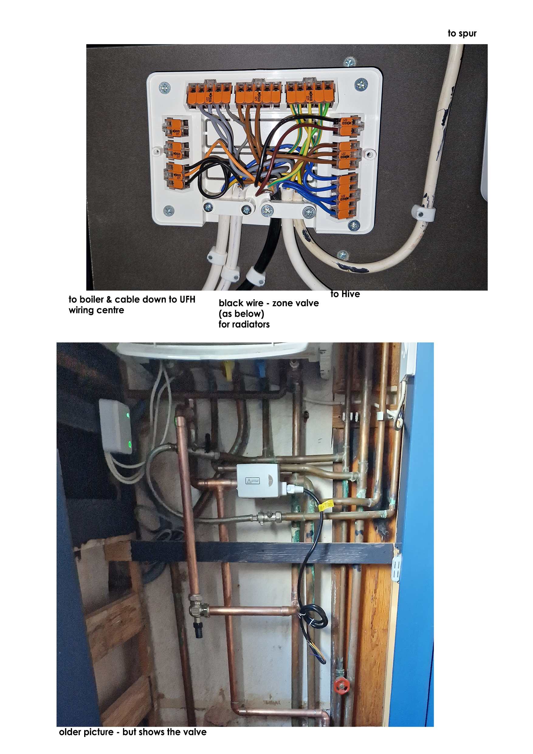

Burkle Posted September 16, 2024 Author Posted September 16, 2024 Hi ProDave, thanks for the response - I dont have any new pictures to hand, but have posted a couple of files of which show previous photos i have. One shows the area of the manifold, the other shows the area of the boiler and the wiring box which links everything up. There are 2 2 port valves (one off the pipework under the boiler for the radiator system, the other to the left side of the manifold for the UFH connected to the wiring centre). As i say, when its working it works absolutely fine, i just cannot figure out why the UFH aspect stops working with the stats intermittently. whens its on and working it will fire up and turn off absolutely fine, its just when at some point its like it has a total loss of connection between the stats and the wiring centre, and the only way to resolve it is to cut the power to the wiring centre and turn it back on. Just to add too, it makes no difference if i turn off the stats (and even factory reset and reconfigure) to try and get them to function the controls through the wiring centre again.
ProDave Posted September 16, 2024 Posted September 16, 2024 First thing to check is on your WB9-RF when a zone calls for heat is the LED on the controller for that zone light up? If not the problem lies with the TF thermostat for that zone. If the LED is light up, the RF thermostat is working, next check is the manifold pump running? Is the 2 port valve for the UFH energised? Report back.
Burkle Posted September 16, 2024 Author Posted September 16, 2024 Thanks again for the response, from past experience (and trying to figure this out) On the WB9-RF when the zone calls for heat (either from the schedule, or manual call or "boost") the relevant zone lights up fine. The "power" LED is always on (unless power it switched off at the fused spur) If any of the zones (we only utilise 2 zones on here) call for heat (when the system works) then the zone LED, along with the "boiler", "pump" and "valve" LED's all light up together to confirm everything is working. There is power running to all when required. The issue is more that it seems to be that the RF signal from the stats just stops communicating for no apparent reason and so there will be no heat. In this instance the only LED which will light up on the wiring centre is the "power" as this is always on to confirm power running to the unit. Its the call from the stat to tell the unit to power everything else up. The thing i cannot figure out with it is that it just stops works, there doesnt seem to be any pattern to this, and sometimes it will work for days, others it will be much shorter. The stats themselves are still "working" (e.g set the temp higher to see a flame on the screen suggesting a call for heat), and even if i turn the stat off, reset to factory settings (ensuring the receiver settings all match the wiring centre still) then it still doesnt trigger the zone on the WB9-RF. It will only start to work again (even if the stats are halfway through a heat schedule too) once the power to the WB9-RF has been turned off at the switch and back on (and it has to be for sufficient enough time to ensure power has been stopped - say 20-30 seconds).

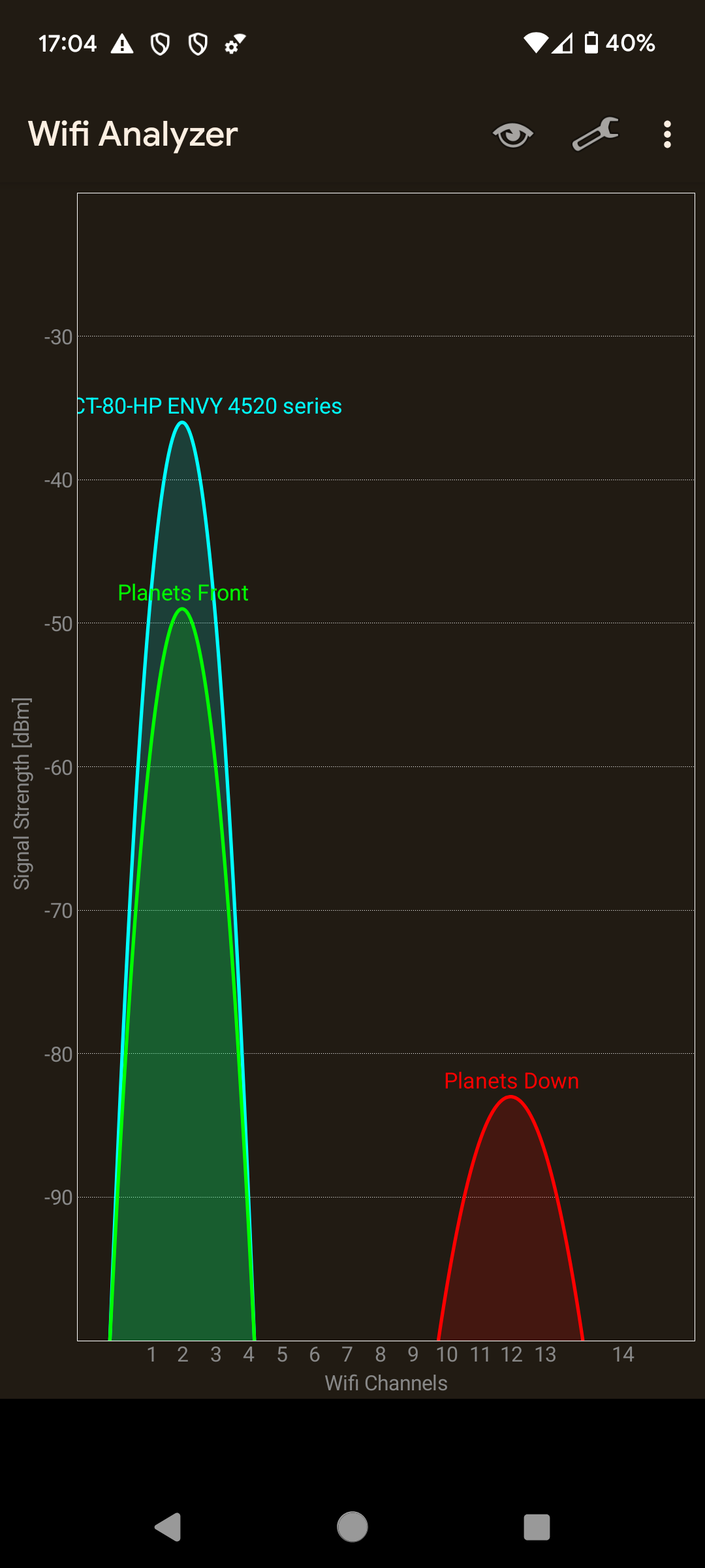

Temp Posted September 17, 2024 Posted September 17, 2024 I would download a free WiFi Analyzer app from the playstore for your phone. The one I have will give you a graph of the channels being used. See if there are two on same channel or very close. Might need to move your WiFi to a different channel. This is the one I'm using and it currently shows my printer is clashing with one of my wireless APs both on Channel 2.

Burkle Posted September 24, 2024 Author Posted September 24, 2024 a bit of an update - system has been working fine generally coming on and turning off (if needed depending on temperature) since putting everything onto a single stat.... until this morning! Heating did not initiate on the wiring centre, but shows as being turned on on the stat (flame symbol). I downloaded a wifi analyser and have checked this to see if any signals are conflicting, but i've never seen anything on the app which looks like it could be that stat signal (only wifi internet services around the area). I am going to try the stats on a different channel to see if this makes any difference too, and will try and change this without powering down the system first to see if it switches over. I will keep you updated
