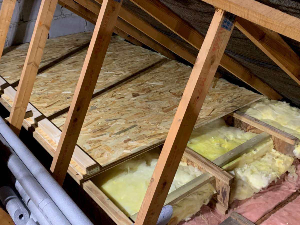

Posted
So first section completed
Yes I know the edge closest to the roof tiles and felt isn't supported - it's just acting as a dust/condensation cover for the insulation

Anyway - I'm pleased to say last night I completed phase one - 1/3 of the accessible area is fully insulated and boarded - I can already see the difference in the ceiling temps of the rooms below (with an IR thermometer - only 2/3rds of the rooms below are covered by the improved insulation right now)

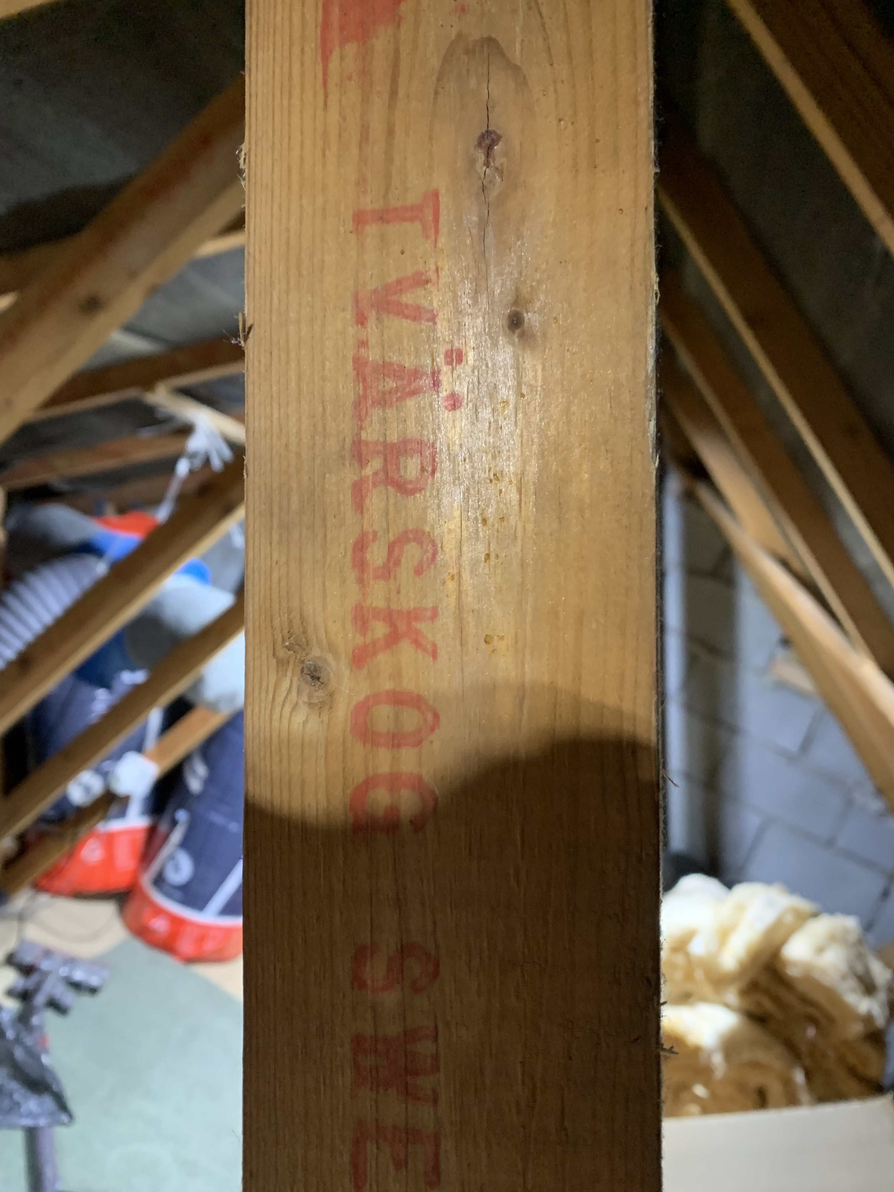

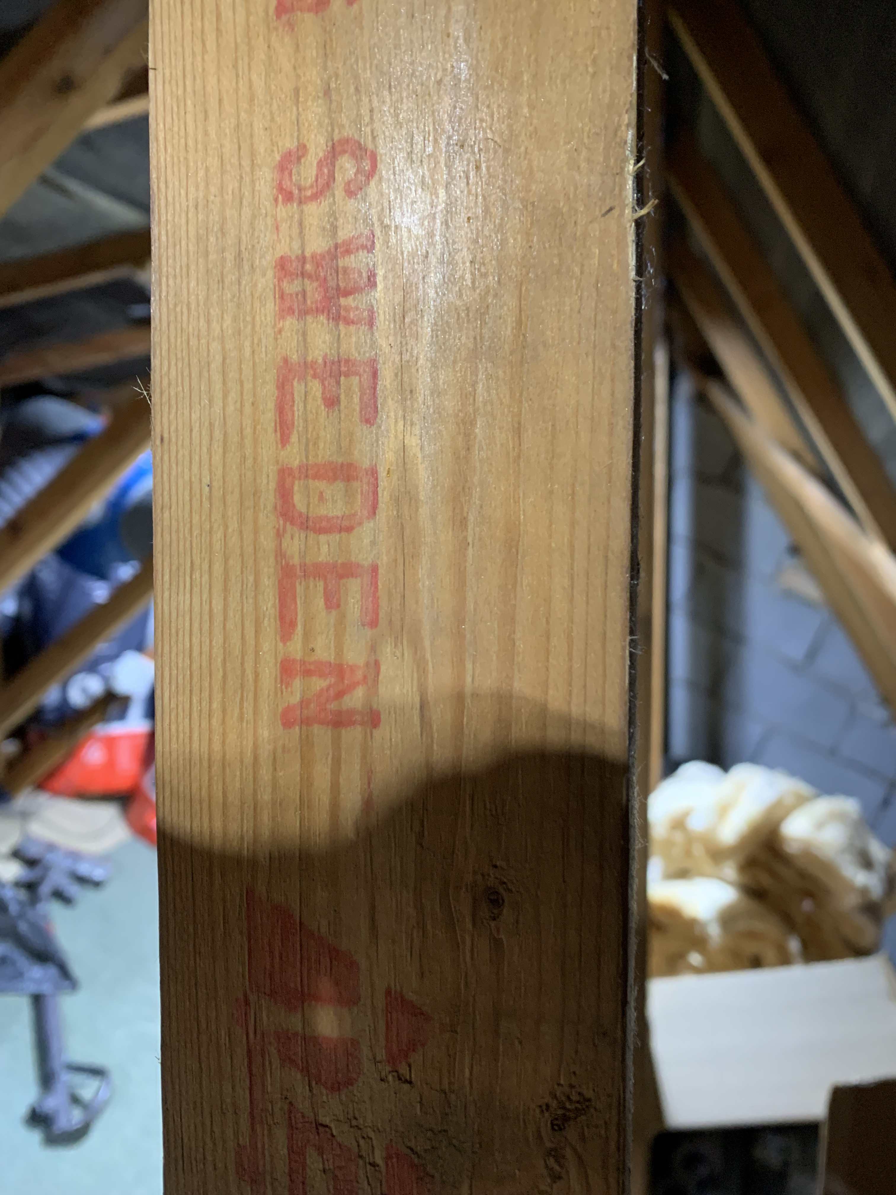

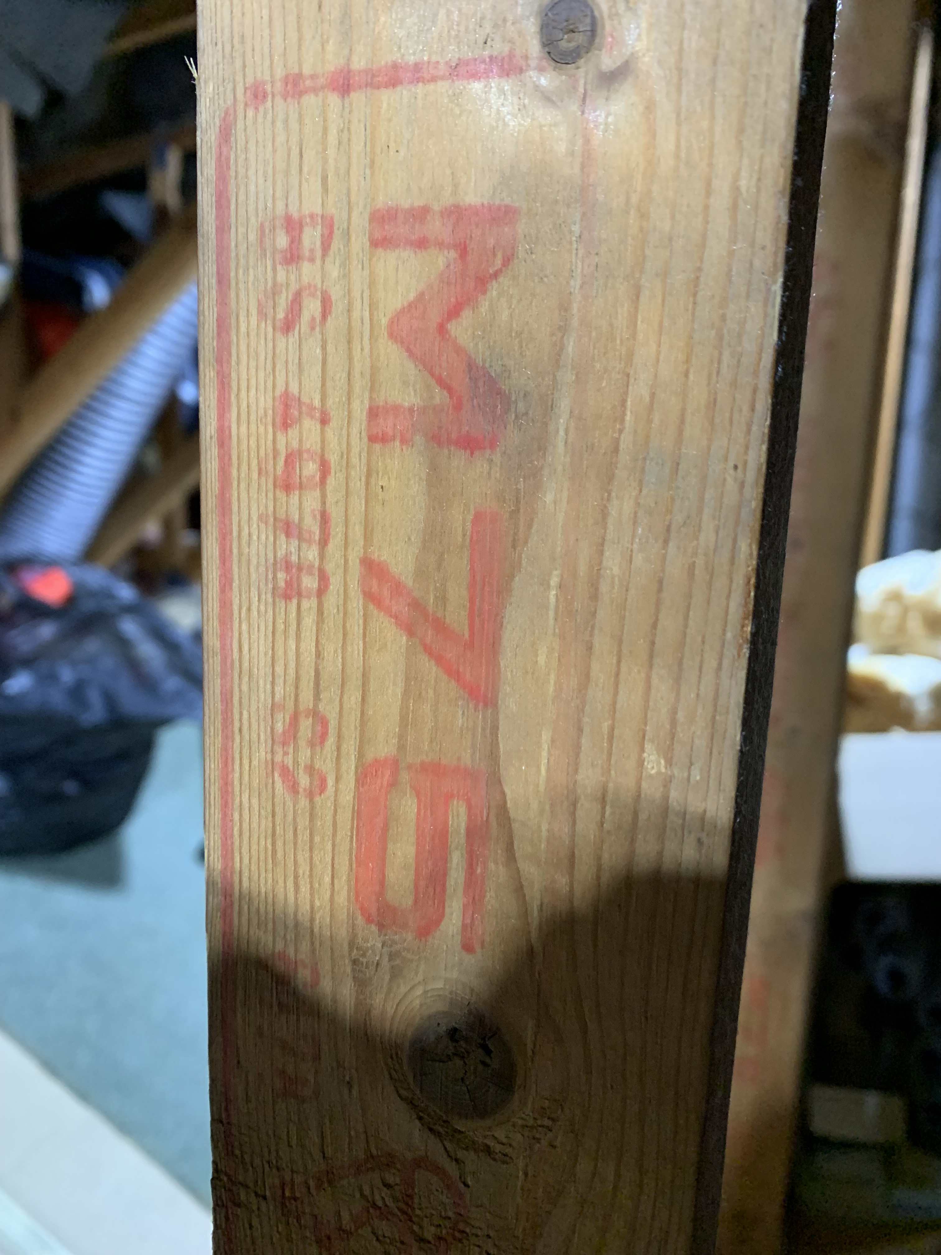

Posted
On 05/02/2025 at 00:29, marshian said:
They (trusses) are actualy marked up with manufacturer (swedish I think) and a BS std - I think from memory BS 5268 because the cold water storage tank is in the loft framed off the trusses - I need to check and note down the details
Took pictures so I don’t forget
BS 4978 - is what they are marked up as
Posted
Ahh google informs me that is the std for graded timber used in the trusses.
I'm pretty sure the Trusses would have been fabricated by local roofing company but they've been amalgamated into another company.

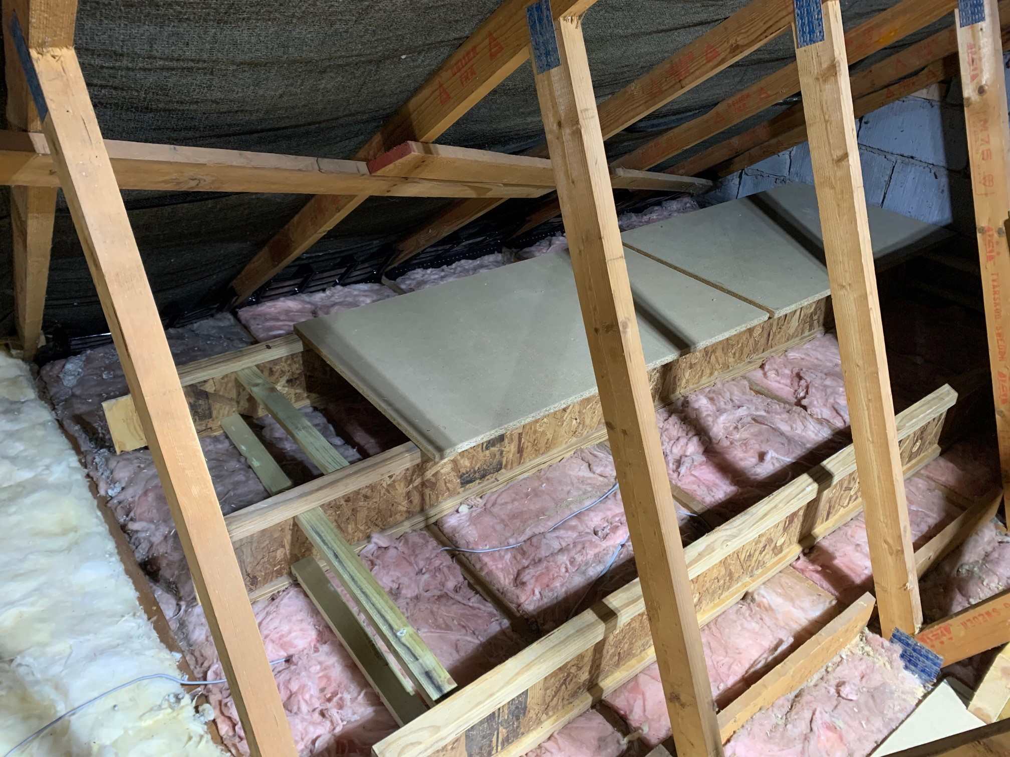

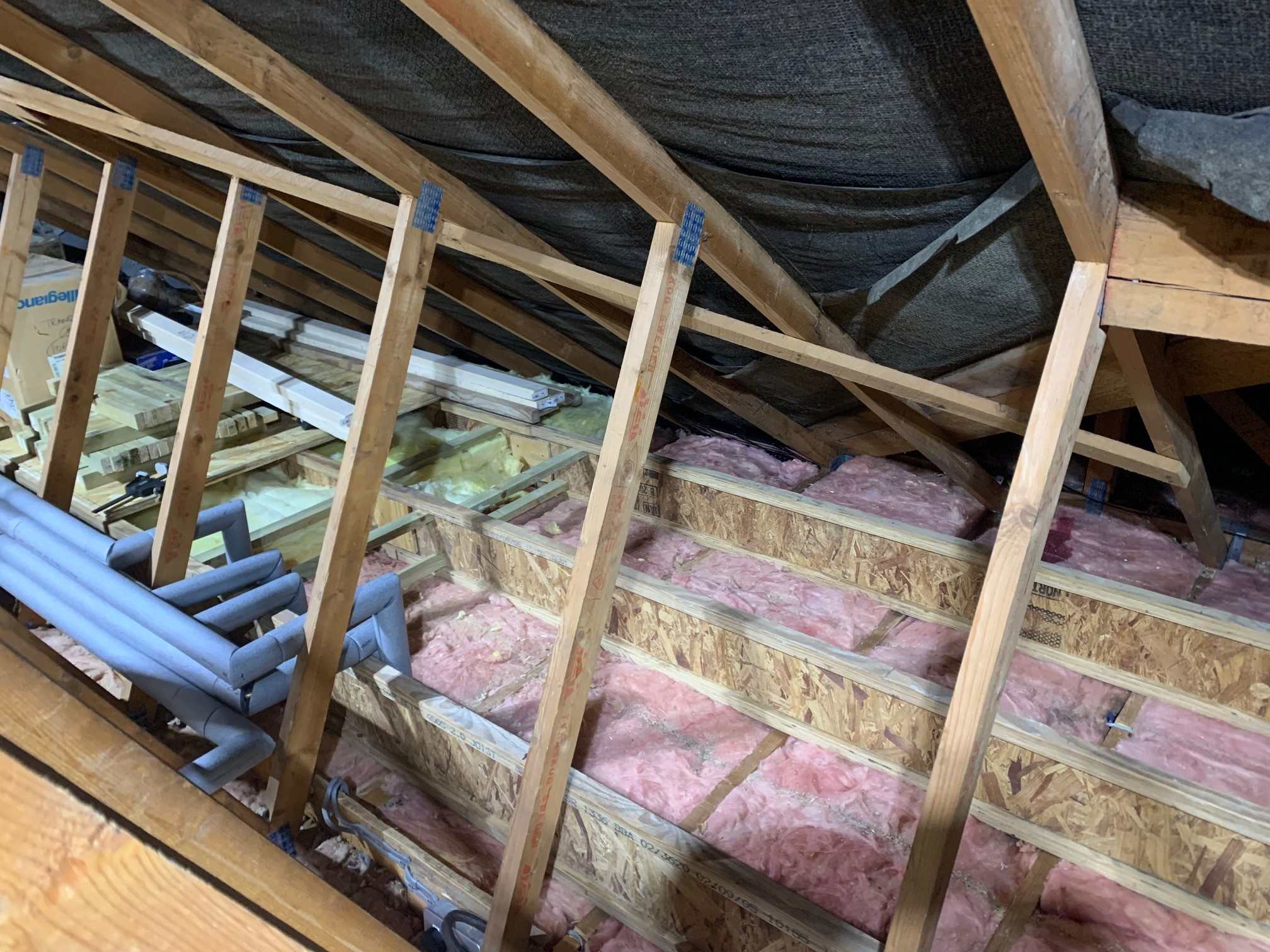

Posted

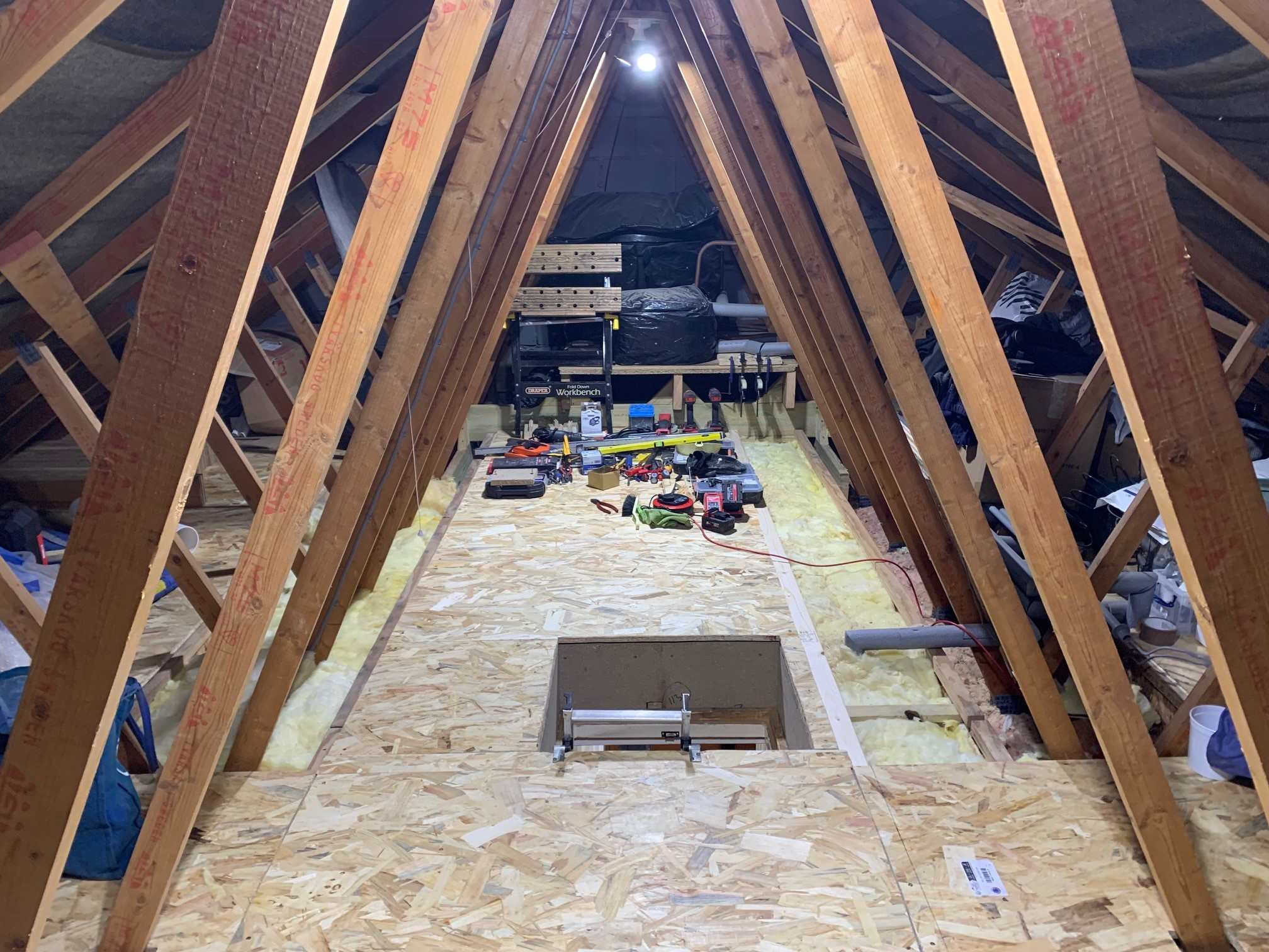

Phase I completed
So area covered = 1.5 m x 6.1 m - Yes I know it doesn't show insulation or boarding but it's all done
Now I'm on to Phase II (opposite side of the loft)
Boards are temporary just so I could lie down and roll out the insulation between the I-Beams
Next section requires me to lift the additional insulation I laid over the top of the layer between the trusses which will be a pain as it's all odds and sods

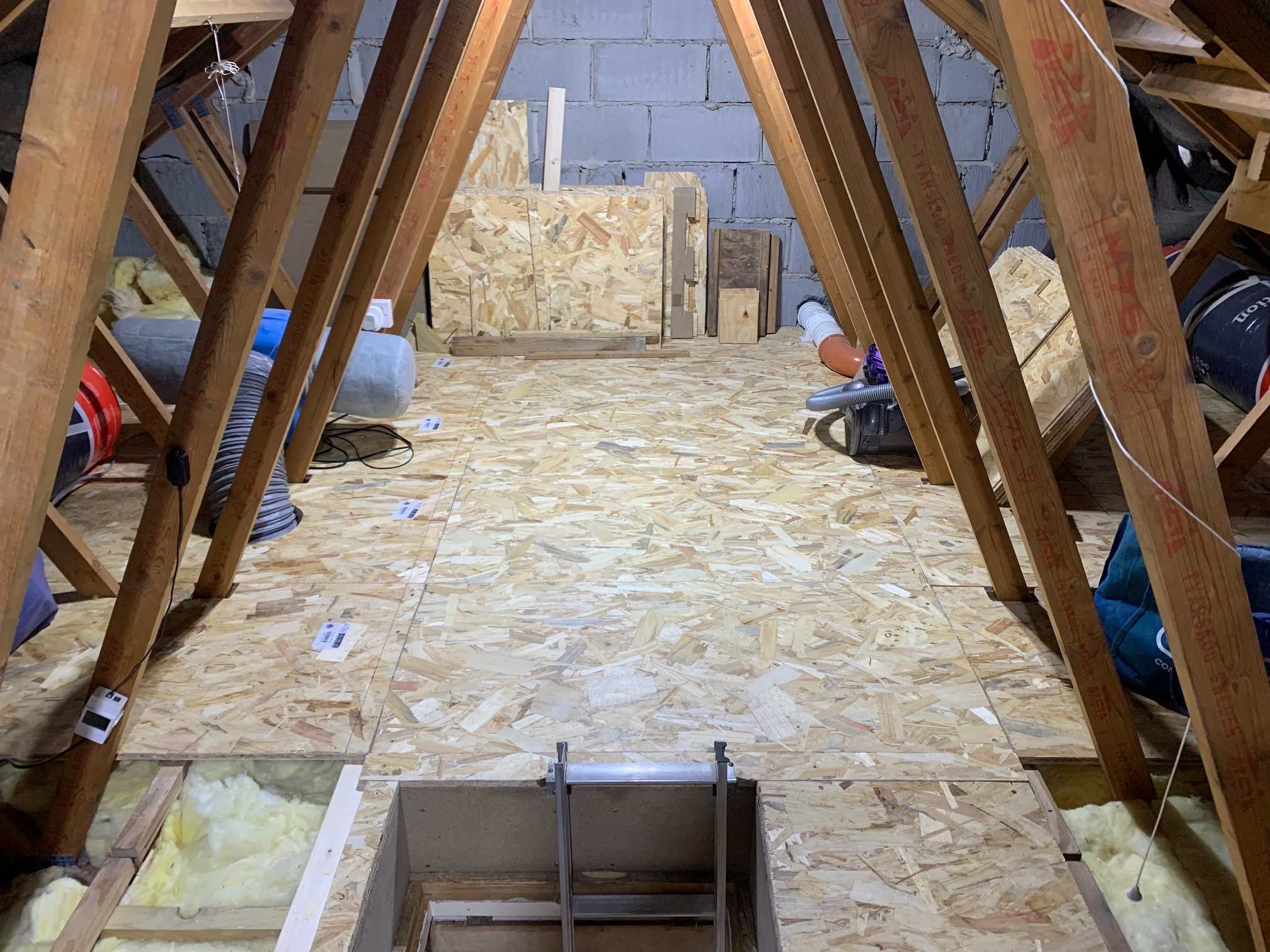

Posted
Still ticking along with this although the recent warm spell has made it a bit uncomfortable up there (it's currently nearly 5pm and my loft temp and humidity sensor is telling me it's 34.6 deg C and 32.5 %RH
One end from hatch to the gable wall is now fully finished
Other end with the water tanks in the distance I need to join the side section to the middle area
Also need to
1. Raise the lights up a smidge I keep clipping the with my head
2. Box in the shower extract fan
3. Insulate the loft hatch board and create a second trap door to increase the sealing
4. Re-do the pipework on Right that goes from Airing cupboard to the Cold Water store and F&E tank

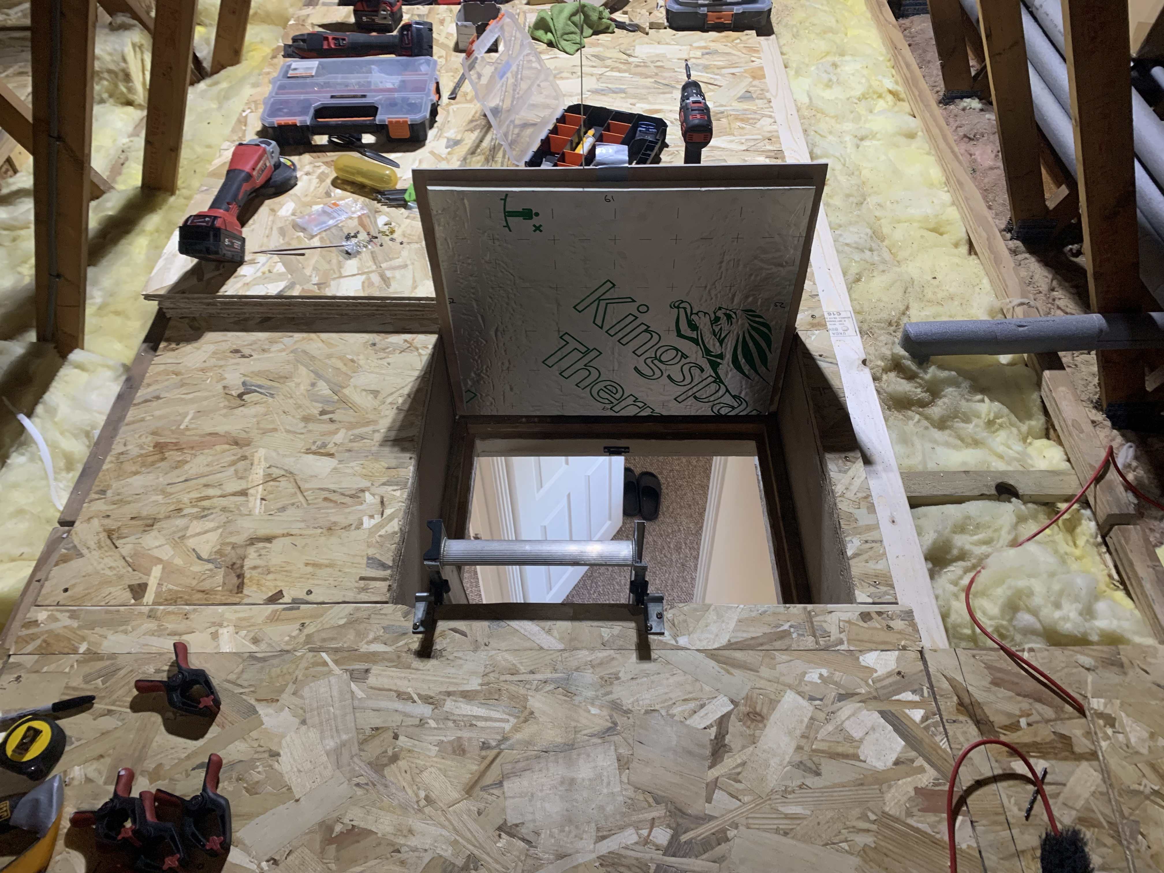

Posted

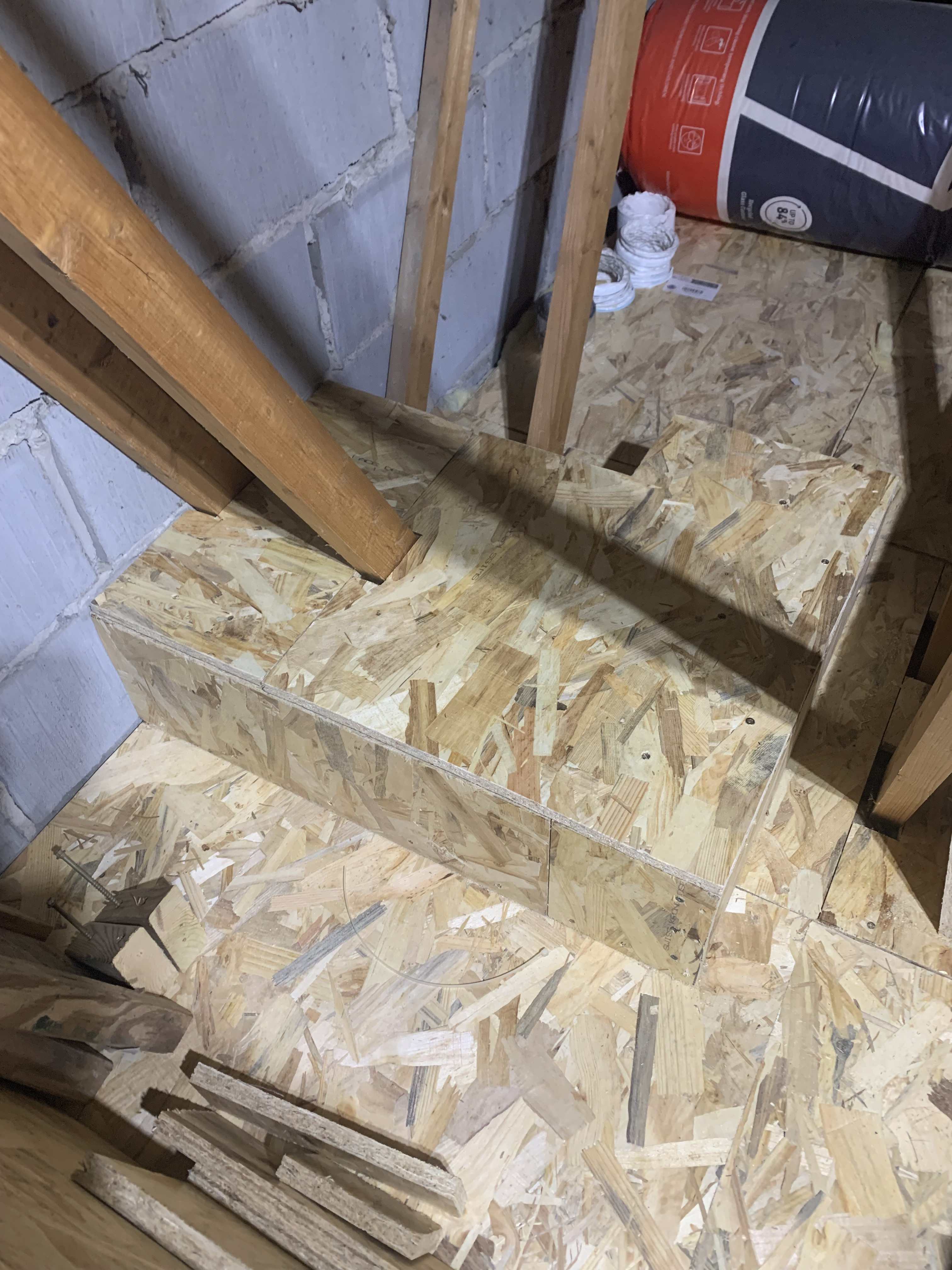

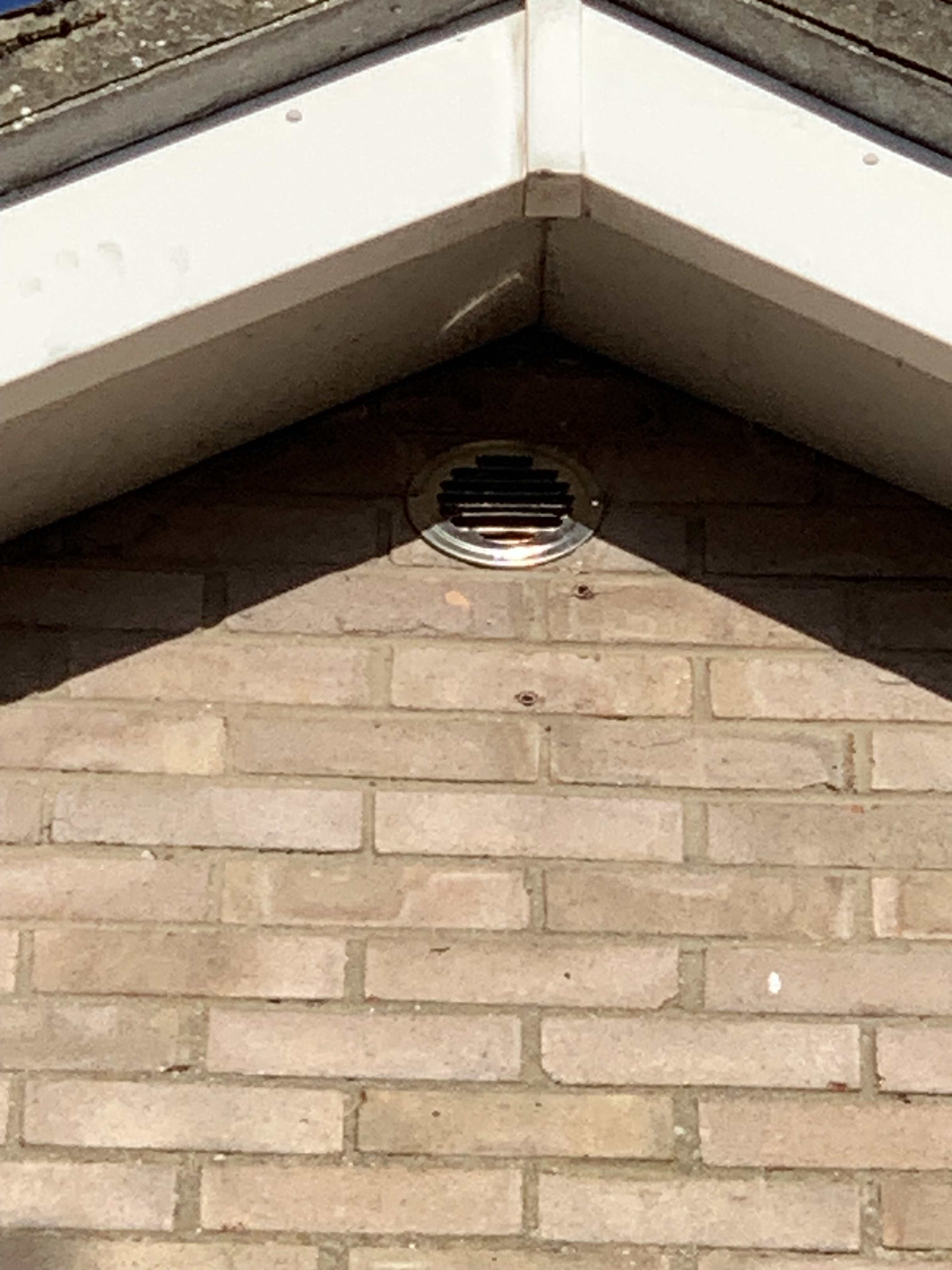

I’d started a couple of tasks yesterday but not completed
finished 2 & 3 this afternoon
Boxed in the bathroom extractor fan unit (and insulated around the pipework inside the box)
Lid is removable for maintenance or replacement but main purpose of boxing in was to use up some offcuts and insulate plus stop me tripping over the pipe

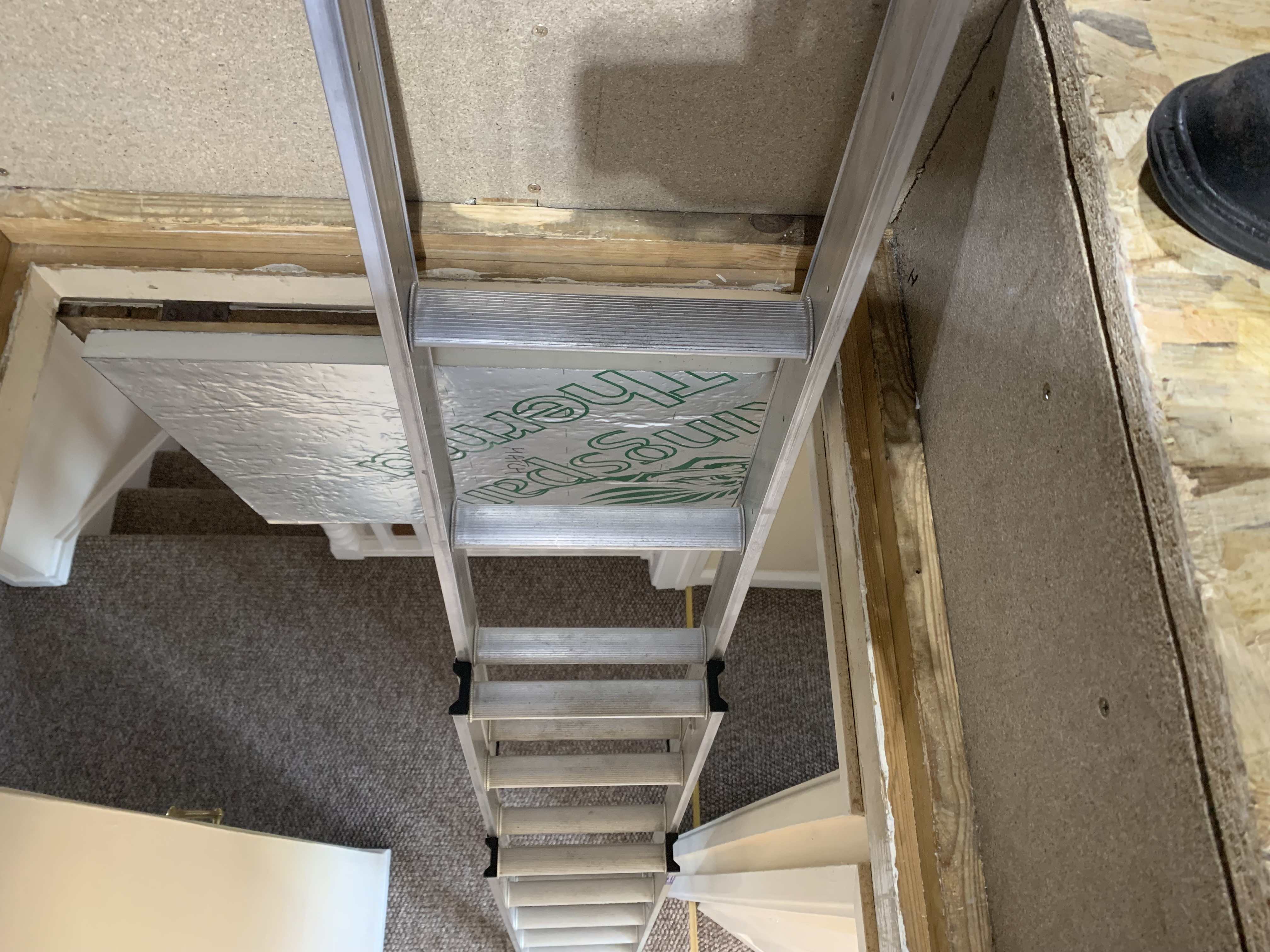

Loft hatch completed
This is the top hatch 25mm of celotex glued to a thin ply board
original loft hatch also lined with celotex 25mm to help seal up and also improve insulation properties of a badly fitting plywood hatch
It’s very noticable the impact on the PIV output, before with just the single plywood loft hatch when it was shut and the PIV was on you could feel the airflow escaping through the hatch into the loft
now with the new set up you can’t so the PIV will hopefully reach places it didn’t before
Damn it was hot up there when I started!!!! Hatch open and patio door open I’m getting a decent airflow to push out the hot air and it’s down to a much more comfortable 28 deg C
Posted
Finished all the boarded area now

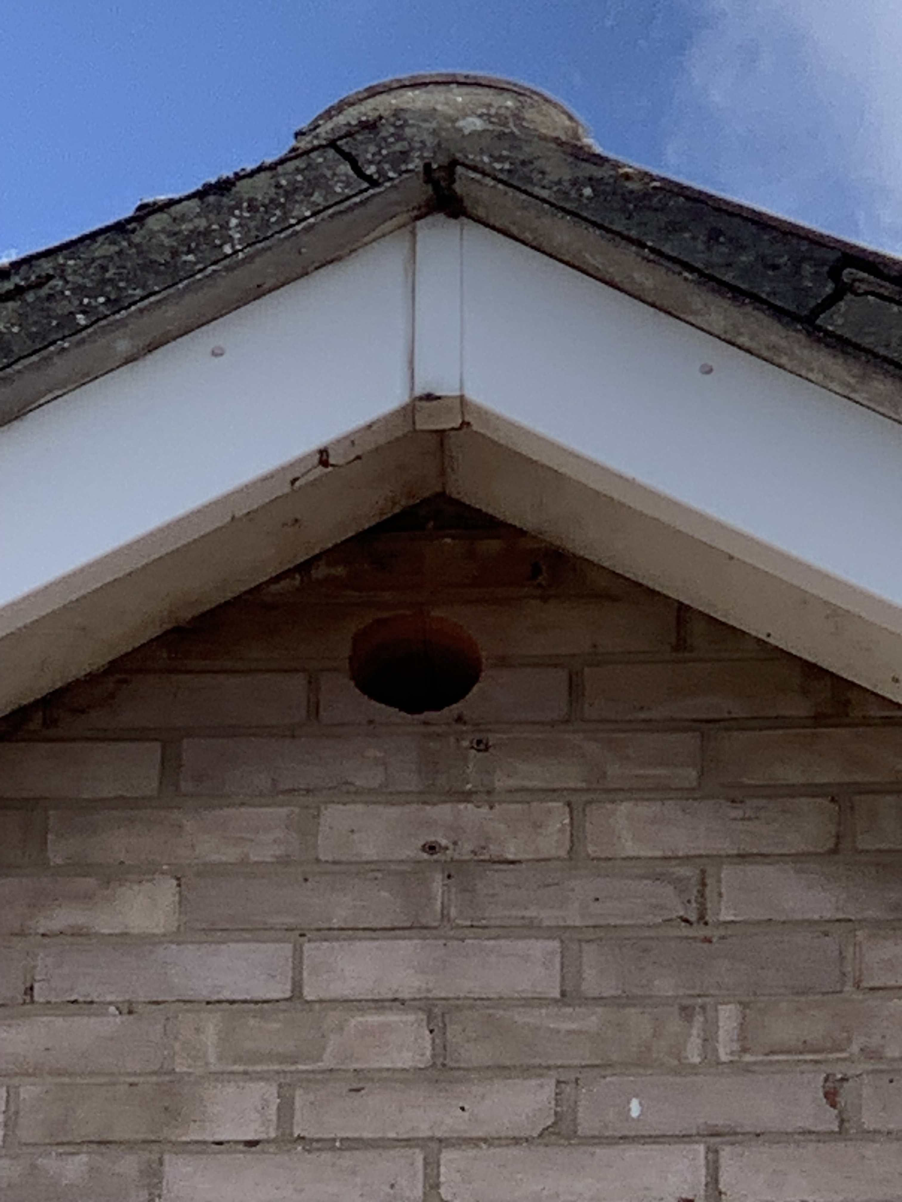

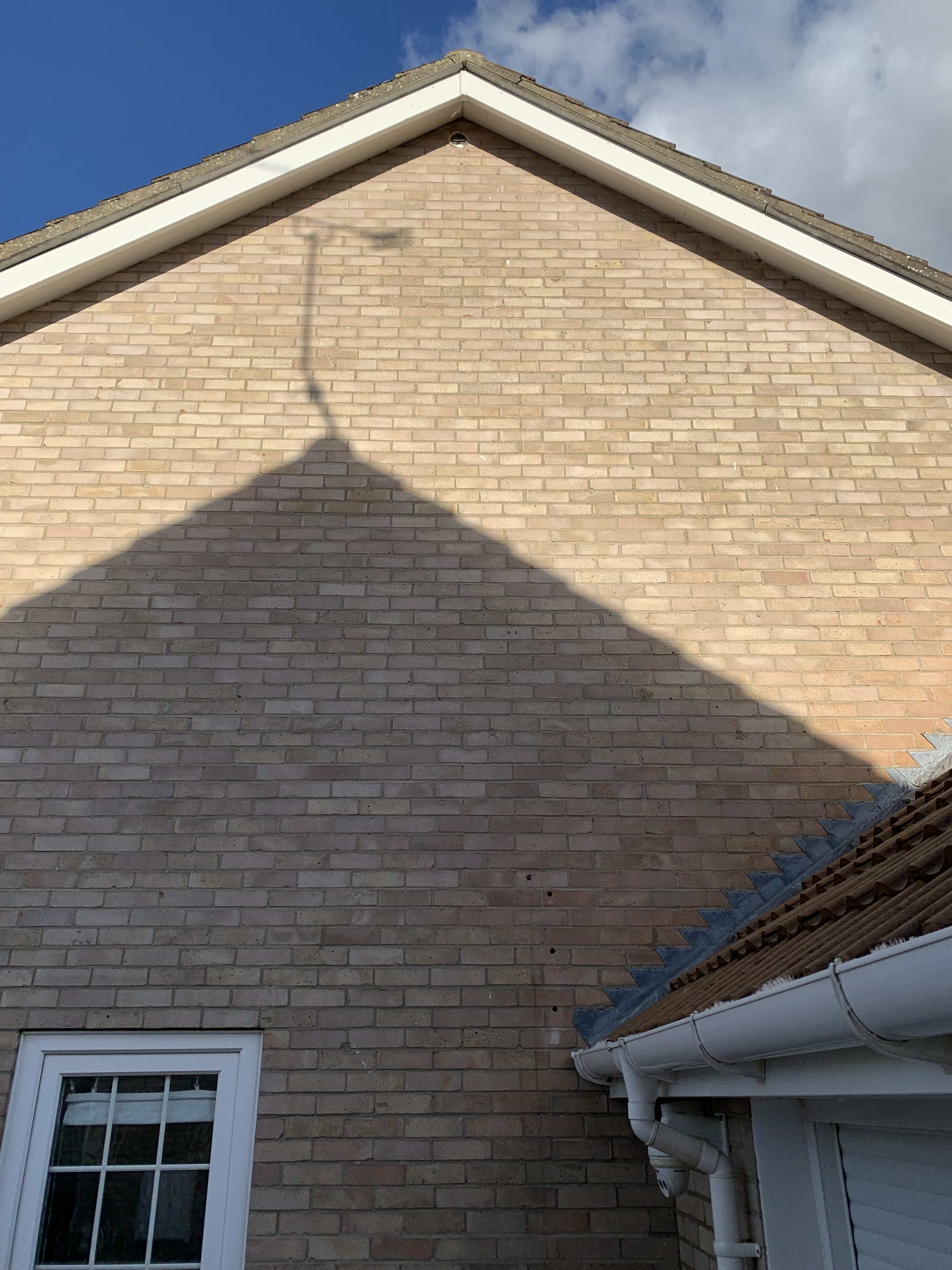

Also core drilled a hole in two of the four gable ends from the inside out and didn't explode the faces (Thanks @Nickfromwales - took your approach of slow and let the cutter do the work
Then slotted in a short length of soil pipe and capped it with a stainless steel vent plate
Heights don't normally worry me but this was working at the max extension of my ladder
Did the same on the other side of the house so I'm now getting a nice thro flow when the wind is in the right direction with an added bonus that loft temps are an average of 5 Deg C lower than they were before for same OAT
Humidity levels in the loft have reduced too :D
