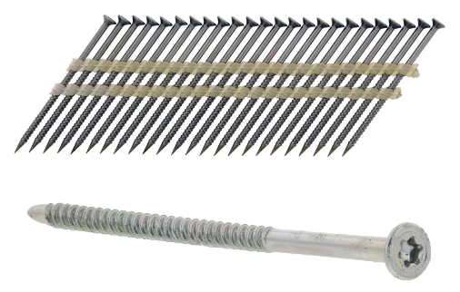

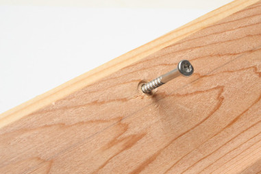

MortarThePoint Posted September 10, 2024 Share Posted September 10, 2024 I wanted to use the Clad-Tite screw from Tite-Fix for my feather edge cladding, but they don't currently stock it so I can't get any. What is really nice about it is that it is collated and can be fired by a nail gun. It then behaves like a small headed screw and can be taken in and out using a TX10 bit. It should also allow firing the 'nail' not quite all the way and then fine tuning with the screw feature. "Fits most gas powered guns" I see Paslode do a similar product, Nailscrew. It has a narrower shank (2.8mm vs 3.1mm) and uses a TX15 bit instead of TX10 so looks to have a larger head. Being a Paslode product, I guess it will only work with Paslode nail guns but I would have to hire a nail gun anyway so that's not really an issue. Has anyone used these or a similar product or got some other suggestions? Link to comment Share on other sites More sharing options...

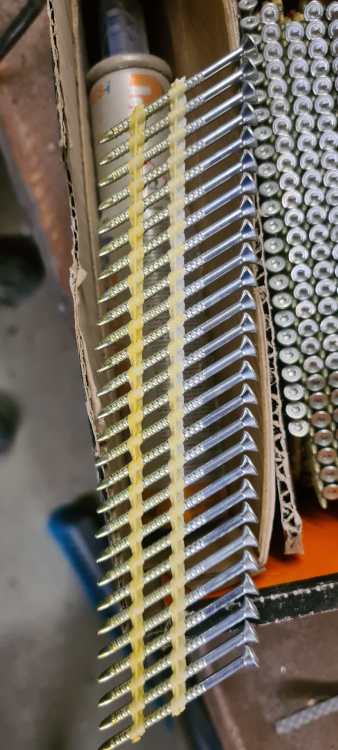

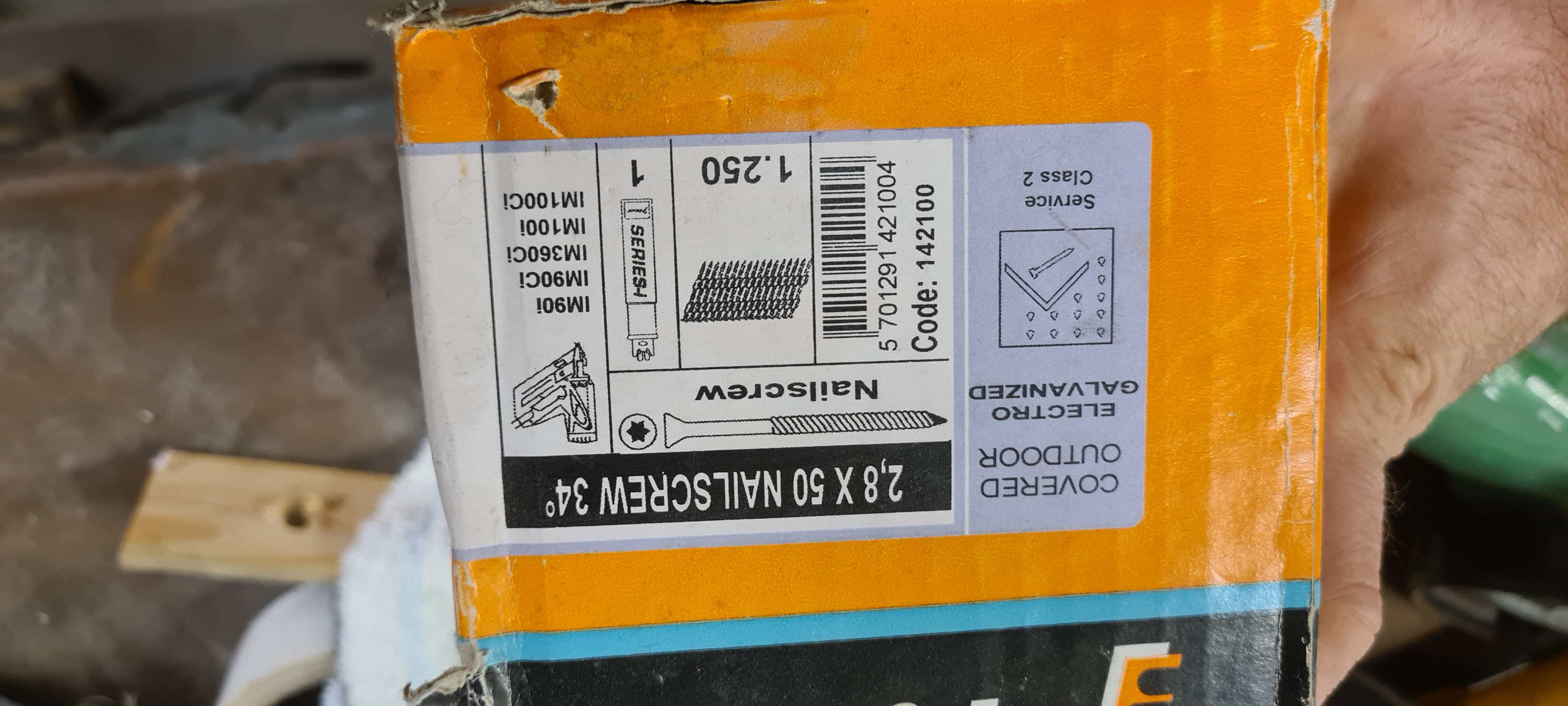

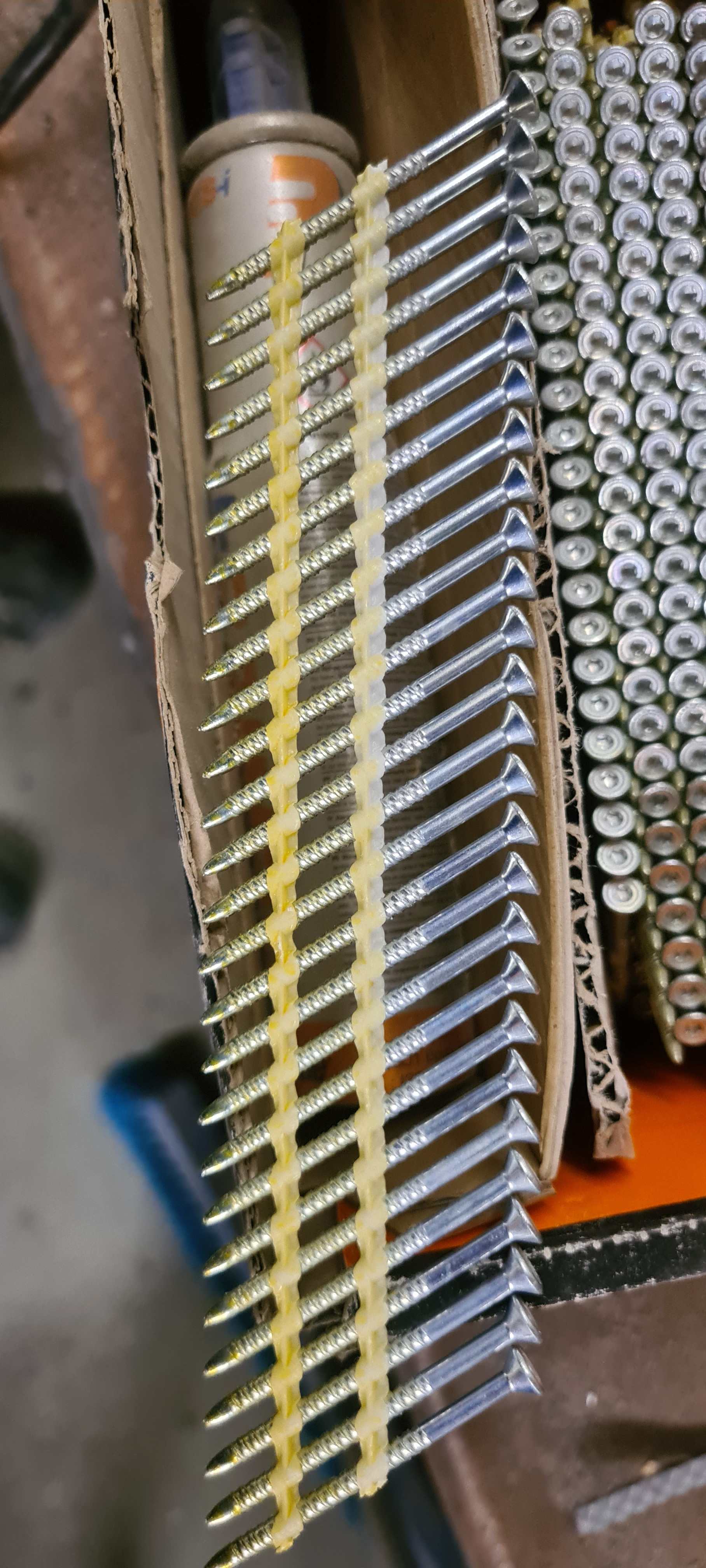

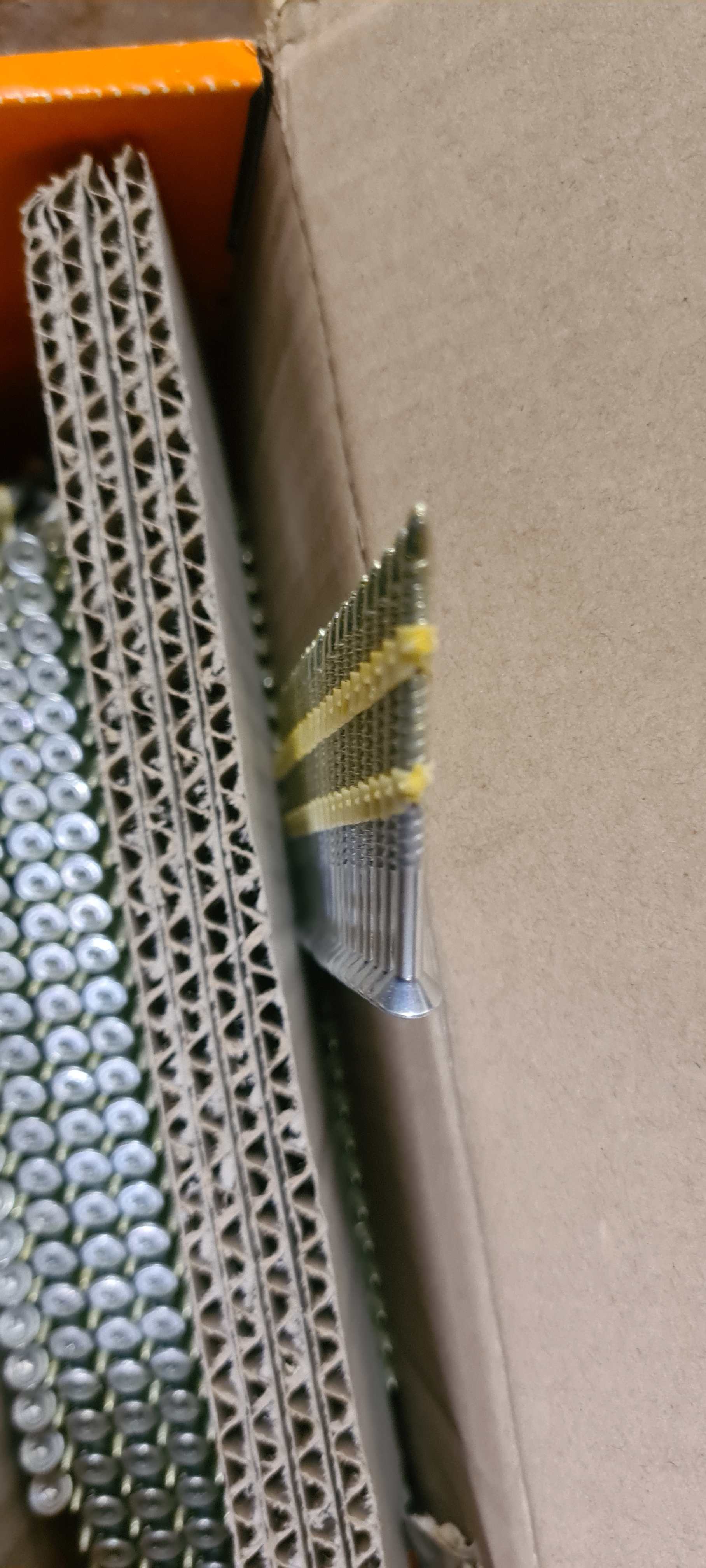

Barnboy Posted September 11, 2024 Share Posted September 11, 2024 @MortarThePoint it was 3 years ago. I still have 90% of a box of them in my shed, I'll try and remember to post a photo later so you can see if the strip is the same. When they fired nicely they were good, i was just getting so frustrayed with them that i gave up. Link to comment Share on other sites More sharing options...
Barnboy Posted September 12, 2024 Share Posted September 12, 2024 @MortarThePoint These are the ones I have, they look to have the same plastic strip as the screws on your post. 1 Link to comment Share on other sites More sharing options...
MortarThePoint Posted September 12, 2024 Author Share Posted September 12, 2024 2 hours ago, Barnboy said: @MortarThePoint These are the ones I have, they look to have the same plastic strip as the screws on your post. Thanks for taking the time to photograph. It does look the same. Do you think under firing it would allow the plastic to be picked off and then tighten it the last bit as a screw? So much for their claim "Six times faster to install than standard wood screw". The head looks quite a lot larger than the (unavailable) Clad-Tite head which is also a shame. Are you aware of any other nail gin screws? Link to comment Share on other sites More sharing options...
Barnboy Posted September 12, 2024 Share Posted September 12, 2024 I dont know of any others. The problem wasn't them sinking in, it was the actual firing, the plastic doesn't tear like the paper on the nails so you end up with miss fires, jamming and doubles. Unless you're super patient don't bother with them. Link to comment Share on other sites More sharing options...
