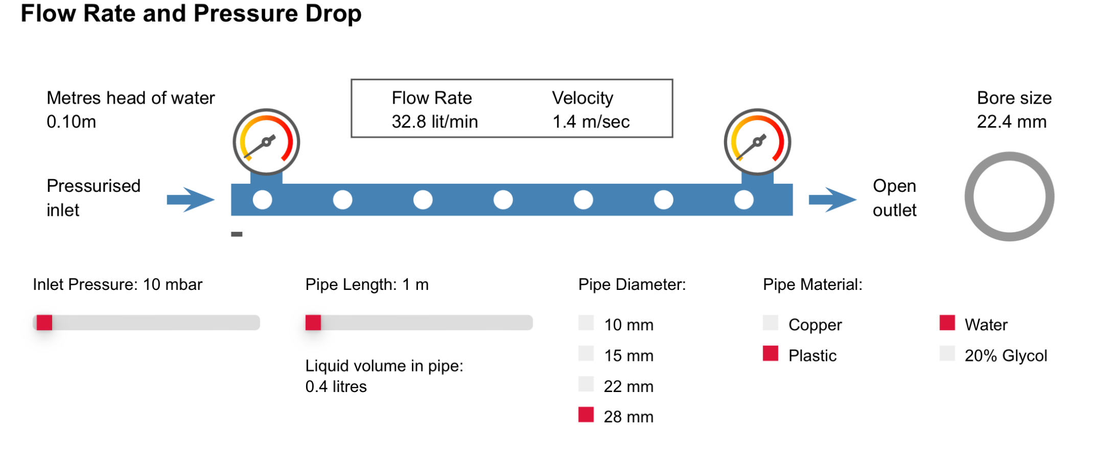

Nick Laslett Posted September 11, 2024 Share Posted September 11, 2024 Quote @JohnMo As a side note Hep2O is only happy with 1.3m/s for hot water. Should I be worried about this? I assume this is for 60°C water? I’m using Hep20 for my ASHP from the insulated Pex to the UFH manifold. Not sure if I’m using the calculator correctly, but just wanted to record somewhere the max flow rate for 1.3 m/s velocity. I believe my ASHP is running at 14 l/min. Link to comment Share on other sites More sharing options...
JohnMo Posted September 11, 2024 Share Posted September 11, 2024 1 hour ago, Nick Laslett said: Should I be worried about this? No If you are doing 14 l/min and the limit is close to 32 l/min, you have no issues. 1 hour ago, Nick Laslett said: 1.3 m/s velocity 14 l/min. m/S is velocity l/min is a volume flow - so very different units. 1 Link to comment Share on other sites More sharing options...
