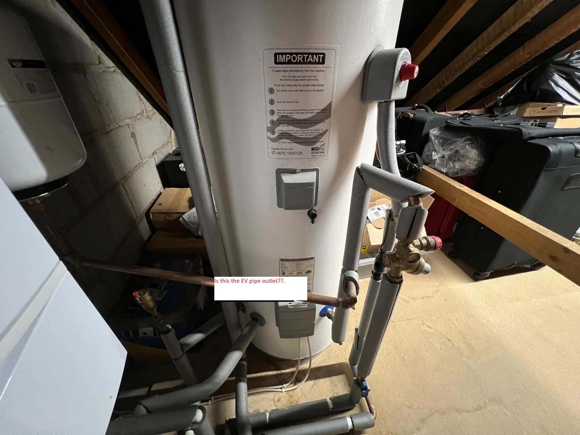

steveoelliott Posted September 8 Share Posted September 8 Hi, I have noticed that when a hot tap is opened for the first time after a heating cycle (in this case a bath tap), the water flows for a couple of seconds and then there is a very loud noise as can be heard in the video. Any ideas what it may be? The EV was recently checked and pressure increased from 1 to 3 bar per instructions but notably it did this before. I just at that time didn't know the trigger. It hasn't always done this however, probably the last couple of months or so. Thank you. Img 4357-1.mp4 Link to comment Share on other sites More sharing options...

steveoelliott Posted September 11 Author Share Posted September 11 For completeness, attaching pictures of the installation. I have been told by my plumber and baxi the likely cause is the water inlet control block / PRV. I will be getting this changed shortly. Link to comment Share on other sites More sharing options...
John Carroll Posted September 15 Share Posted September 15 There seems to be a balanced cold teed off (incorrectly IMO) after the valve combination set, this should be taken from the PRV balanced cold port and before the check valve. If you open a (balanced) cold tap before drawing off any HW, do you get this noise?, if you dont, shut the isolating blue lever valve on the balanced cold before opening the HW after the next re heat and check for noise. 1 Link to comment Share on other sites More sharing options...
JohnMo Posted September 15 Share Posted September 15 A few issues unrelated to the question The pipe exiting the tundish is supposed to have a continuous fall, to comply with G3. Yours goes horizontal which does not comply. If it's 22mm you are only allowed it to be a max of 9m less 0.8m for each elbow. There are a minimum of 3x elbows visible so max length allowed is 6.6m. not sure where the pipe goes off the edge of the photo. But maybe too long? Insulation has way to many gaps. This needs to be sorted, plus better corner joints. All joints should be tight. Plus if outside the heated envelope it looks like thicker insulation would help. As @John Carroll says cold water feed is not correct. The combined valve has a check valve within it, the balanced cold water feed is taken upstream of the check valve. In it's current location you are likely getting a reverse flow through the cylinder when both hot and colder water are asked for. 3 things to sort Connect cold to balanced port on combination valve. Sort tundish discharge pipe. Full instructions are in your cylinder manual. Sort insulation. 1 Link to comment Share on other sites More sharing options...

JohnMo Posted September 15 Share Posted September 15 38 minutes ago, John Carroll said: Looking at that photo again, looks like that pipe is (correctly) the T in from the expansion vessel. If that is the case, I cannot see. You need a check valve in the hot water outlet (top of cylinder) to prevent reverse flow, as cold water pressure could be higher than hot water cylinder pressure. 1 Link to comment Share on other sites More sharing options...

John Carroll Posted September 18 Share Posted September 18 On 17/09/2024 at 09:54, steveoelliott said: Yes I have one of these. Thanks for your analysis...1) Whilst the EV is not connected to the output on the Calefe combination valve, it is (to my knowledge in the right place and doing it's job). Where is the EV connected into the system?, it looks to me to be teed in to the cold feed after the combination set which is correct?. Link to comment Share on other sites More sharing options...
steveoelliott Posted September 18 Author Share Posted September 18 @John Carroll @JohnMo @ProDave Firstly @John Carroll, the EV is the other side of the combination valve. For the benefit of all that advised, this issue appears to now be resolved following the replacement of the PRV block. The one that was on the system was a Caleffi and not a genuine part (it worked fine for years) so I opted to swap with a very expensive set from Baxi which cost £204.00. My plumber did the work earlier today, cylinder was drained, he replaced the PRV with the new one and refilled. So far, no noise on tap opening. It got the point it was happening every time the hot tap was opened unless done very very slowly. One thing I noticed right away was how much more pressure there is when using the hot taps. It wasn't bad before, but now when opened, the pressure is much higher and it tails off after sometime. I actually remember it being like this a long time ago but hadn't notice it drop. With the old PRV block out, I decided to have a look at the mesh filter. It was impossible to pry it out and I had to force it out by ramming a screwdriver down the edge to lever it out. On one side of the mesh there were some crusty deposits so it could be that this was part of the problem or contributing to it. If a cylinder is serviced annually, I guess these filters are cleared but speaking to my plumber, very few people bother. I have another adjustable PRV by the main stockcock with gauge (this is also Caleffe), this provides a balanced cold. I may now with the knowledge from the other have this mesh cleaned or may just opt to swap it completely in case it leaks after being dismantled. Thanks all for your feedback. Link to comment Share on other sites More sharing options...
John Carroll Posted September 18 Share Posted September 18 (edited) I know that the pressure is subjective (my kingdom for a pressure gauge) but IF the EVs pre charge pressure was checked/adjusted to 3.0bar gauge then the final pressure after reheating the full contents to 60C will be only be 3.93bar, hardly noticeable, one would think, when a hot tap is opened, if the EV precharge pressure wasn't checked or charged incorrectly to 1.0bar, then that final pressure will be 5.43bar, in either case the pressure will fall to 3.0bar when the expanded vol of 3.4L has flowed from the hot tap, in the very unlikely event that the precharge pressure is only 0.6bar then the final pressure will be 6.58bar. Re the EV pipe outlet, just to be absolutely clear, is it teed in where I show it in the photo?, if so, quite correct, if not, and teed in before the combination valve (effectively, no EV in the system) then the expansion will still be taken up by the Megaflo's bubble which will still be there if the dip pipe hasn't been removed, I reckon that the final pressure (with no EV) will then be 4.28bar after expansion, not bad until the bubble disappears, if the EV is installed correctly and the bubble exists then there could be some shunting between the EV and the cylinder which could conceivably cause noise again eventually. Theres definitely something not quite right IMO because the final pressure with both the EV and the air bubble should only be ~ 3.4bar after expansion, certainly not noticeable? The other possibility for the high pressure is that the balanced cold isnt, it may be at a higher pressure and leaking through a mixer and pressurizing the cylinder. Edited September 18 by John Carroll Link to comment Share on other sites More sharing options...
steveoelliott Posted September 18 Author Share Posted September 18 @John Carroll I can confirm that labeled pipe is the EV outlet. When checked ~3 weeks ago the EV pressure was 1 bar and we increased it to 3 bar. I have another PRV on the cold mains set to 3 bar but with a cold tap running it's just under 2 bar. There certainly is no issue with backflow from mixer taps. The pressure generally from the hot taps is much better than it was prior and I suspect this may be due to the mesh being partly blocked / defective PRV. We know that was faulty as replacing it solved our issue. The bubble on the megaflo is knackered... I had deposits of it coming through taps, caught by the mesh on taps, hence the external EV. This was also confirmed by BAXI. I wonder if there is still any benefit going through the bubble recharge process even with a knackered baffle. I suspect not. Link to comment Share on other sites More sharing options...
