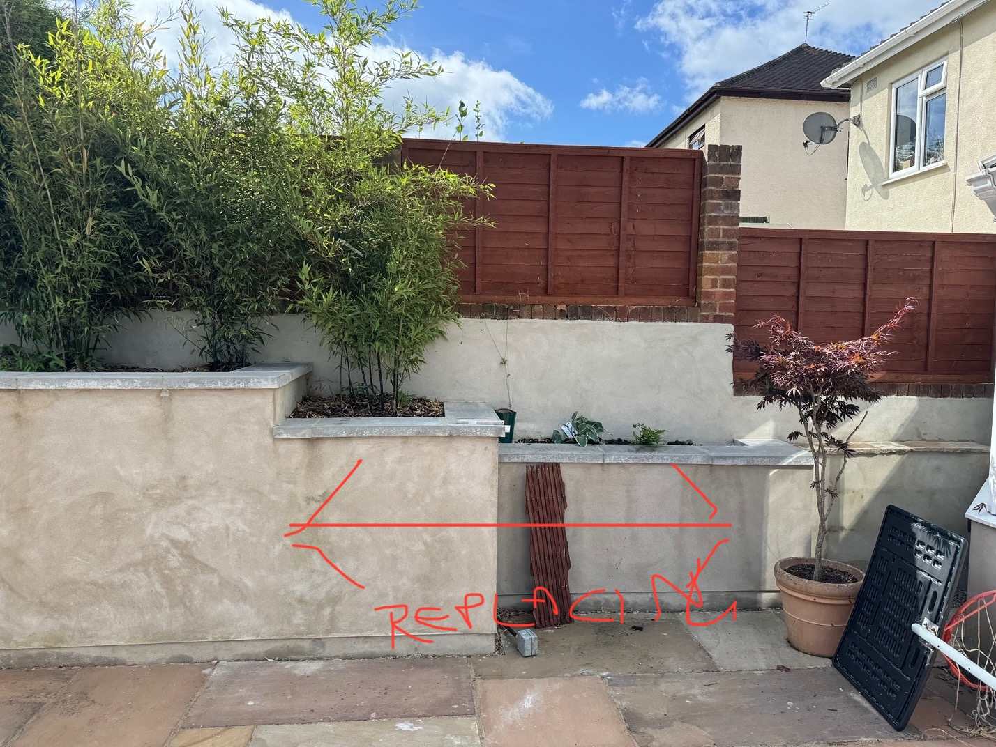

JayBo1979 Posted September 6 Share Posted September 6 Hi there. I am planning to build a rear single storey extension under PD. Part of the work will involve replacing an existing retaining wall next to the boundary with something slimmer and then tieing this new RW into the side of the extension The RW will be wholly on our land butting up to our party fence/wall with next door, where the ground is higher. The party wall consists of a blockwork wall at the bottom and then a fence on top (line of junction). See photo. We will not be cutting into or altering the party wall. I am hoping this can be done without a PWA as the neighbours have made our lives hell over other planned works. Can anyone confirm? The foundations for the RW/ extension will be stepped, entirely on our land and on that side only 300mm so I know that’s fine. As the new RW will abutt the blockwork wall but not be on the line of junction (where the fence is) will this be ok? We will not be cutting into or altering the party fence wall- just building a new RW up against it we replaced the whole of the RW a year or so ago without a PWA or problem and now we just want to replace the part on the photo with the red arrow. The higher/bulkier party of the existing RW on the left will remain in place Can anyone offer any advise on whether a PWA is needed? Thanks Link to comment Share on other sites More sharing options...

Redbeard Posted September 7 Share Posted September 7 Have you read the gov't's guide to the PWA? https://www.gov.uk/government/publications/preventing-and-resolving-disputes-in-relation-to-party-walls/the-party-wall-etc-act-1996-explanatory-booklet This may (or, I accept, may not) answer your Qs. (Was typing the above when @joe90 replied). If your new retaining wall is entirely separate from the party wall and will not in any way interfere with that wall's foundation you *may* be able to argue that these are not works to, or affecting, a party wall. But I am not sure we have enough info. It seems that the party wall is built well above the level of your yard with its footing well above the level of your yard, possibly meaning that if you were to take down your 'retaining wall' which is entirely on your land you would be removing support from the party wall. That sounds like something which affects a party wall. Link to comment Share on other sites More sharing options...

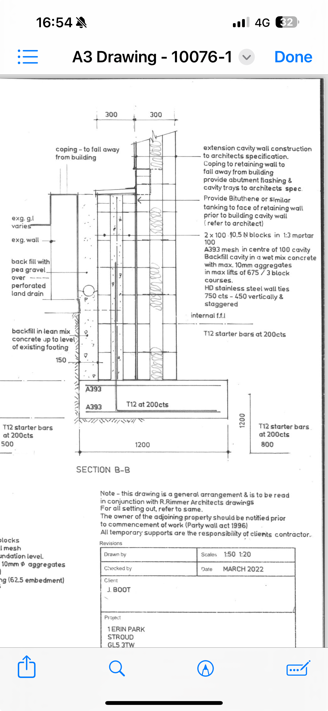

joe90 Posted September 7 Share Posted September 7 From the original drawing the boundary wall foundation is way above ground level the OP,s side 🤷♂️ surely that’s not right? Unless the OP,s side was excavated later. Link to comment Share on other sites More sharing options...
JayBo1979 Posted September 7 Author Share Posted September 7 2 hours ago, joe90 said: From the original drawing the boundary wall foundation is way above ground level the OP,s side 🤷♂️ surely that’s not right? Unless the OP,s side was excavated later. Yes I believe our side was excavated later so the footings of the party fence wall are about 50cm above our ground level. The footings for our new RW snd extension will be 300mm deep on this side, so below the footings of the party fence wall but not below the foundations of the neighbours property. This is so confusing! Any further advice? Link to comment Share on other sites More sharing options...
