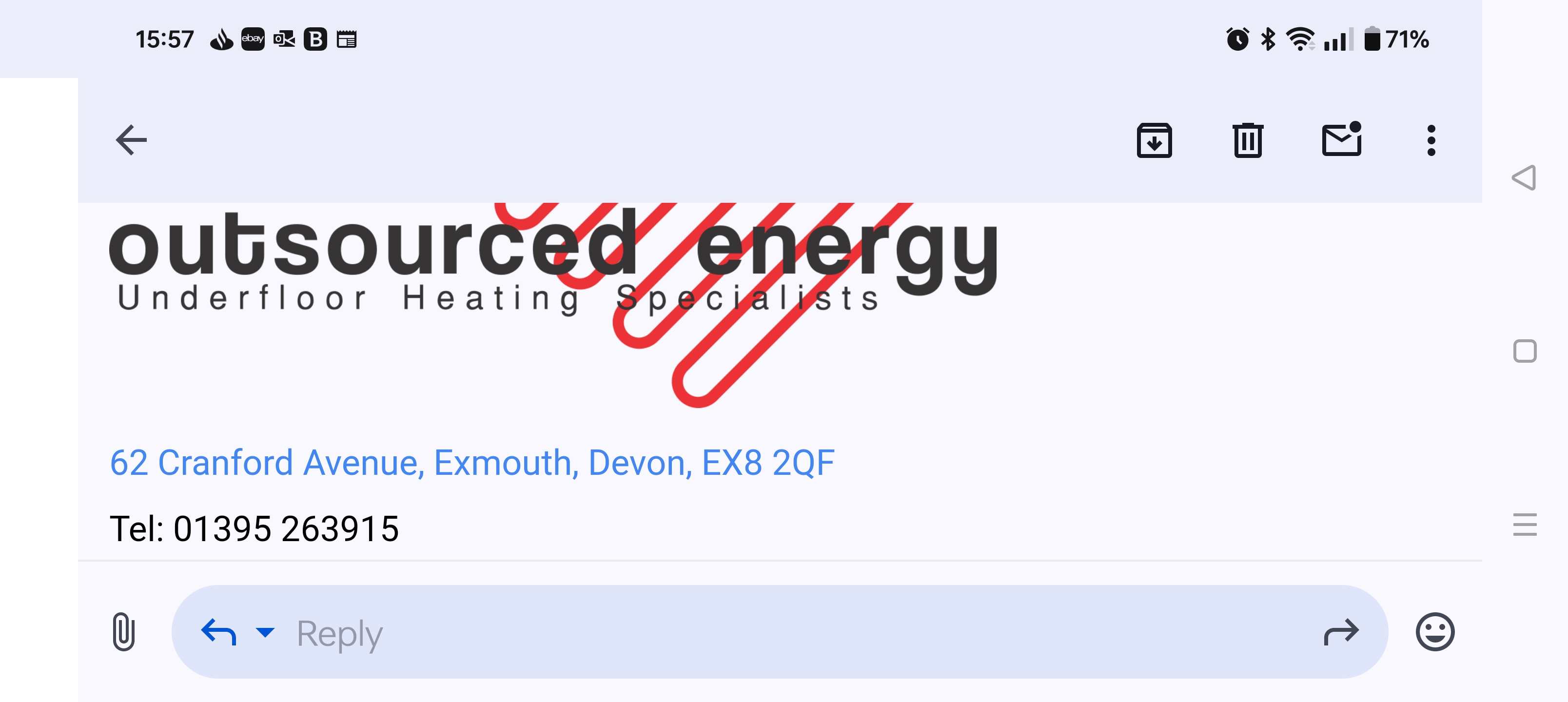

This is where we got all our UFH from, if your local they install as well.
Screenshot_2024-09-06-15-57-57-74_e307a3f9df9f380ebaf106e1dc980bb6.thumb.jpg.f5f37a58b77ed68858809d52f5a78b53.jpg
