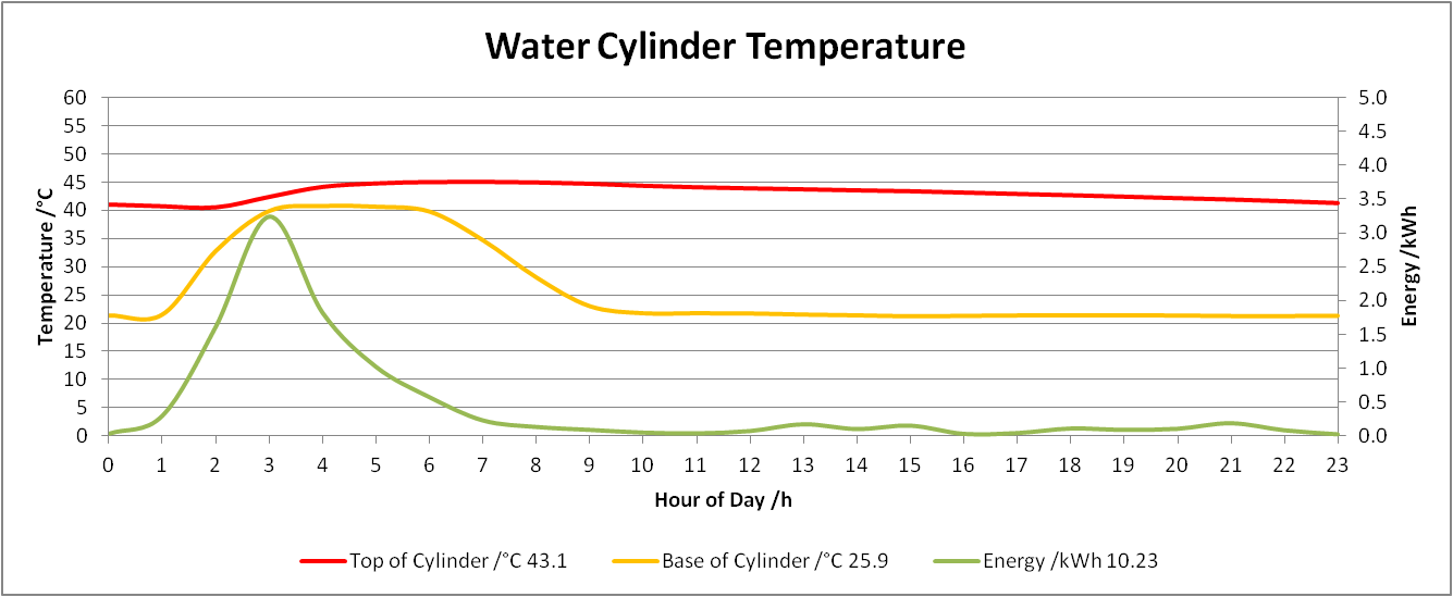

SteamyTea Posted September 1, 2024 Share Posted September 1, 2024 1 hour ago, Little Clanger said: I've got a jacket on the cylinder in addition to the sprayed on foam insulation I basically filled my airing cupboard up with insulation. 1 hour ago, Little Clanger said: What temperature do you have your two thermostats set at? Lower thermostat is set so the top of the cylinder is 50°C. The upper thermostat is set to 55°C, but I very really use it. 1 hour ago, Little Clanger said: I've struggled to find any clear data on the temperature difference between the upper and lower areas of a hot water cylinder Somewhere on here I posted up a chart showing my mean positional temperatures. Here it is. 1 hour ago, Little Clanger said: suppose another option would be to have a pump circulating the water from top to bottom of the cylinder I thought about this but, for me, it is not worth it, and would only store a small amount of energy anyway. I am a pretty unique case as I rough it on my own, so can put up with a bit of a short shower, or Luke warm bath occasionally. As I am constant trying to save energy, without large capital expenditure, I look at cheap options. I have secondary timers fitted to all three E7 circuits that limit the run time. I have just reset my hot water timer to come on at 4AM and off at 6AM. This will limit the storage to 6 kWh and should give me a bathful in the morning (at about 6AM) without any reheating, which for me, is wasted as losses. I do similar with the storage heaters as I like it warm when I get up, so no point them reaching maximum capacity at 4AM, then cooling, then reheating. I effectively have E4. Just had my water bill in and in the last 90 days have used 20m³. Which is way too much (220 lt/day). Last year I used a lot less, almost half, but it was a strange year last year as I was away a lot more). I justify my high usage as my body aches a lot and no one wants to see a grubby chef, in grubby clothes. 1 Link to comment Share on other sites More sharing options...

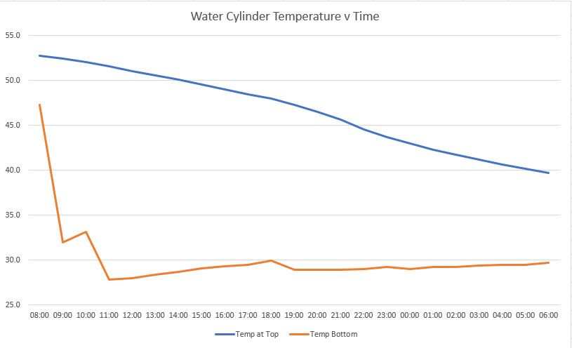

marshian Posted September 2, 2024 Share Posted September 2, 2024 We have a 114 Litre tank (Ish) we heat water once a day between 7am and 8am to around 50 deg (this fluctuates a bit because the water heating is timed rather than to a set temp point) This gives us enough water for 2 showers AM and 2 showers PM - I have data logging temp sensor at top of tank and another at the bottom However this means our graphical representation looks a little weird but fundamentally once the morning showers are done the water at the bottom of the tank is replaced with water from the cold store in the loft above Our energy usage in summer for water heating is much lower than the winter where the cold store tank (cold loft) is at a much lower temp Link to comment Share on other sites More sharing options...
SteamyTea Posted September 2, 2024 Share Posted September 2, 2024 5 hours ago, marshian said: Our energy usage in summer for water heating is much lower than the winter where the cold store tank (cold loft) is at a much lower temp Mine as well. Kind of a poor man's solar thermal. Link to comment Share on other sites More sharing options...

marshian Posted September 2, 2024 Share Posted September 2, 2024 1 hour ago, SteamyTea said: Mine as well. Kind of a poor man's solar thermal. I think of it like that too - Loft temp in the spring/summer/autumn in daylight hours can regularly be above 30 Deg C for most of the day and has occasionally hit low 40's I have a data logger recording temp and humidity up there because I was concerned about pipes freezing in the winter after I moved the cold water tank to a better location and increased the length of all the pipework by 3m This winter (when temps are cooler) the plan is to increase the level of insulation up there which will lower the cold temps further Link to comment Share on other sites More sharing options...
