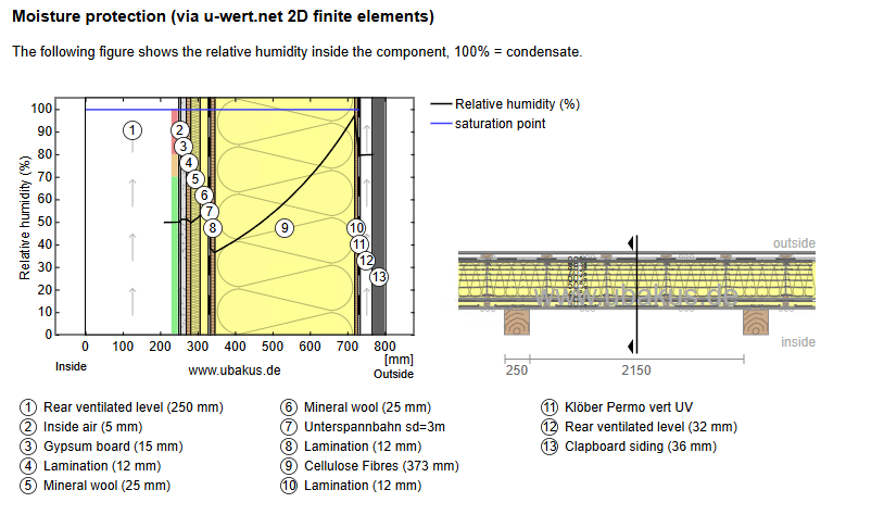

Alan Ambrose Posted August 29, 2024 Posted August 29, 2024 You can use ubakhus DIY for moisture (and thermal) analysis if you want. It's also a useful way to model the physical wall / roof / floor stack-ups. This kind of thing:

G and J Posted August 29, 2024 Author Posted August 29, 2024 5 hours ago, Alan Ambrose said: You can use ubakhus DIY for moisture (and thermal) analysis if you want. It's also a useful way to model the physical wall / roof / floor stack-ups. This kind of thing: Ubakus DIY? Is that the paid version?

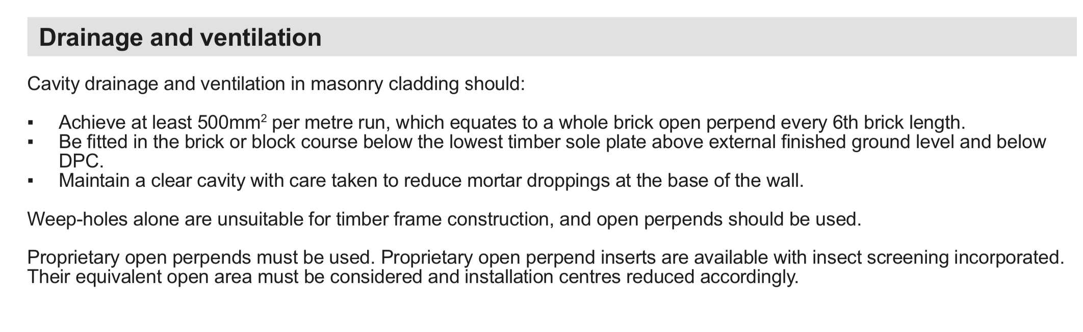

ADLIan Posted August 30, 2024 Posted August 30, 2024 Open perpends, mainly to drain the cavity, are not normally classed as 'ventilating' the cavity as they are too small to actively promote mass air movement
G and J Posted August 30, 2024 Author Posted August 30, 2024 From the LABC manual…. of course it might help if I knew what a ‘perpend’ was. 😕
G and J Posted August 30, 2024 Author Posted August 30, 2024 50 minutes ago, G and J said: of course it might help if I knew what a ‘perpend’ was. 😕 OK, J just found out what perpends are and now I understand your point @ADLIan . So maybe the TF200 Thermo will help a bit. I’m minded to derate the insulative contribution by a third….
