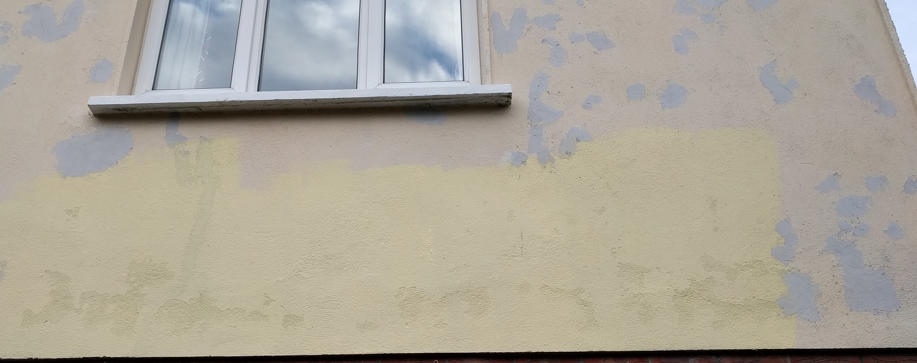

mike2016 Posted November 2, 2017 Posted November 2, 2017 Hi, I need advice about painting the exterior of my house. It's not had any attention in years and some of the paint was bubbled and just fell away. I thought brushing off all the bad paint and just painting over would be fine but you can clearly see the areas of disrepair where I tried this. I've applied Polyfilla exterior today to repair the other damaged areas and cracks but the original builder used a particular surface finish which the smooth pollyfilla doesn't match. Areas where the original paint was good look fine when painted over but the section below I tackled today looks horrible (!) and I need to figure out a better approach before I make things worse..........! Thanks!
ProDave Posted November 2, 2017 Posted November 2, 2017 Before I repainted my old 1930's house I used to own, I cleaned it all off with a pressure washer. That did a very very good job of removing all loose and flaking paint, as well as moss growth. The new paint stuck well to what remained and covered well. TIP: if doing this from a ladder, make sure you know the recoil force on the lance when you press the trigger, and hold on tight.
CC45 Posted November 4, 2017 Posted November 4, 2017 Done the same as Prodave before - it worked really well. One with steam also takes off the old paint as well.
