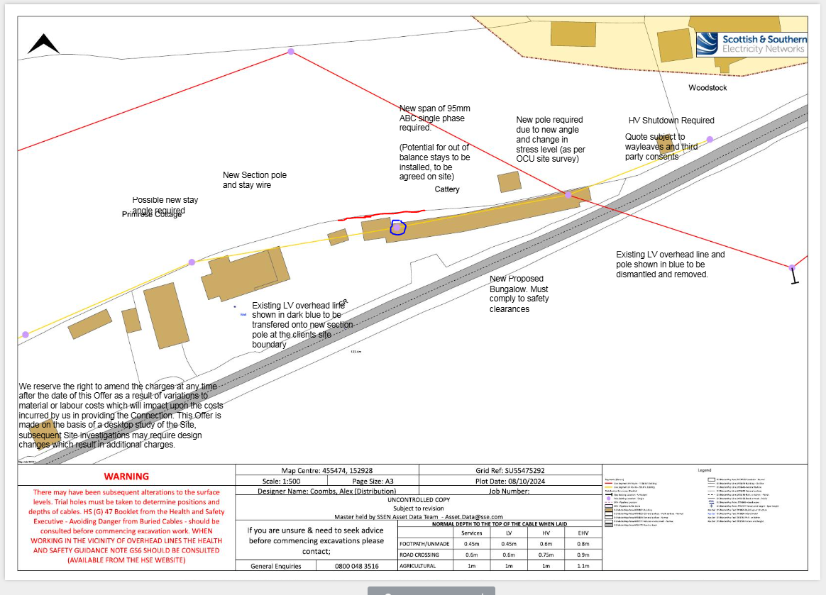

So, the survey was carried out by SSEN, and to move the pole 1.5m to our boundary they have quoted us 25k.  Do I simple now write to the wayleave department and give them notice to terminate?  I am obviously not paying 25k and given the pole that is on the plot is very old and did not get replaced when the others were done a few years ago, I think they are being a bit cheeky.

That sounds a lot, did they give you a cost breakdown, drawing etc? They should do otherwise it’s just a ball park not a proper job estimate. What does the job involve? Post up the quote & drawing?

It basically states the following.  Struggling to understand why the pole being moved back requires a new HV pole further down to be replaced.
What we will do: LV Diversion Works required. Quote subject to wayleaves and third party consents. Client is building a new bungalow and the LV pole adjacent requires relocating. SSEN to dismantle 1x LV pole and 1x LV span of single phase LV. SSEN to install 1x new section pole and transfer 1x span of LV overhead, Install 1x Span of 95mm single phase ABC (out of balance stays maybe required and to be determined on site.  OCU have been to site and advised they have to replace 1x HV intermediate pole
I simply want to move the circled pole to the red line (about 1.5 -2 m)
Edited by flanagaj
Ah don't quite follow (and resolution not good enough to read key):
+ "existing LV in ... blue" is actually show in yellow?
+ straight red line is exising HV?
+ pole to be moved is the one in the wavy blue circle? to be moved ot the boundary shown in red wavy?
My data point is one new LV pole installed / ~50m o/h line removed / replaced with ~50m underground in trench - added up to £16K (all by UKPN). (There was no attempt at negotiation afaik - wasn't my shout).
Are you actually payng for the new HV pole, or is that at their expense?
Looks to me like probably a new span of LV line is required (if the move results in a slighly longer route) plus a pole move. That's what the short written summary says. If you go ahead, it's worth watching whether they actually use new LV line. Ditto the HV pole.
They do tend to take the piss (for what will be a leisurely 1/2 day's work) although some on here have either been lucky or negotiated based on common sense. Probably 4 people on site - the pole guy with the machine to swap poles, a couple of riggers with a lift and a guy to put up red plastic 'safety barriers'. None are probably needed, but he'll probably put them up anyway. Easy for them to get their lifts and machines where they need them? Have they proposed traffic management or road closure? That's expensive.

Straight red line is the existing HV.  That does not need to be changed, but they want 7k just to isolate the supply.  I want the pole circled blue, moved 2m to the boundary so that it follows the path of the squiggly red line.
I still feel they are trying to sting us.  The pole is old, and doesn’t currently have any guide lines attached, and given the distance to be moved is small, I honestly think it doesn’t require a new cable.
I think someone else on here found a 3rd party negotiator working on commission. Is that a route?
