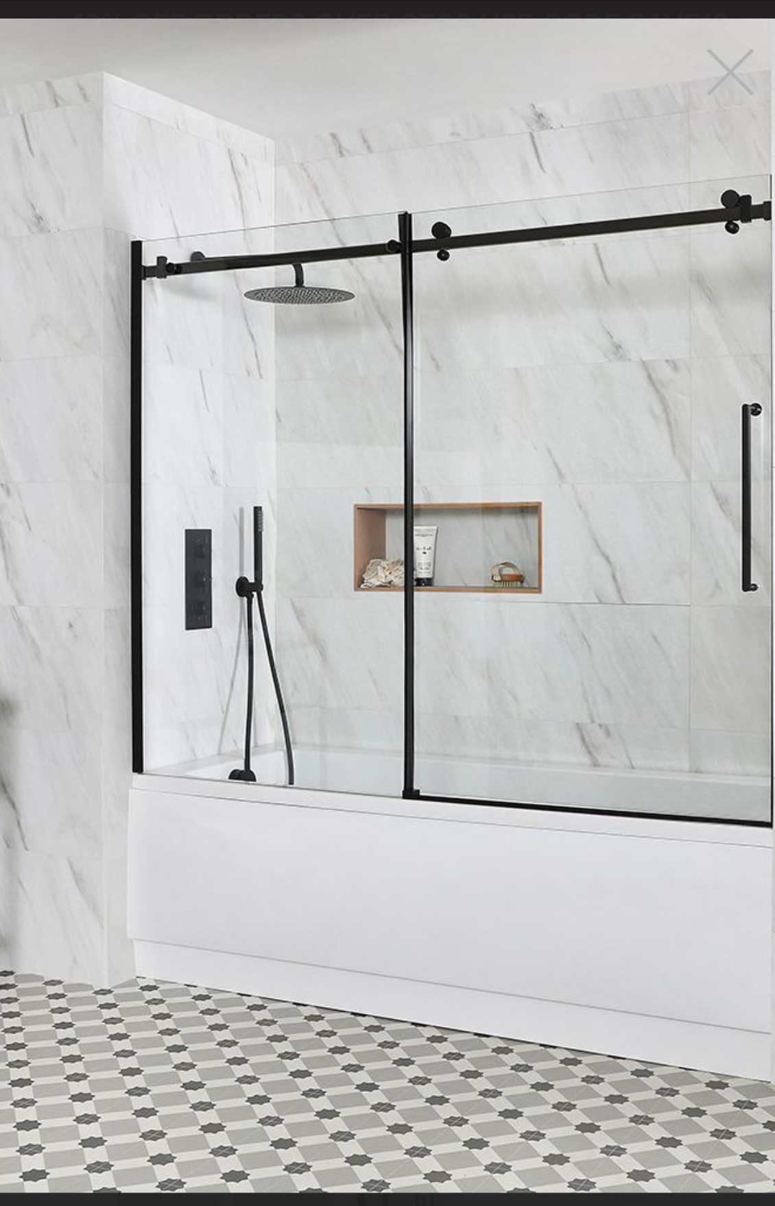

Are these any good?

In the picture, the top of the bath seems to be sloped towards the plug hole and has a good amount of width to help. In my opinion this would be a better design than a small or hinged glass panel.
The Milano Nero looks ok because it has a lipped seal on the internal sliding glass panel stopping the water from finding a route between the two glass panels. The installation instructions are a bit vague and the Big Bathroom Shop pictures showing the details are confusing unless you recognise that they show a left hand opening one!
Milano Nero requires the side of the bath to be flat all the way along as well as level. All achievable, but needs accuracy.

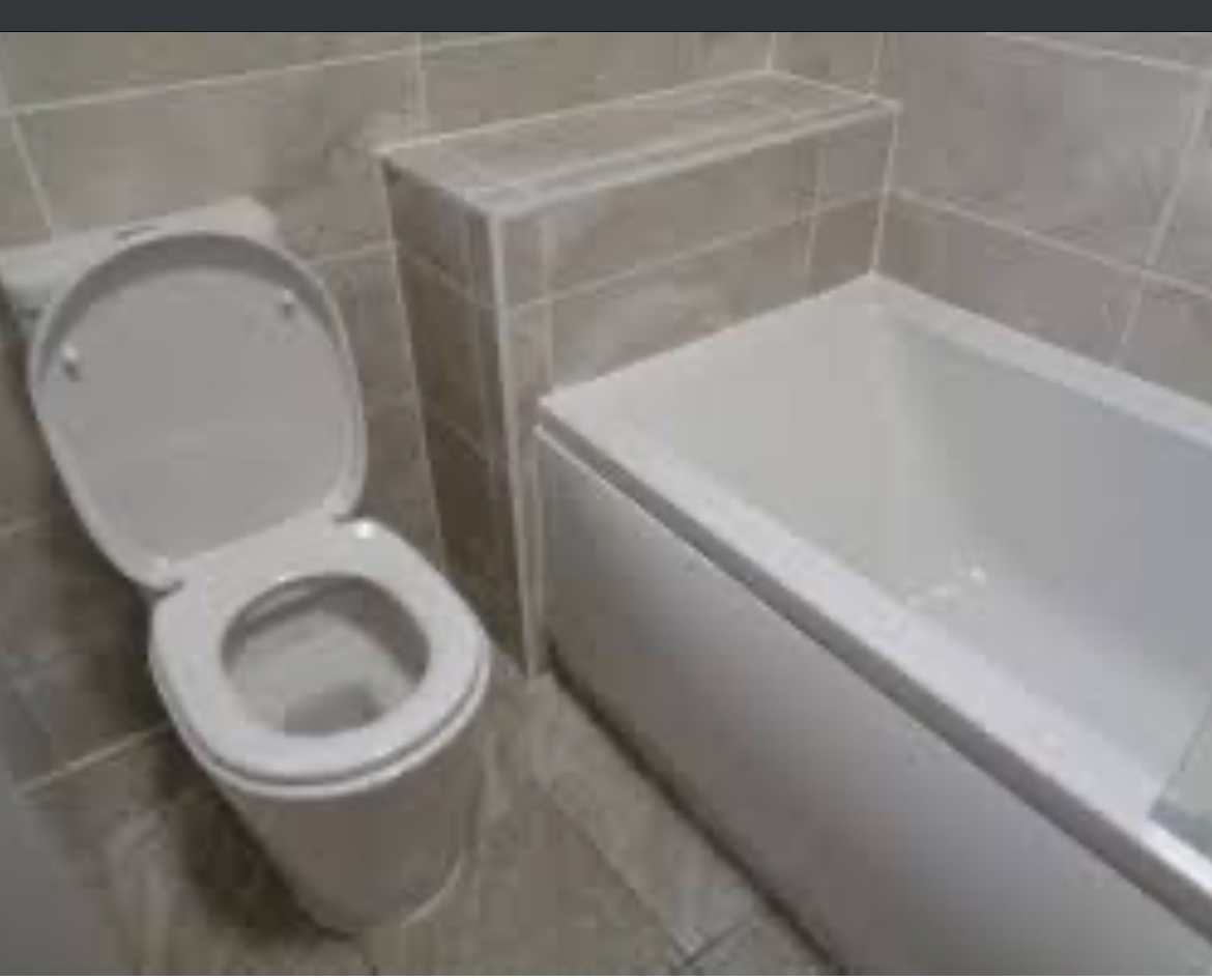

My shower is very high pressure and the problem I have is, a normal 800 wide screen will not keep water in the bath.
I can’t use a wider one as the toilet is at the end of the bath and this could be a hazard climbing out of the bath due to so little space.
Here’s a photo of another bathroom to give you an idea. I’ve less space than this.

If your determined to fit a high powered shower over a bath then the Milano Nero looks the right sort of choice to me.
The key to this is the bath rim and levelness. If you directly message me I will guide you through how I would fit the screen.
