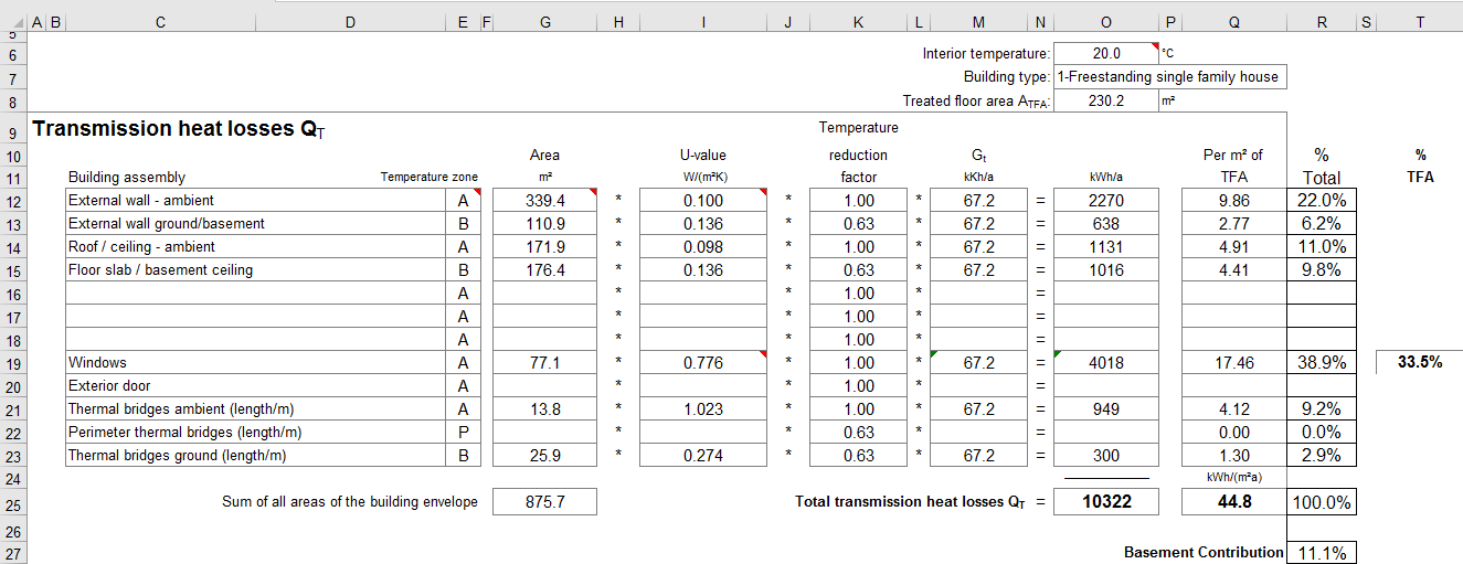

Alan Ambrose Posted August 21 Share Posted August 21 Jeremy was (he no longer posts here) a Buildhub 'living treasure'. See here: https://forum.buildhub.org.uk/applications/core/interface/file/attachment.php?id=18333 Like the design a lot If the architects are sniffy anout giving you the whole PHPP analysis ask for a printout of the section down to cell Q25 at the top of the 'Annual heating' tab. e.g. (this is ours which has an inadvisable amount of glass) 1 Link to comment Share on other sites More sharing options...
