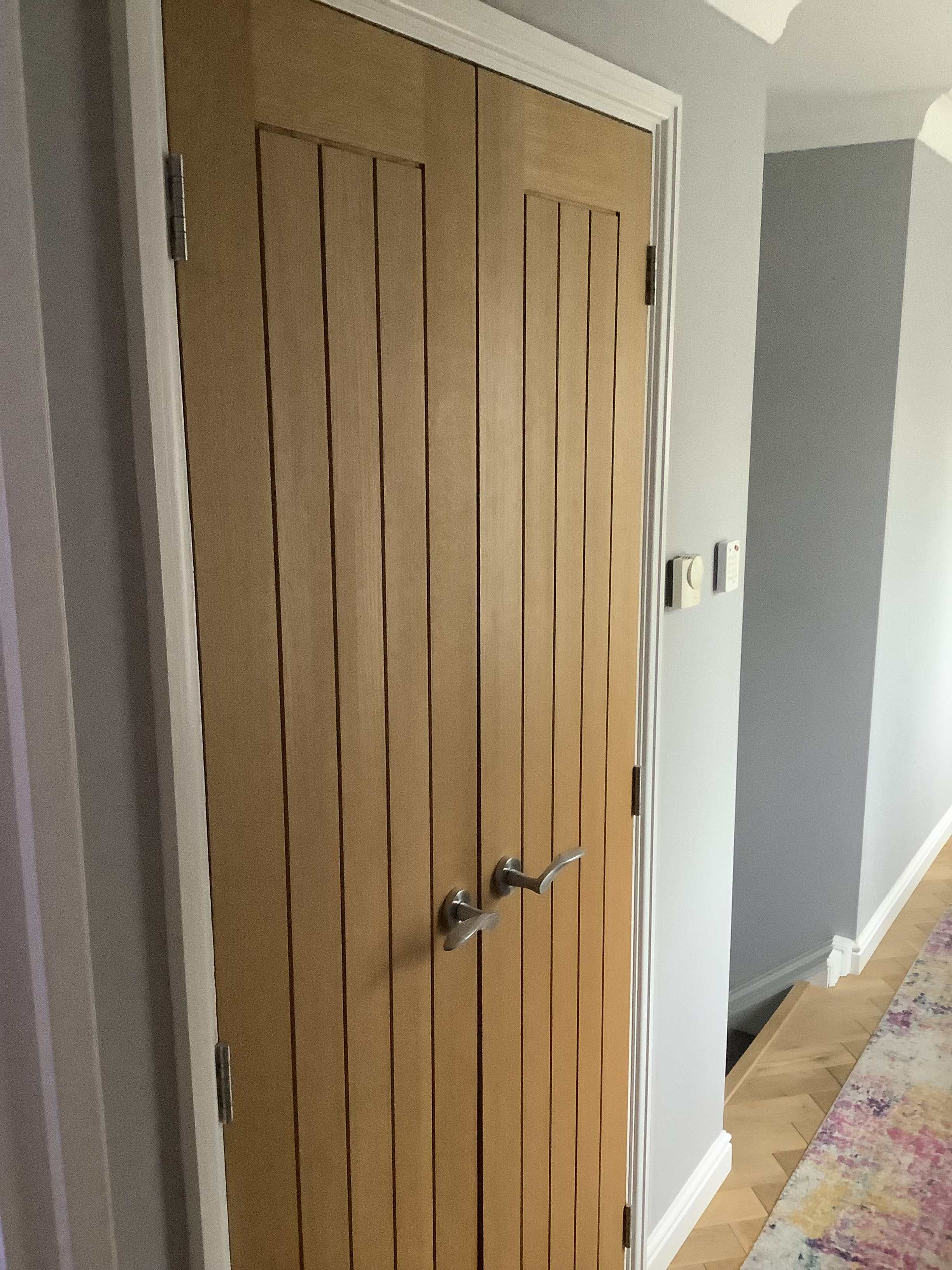

CalvinHobbes Posted August 14, 2024 Posted August 14, 2024 Decided to knock a door from spare bedroom into bathroom next door. Want to minimise how much door swings so thinking about wardrobe style doors hinges each side so half size. I don't want sliding or bifold. What size of opening do you think?

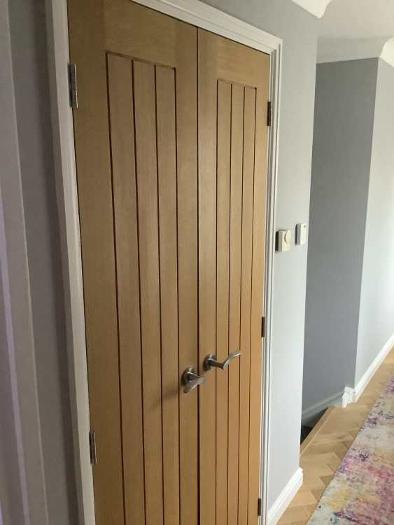

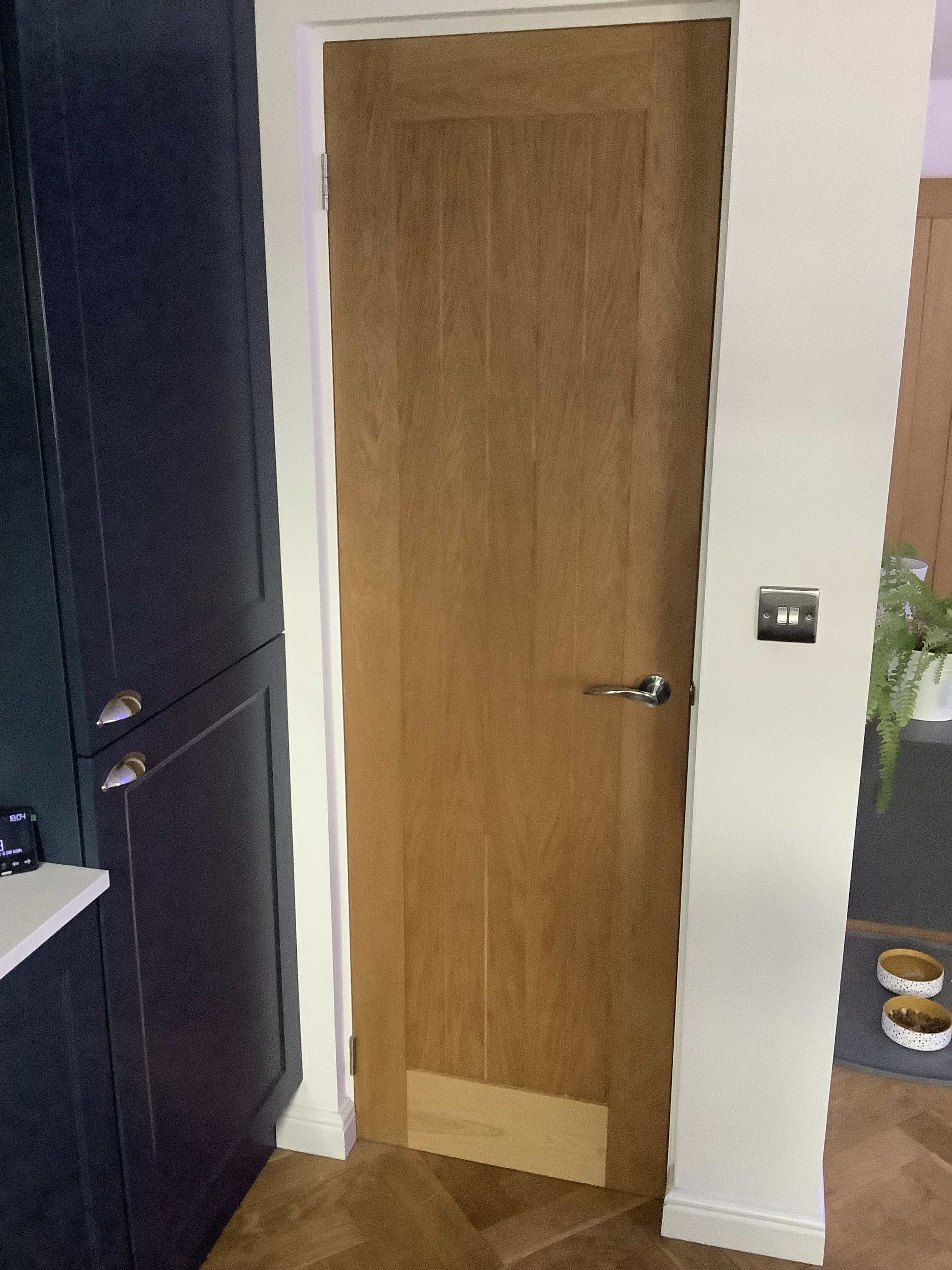

DannyT Posted August 14, 2024 Posted August 14, 2024 450mm door is a standard sort of size for a double opening wardrobe or cupboard. 900mm of doors plus frame. I doubt you will get a smaller standard door. next one up is a 610mm. I have both. One is boiler room and other is cupboard off kitchen.
