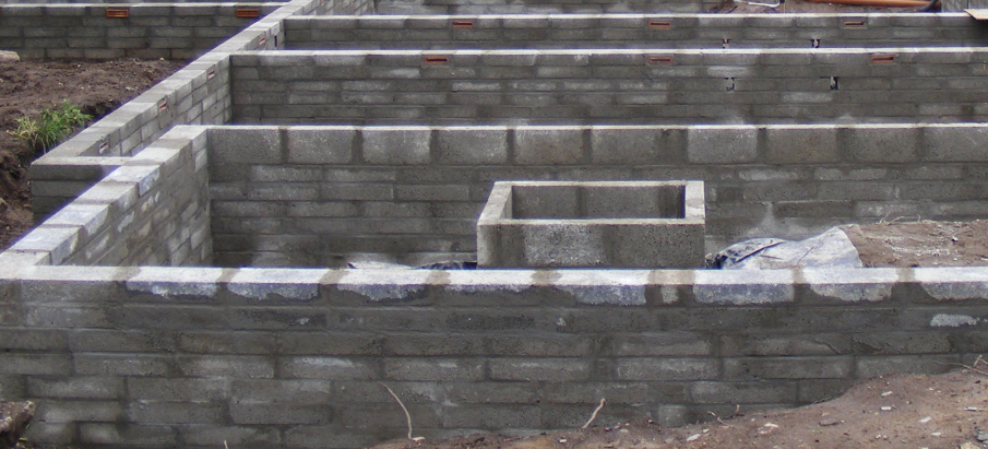

ProDave Posted August 14, 2024 Posted August 14, 2024 Pictures would help. but I think this is describing something I questioned. Below ground wall build up was done as "block on flat" as above, no cavity. I get that bit. But the bricklayer laid a course of blocks on flat, then a second row of blocks of flat exactly on top of the first ones, i.e. no bond. Then the next row was staggered creating a bond followed by another row exactly on top with no bond. So in other words the blocks were staggered / bonded every other row. Now I questioned this. It would have been no more difficult to bond every single row of block on flat and surely that would have been stronger? so why did he not do that? His reply was that is how he was taught to do it. So it is a question for bricklayers please, why not bond every single row of block on flat? EDIT here is a picture of what I am trying to describe, block on flat courses bonded every other row.
Dave Jones Posted August 15, 2024 Posted August 15, 2024 couldn't get hold of trench blocks ? its normal practice not to bond as the pic above below DPC, sleeper walls for b and b etc
