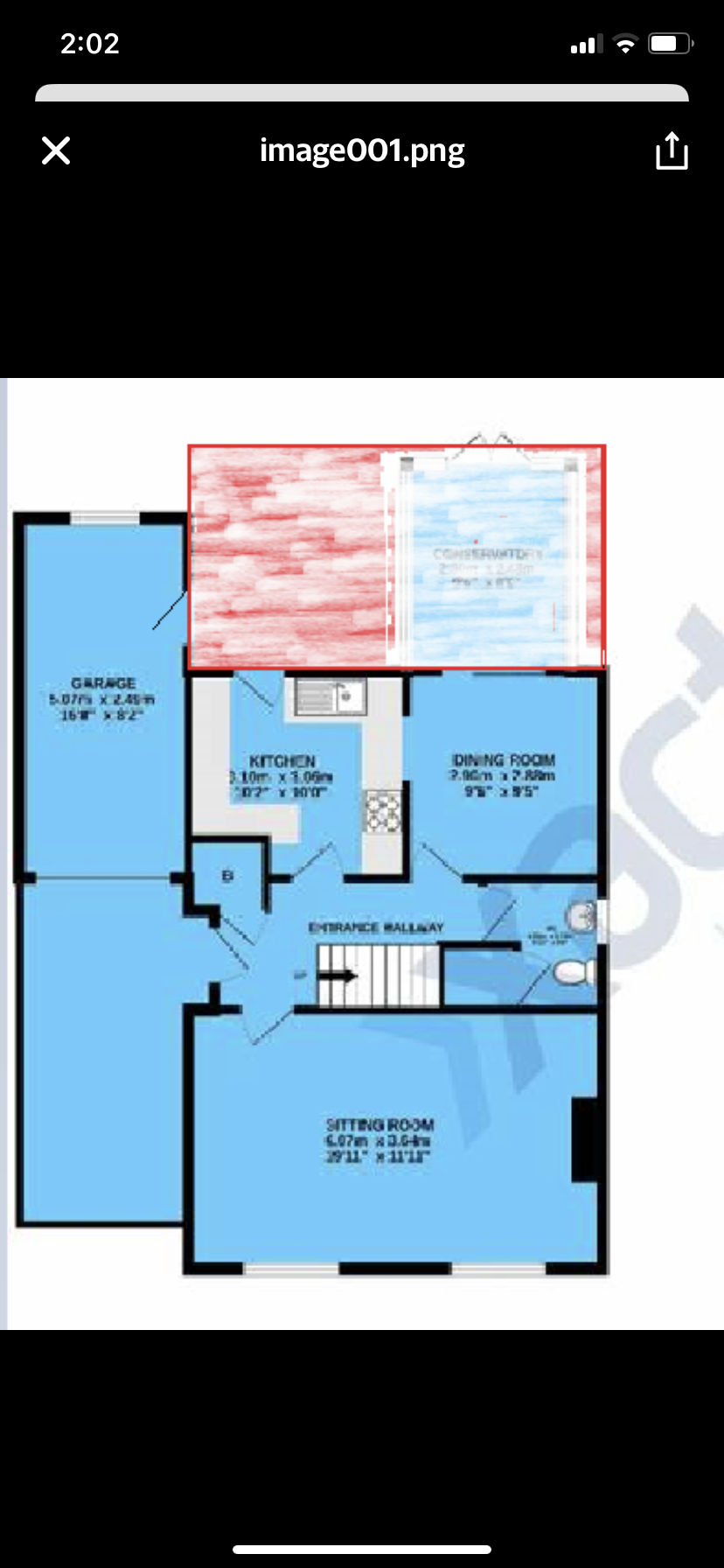

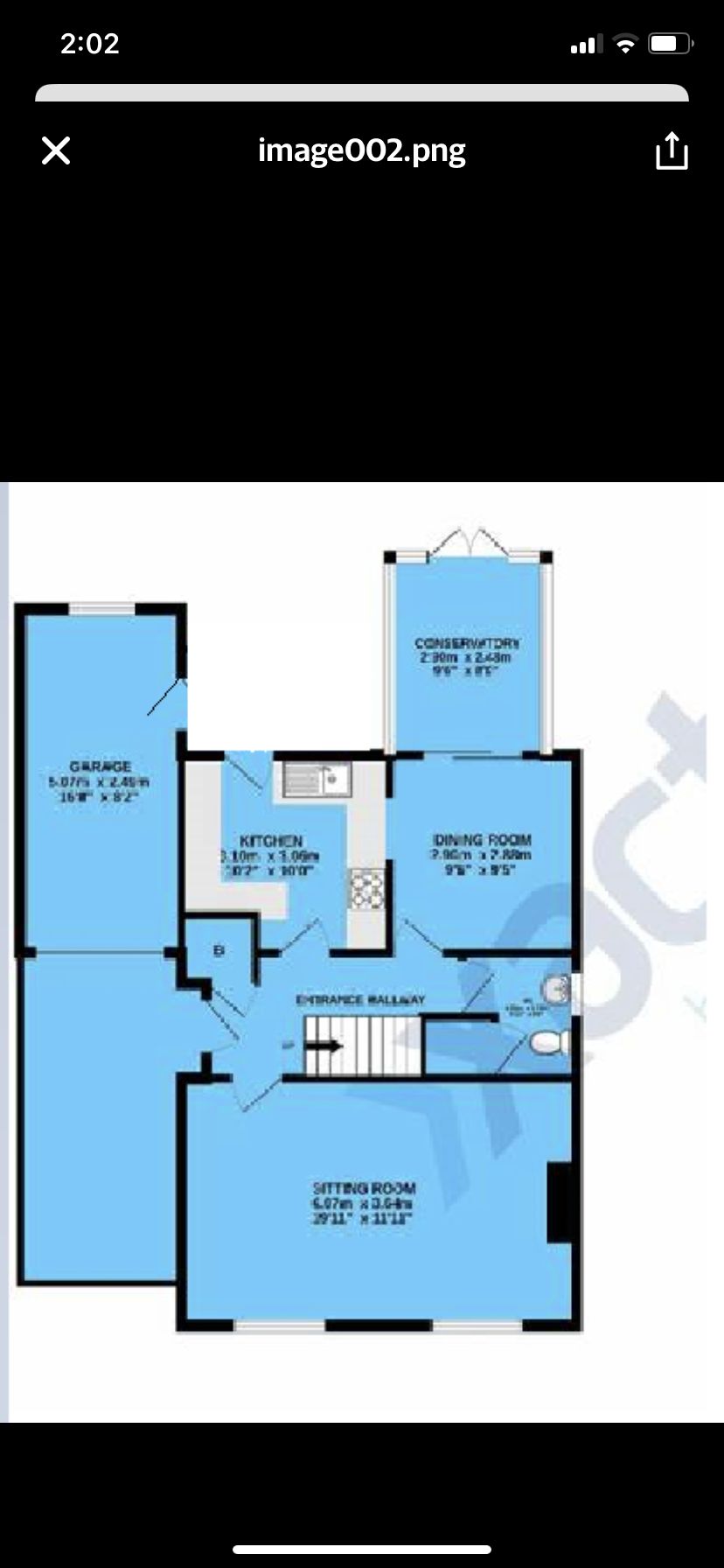

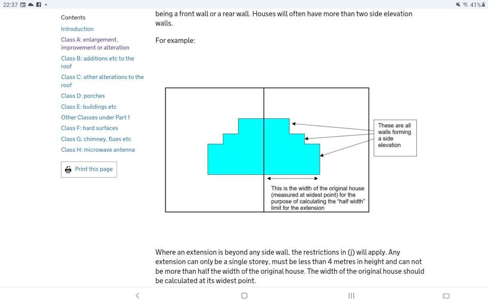

LaurenJ Posted August 13 Share Posted August 13 Hi, Please may I query whether the following proposed extension falls under permitted development rights or whether a full planning application is required. We are looking to complete a rear extension to our detached house by 3 metres, complying with all PD legislations. The house has no existing extensions. The house has an attached garage that spans half of the side of the property and 1.5metres into the rear garden. See below floor plan. Under the techical specification, would the garage form part of the Original Dwelling? (it was built at the same time as the house). Therefore, an extension on the rear of the property (see red below) which would adjoin to the garage would notbe classed as a wrap around extension, as the garage is original? Thanks, Lauren Link to comment Share on other sites More sharing options...

DevilDamo Posted August 13 Share Posted August 13 4 minutes ago, bassanclan said: On what grounds? It also comes off a side wall and the width is more than half the width of the house. Therefore, not PD. 1 Link to comment Share on other sites More sharing options...

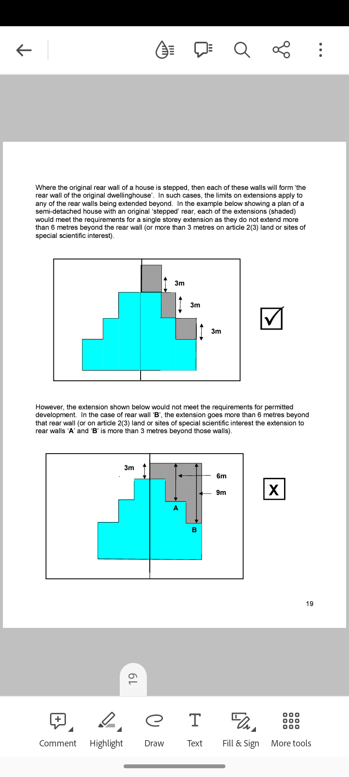

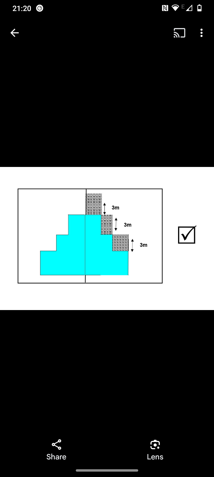

bassanclan Posted August 13 Share Posted August 13 https://www.gov.uk/government/publications/permitted-development-rights-for-householders-technical-guidance/permitted-development-rights-for-householders-technical-guidance#class-a-enlargement-improvement-or-alteration Where the original rear wall of a house is stepped, then each of these walls will form ‘the rear wall of the original dwellinghouse’. In such cases, the limits on extensions apply to any of the rear walls being extended beyond. In the example below showing a plan of a semi-detached house with an original ‘stepped’ rear, each of the extensions (shaded) would meet the requirements for a single storey extension as they do not extend more than 6 metres beyond the rear wall (or more than 3 metres on article 2(3) land or sites of special scientific interest). Looks pretty clearly covered in this technical note 1 1 Link to comment Share on other sites More sharing options...
DevilDamo Posted August 13 Share Posted August 13 @bassanclan You will also note those individual extensions are not greater than half the width of the house, which is why they comply. 1 Link to comment Share on other sites More sharing options...
bassanclan Posted August 13 Share Posted August 13 6 minutes ago, DevilDamo said: @bassanclan You will also note those individual extensions are not greater than half the width of the house, which is why they comply. I am struggling to see the area of the technical guidance that agrees with you 1 Link to comment Share on other sites More sharing options...
DevilDamo Posted August 13 Share Posted August 13 @LaurenJ If you’re adamant in wanting to go down the PD route, you have two options. The width of the extension has to be reduced by approx. half (so it isn’t flush with the right hand side wall). Or you leave a gap between the garage and extension. The latter would then solely be treated as a rear extension without any additional “side extension” PD rules or requirements. If you want this confirmed or clarified, join the “Planning Geek” Facebook group of which the majority of contributors are Planning Consultants. 1 Link to comment Share on other sites More sharing options...
DevilDamo Posted August 13 Share Posted August 13 @bassanclan https://assets.publishing.service.gov.uk/media/5d77afc8e5274a27cdb2c9e9/190910_Tech_Guide_for_publishing.pdf (Page 23). 1 Link to comment Share on other sites More sharing options...
bassanclan Posted August 13 Share Posted August 13 It is not a rear and side extension. It is only a rear extension. The side elevation of the property is the garage. The example on page 27 is more relevant 1 Link to comment Share on other sites More sharing options...
DevilDamo Posted August 13 Share Posted August 13 @bassanclan For somebody who advises and does this for a living, I’m afraid you are incorrect. The extension would infill the gap between a rear and side wall so the rules for rear and side extensions come into play. If you want clarification on that, then ask the question on the Planning Geek Facebook group. Also Page 27 states those extensions are not PD. So I’m not sure how that helps to back up your thought process. 1 Link to comment Share on other sites More sharing options...

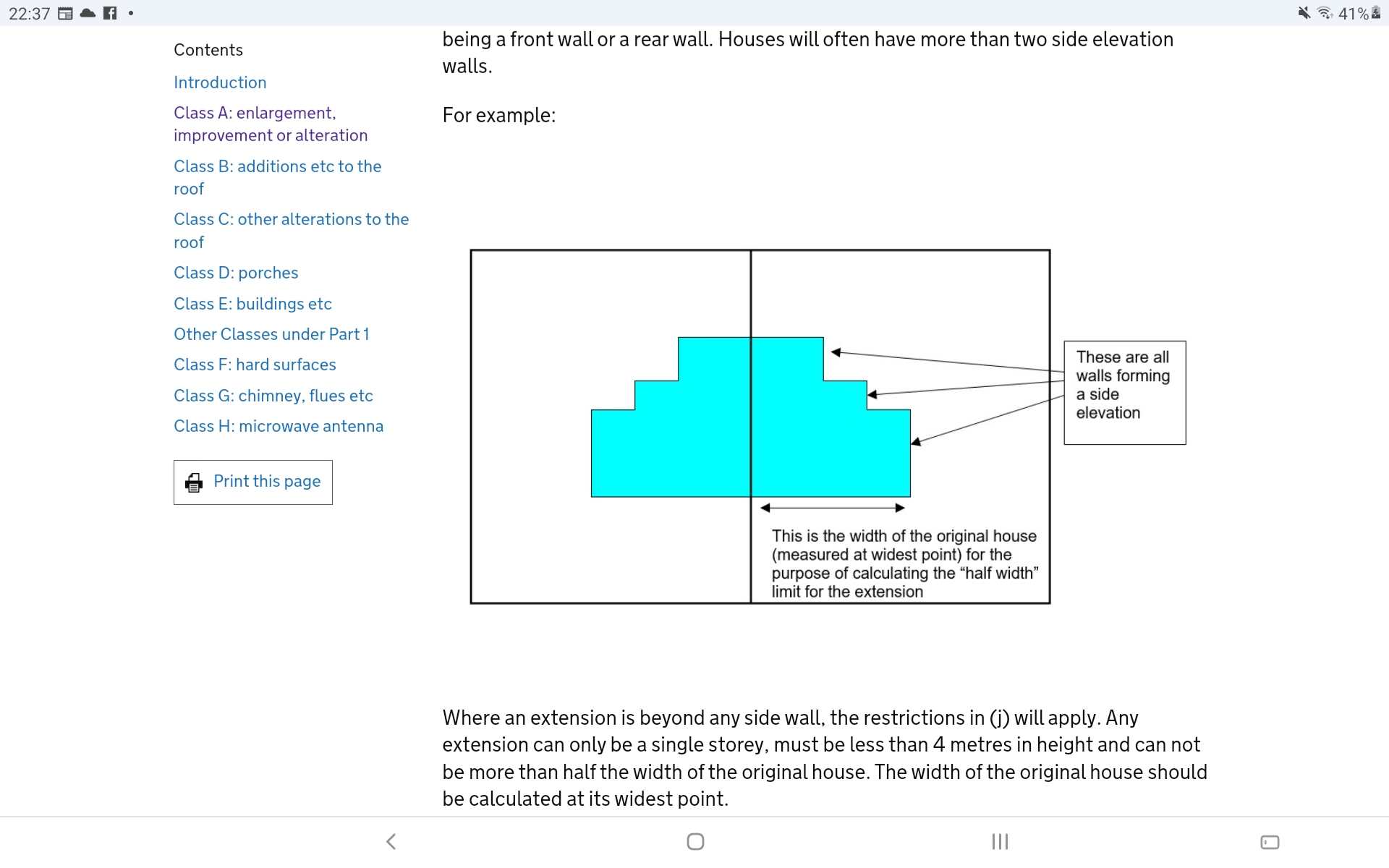

Temp Posted August 14 Share Posted August 14 (edited) 23 hours ago, bassanclan said: It is not a rear and side extension. It is only a rear extension. The side elevation of the property is the garage. The example on page 27 is more relevant If it touches the garage it would be considered both a side and rear extension. The most problematic PD rule is is the one that precludes side extensions being more than half the original width of the house and garage. It looks like yours would be about 2/3rds of the width. I think you will need Planning Permission for that reason. Edited August 14 by Temp 1 1 Link to comment Share on other sites More sharing options...
DevilDamo Posted August 14 Share Posted August 14 (edited) @Temp It’s literally this and the OP’s proposal does not comply with part iii. Edited August 14 by DevilDamo 1 1 Link to comment Share on other sites More sharing options...
bassanclan Posted August 14 Share Posted August 14 Apologies you are correct it will not be permitted development. The side of the garage is considered a side elevation, so it becomes a side extension. The bottom Page 19 seems to be a bit misleading, suggesting that if the extension was only 6m deep instead of 9m it would be permitted development, but it wouldn't. You would definitely get planning permission though, because if the bit of garage sticking out was demolished, you could then extend across the whole width of the rear under PD. Slightly bizarre. 1 1 Link to comment Share on other sites More sharing options...
