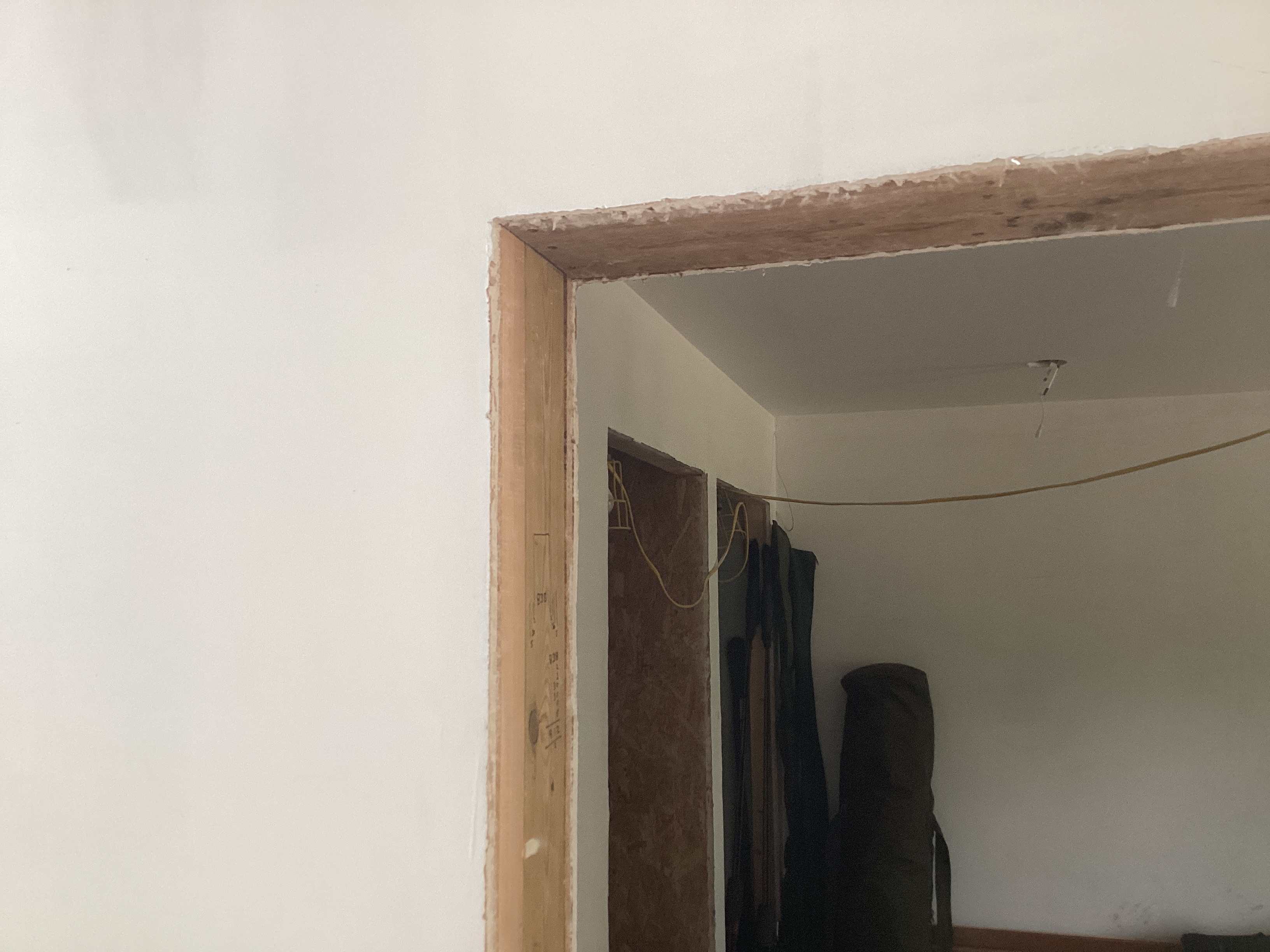

crispy_wafer Posted August 12, 2024 Posted August 12, 2024 Hi All, My plan is to install pre hung doors after plaster and mist coat. I'm just starting to put the odd sheet or two of plasterboard on walls. Would putting in temporary door linings be a reasonable idea? It's a small'ish cost (£20 ea or so from the BM) that I can deal with (11 doorways) to help with plasterboarding and then for the skim coat round doorways?
nod Posted August 12, 2024 Posted August 12, 2024 There’s no point doing this on timber walls But if it’s block Just rip down a 15 mil sheet of ply to the door sizes 1
Russell griffiths Posted August 12, 2024 Posted August 12, 2024 No need just get them skimmed and door linings after 1
crispy_wafer Posted August 12, 2024 Author Posted August 12, 2024 oh, ok, that'd make life a bit easier. Ta.
