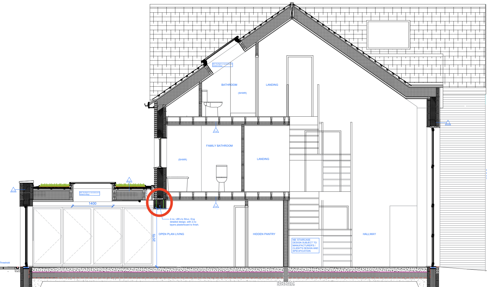

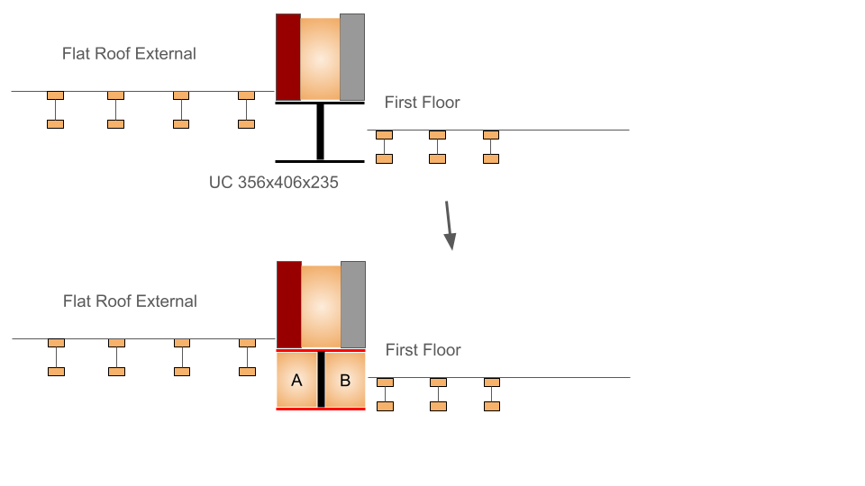

Will be speaking to our architect to get advice, but he's away at the moment and keen to understand what's possible.  We've designed something which requires a fairly large steel to carry the rear of the house where a single story flat roof intersects at the rear.
The smallest height steel we can get is a UC 356x406x235 - spanning about 10meters.  To minimise any boxing in, in the kitchen, we are looking at moving this steel as far up as we can - ideally level with the bottom of the first floor joists.  I'm trying to understand how we insulate the steel and prevent as much thermal bridging. I've drawn a crude diagram of our ideal profile of this beam.  Our cavity is 200mm and the beam is just under 400mm wide so we can presumably pack some insulation into the face of the beam as shown in A and B below.  I assume that we won't be able to do this where the first floor joists run into the beam, and also the top and bottom flange marked in red:
Are there any other options?

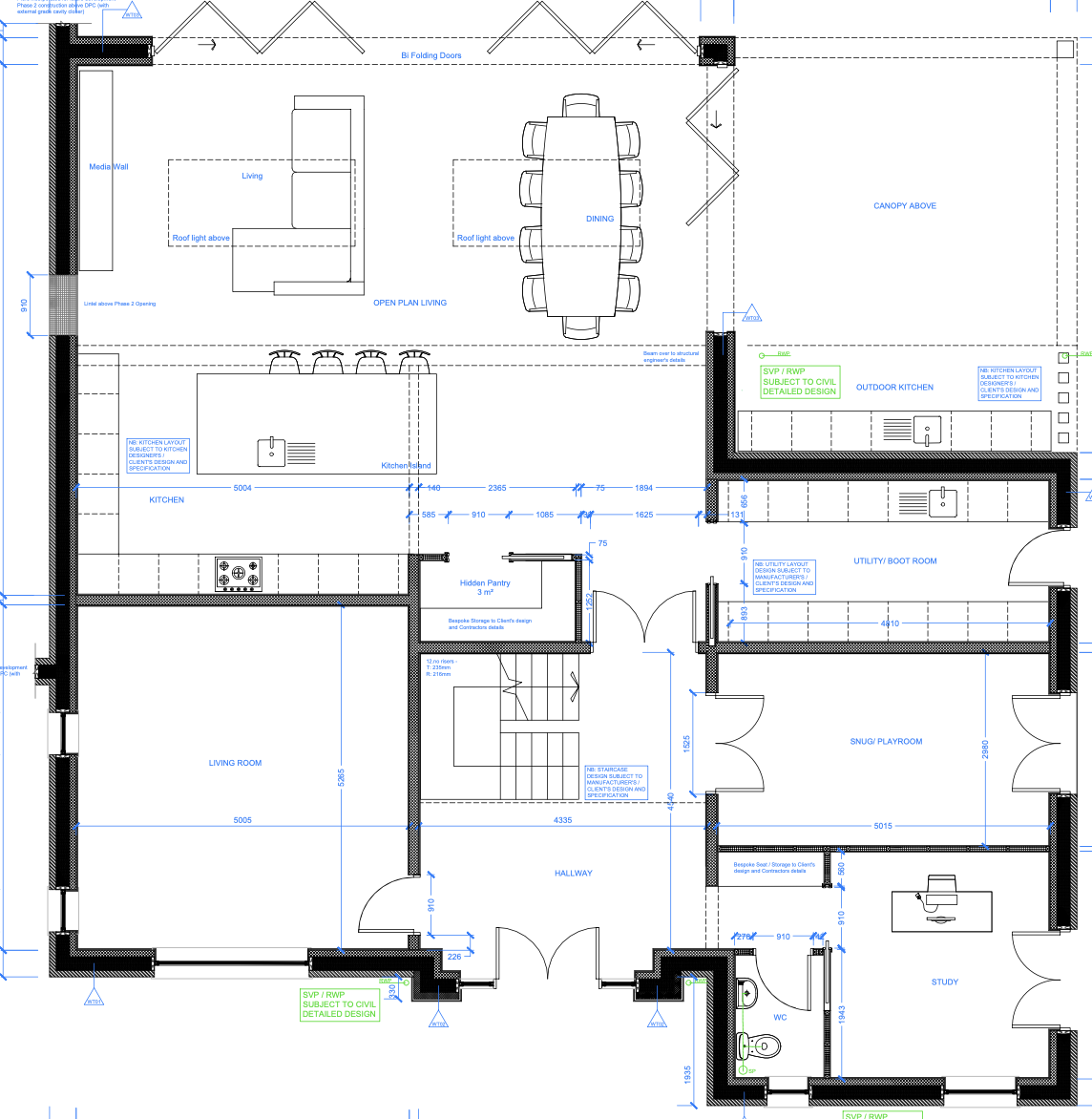

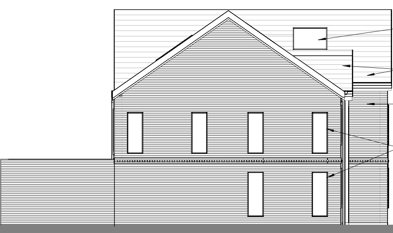

Rear elevation of the house, floorplan, and section drawing with the beam marked in red:

Having re-read my question... is my steel beam entirely within the thermal envelope? Am I worrying over nothing?
Posted
I can’t see any issue in raising it, providing it doesn’t raise above the level of insulation.
It looks like you’re going for a cold roof and if so, what are ventilation details at the parapet, rooflight upstands and wall abutment?
What is that beam being supported on as I assume you have or require some kind of goalpost frame?

We are doing a cellulose full fill so we shouldn’t need a ventilation cavity as long as use a breathable membrane.
You’re correct, the beam is on steel columns down to foundations.
Posted
Flat roof needs redesigning, cannot fully fill the joist void with insulation!! Correct insulation to flat roof and packing void between 1st joist and steel insulation marked ‘A’ should minimise thermal bridge.

Won’t comply with relevant BSs or Building Regs. Architect should know this. In a cold roof 50mm cross ventilated void is required above the insulation, can’t see how this can done here. Warm roof is the best (only) option.

Thanks @ADLIan  I can see your point especially with the wall junction. What would one typically recommmend as a makeup to achieve a circa 0.12 u value? Can you insulate between the joists with rockwool
and then above with PIR for a warm roof?

Correct, warm roofs do not require venting. You’d have to carry out a u-value calculation but as an example, 150mm of Celotex on top achieves 0.15.
