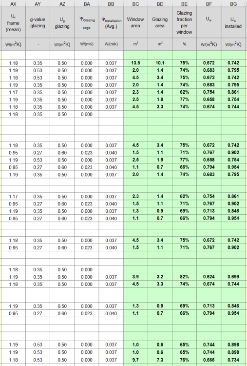

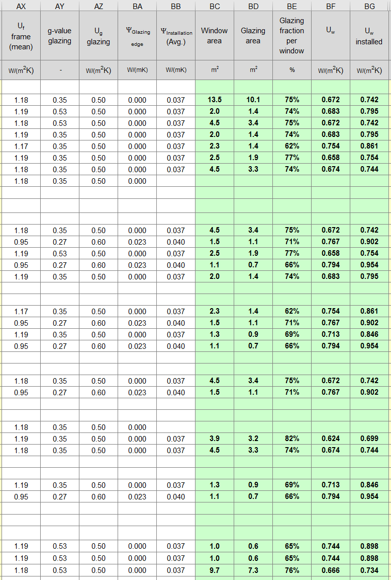

Alan Ambrose Posted July 26, 2024 Share Posted July 26, 2024 (edited) OK here's a few numbers - from my window schedule in PHPP nominally using Rationel Auraplus & Velux. S/W/E windows using Rationel Sun SKN176; N wndows using Rationel Auraplus 4/20/4/20/4; Veluxes using Velux Heat Protection Glazing 69: Average Uframe=1.132, Uglazing=0.522, Uwindow=0.712, Uinstalled=0.822 If I change all the glass for better stuff with 90% of the U-value (e.g. 0.5 glass becomes 0.45 glass etc), the numbers become: Average Uframe=1.132, Uglazing=0.470, Uwindow=0.675, Uinstalled=0.785 So, sounds like the Uwindow/Uglazing factor (the discrete derivative? ) might be around (0.712-0.675)/(0.5-0.45) i.e. 74%. Hope that helps . I guess you can also sometimes get this from the window frame supplier's various double/triple glazed offerings - if you believe their numbers... You can play these type of games fairly easily by mangling PHPP if you choose to. Edited July 26, 2024 by Alan Ambrose 1 Link to comment Share on other sites More sharing options...
G and J Posted July 26, 2024 Share Posted July 26, 2024 5 hours ago, Alan Ambrose said: Average Uframe=1.132, Uglazing=0.522, Uwindow=0.712, Uinstalled=0.822 So, an installed window with a total of 1m2 showing (frame and glass) would lose 0.712W for each degree in temperature difference. I’m assuming Uwindow means the overall u value of the window when it’s installed. if Z fraction of the window is glass then: (Z x 0.522) + ((1 - Z) x 1.132) = 0.712 Therefore: (Z x 0.522) + 1.132 - (Z x 1.132) = 0.712 so…. Z x (0.522 - 1.132] = 0.712 - 1.132 = -0.42 thus…. Z = -0.42 / -0.61 = 0.689 AKA 68.9% 5 hours ago, Alan Ambrose said: Average Uframe=1.132, Uglazing=0.470, Uwindow=0.675, Uinstalled=0.785 therefore : 0.689 * 0.470 + (1 - 0.689) * 1.132 = 0.32383 + 0.3521 = 0.676. Wow. I did it! Do I get a sweety? Link to comment Share on other sites More sharing options...
Alan Ambrose Posted July 26, 2024 Share Posted July 26, 2024 >>> Do I get a sweety? Certainly for effort . Well yes, given the data you were given, you're right. PHPP, for my windows, says Z is between 62% and 82% with an average of 71%. Not sure where the discrepancy is - I guess I was giving averages over a bunch of windows, so that's it. Link to comment Share on other sites More sharing options...
