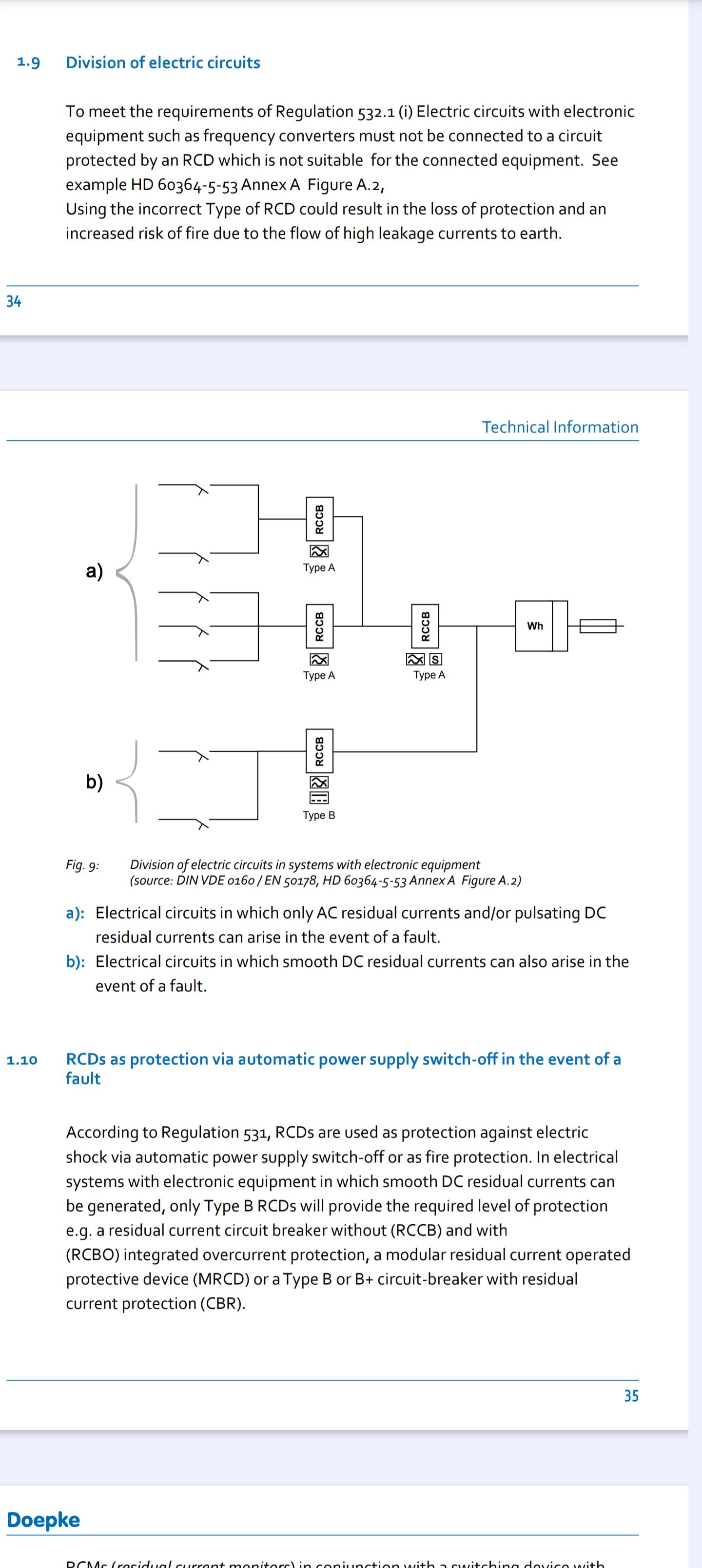

JohnMo Posted July 21 Share Posted July 21 Also found this in their technical guide. This requirement may be driving the additional CU so the heat pump can have a Type B RCD and the rest of the house etc a Type A. Link to comment Share on other sites More sharing options...

JamesPa Posted July 21 Share Posted July 21 3 hours ago, JohnMo said: Also found this in their technical guide. This requirement may be driving the additional CU so the heat pump can have a Type B RCD and the rest of the house etc a Type A. Makes sense. Does this sentence from your previous post suggest its a matter for the HP manufacturer to specify? "The characteristics of the HP inverter, and the location of the fault within the equipment, determine the characteristics of the residual current. The selection of the Type of RCD must consider the fault current scenarios identified in the standards and by the HP manufacturer, in their design risk assessment documentation. Electrical installers do not have access to the HP manufacturer’s inverter design characteristics and consequently cannot make the decision to use Type F in place of Type B, without the agreement of the HP manufacturer." Link to comment Share on other sites More sharing options...
