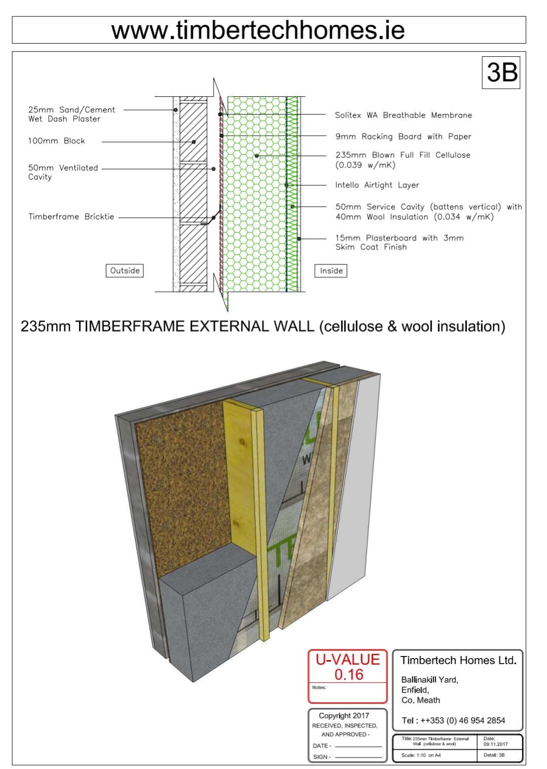

Iceverge Posted July 16, 2024 Share Posted July 16, 2024 Timber can work very well in tandem with blown cellulose because it fills all airpaths. Airpaths are critical. For instance it's very hard to get good soundproofing on an interior wall with a door no matter how you build it Cellulose is a relatively dense insulator too at about 60kg/m³ installed. However insulation is a dear way of adding mass (although Rockwool et al will push this angle) Concrete blocks, plasterboard and OSB are all cheaper. Decoupling can be done by a cavity wall but you really need wet plaster with a masonry build for maximum airtighess vs the dreaded dot and dab. A masonry leaf on a timber frame will have the same effect. A layer of fluffy insulation somewhere is good too to stop sound "echoing" through the structure. Mineral wool batts in a wall work well. Better than something like EPS beads. In truth though it's probably your windows and doors that are the weakest link. Get proper triple sealed triple glazed windows that are thermally broken. Install with a flexible seal to the external rainscreen and an airtight one to the continuous airtighess layer. Don't neglect to treat the windows jambs, sills and heads with care too. Add plenty mass in the shape of a thick layer of plasterboard and skim and ensure all connections to the frame are continuous and permanently flexible. Link to comment Share on other sites More sharing options...
spxy1 Posted July 16, 2024 Author Share Posted July 16, 2024 Thanks for all the replies they are helpful already. Have not thought of Cellulose insulation will have a look into and see. Again not thought about mixed masonry and timber wall. I assume the masonry wall is on the outside? Link to comment Share on other sites More sharing options...
Iceverge Posted July 16, 2024 Share Posted July 16, 2024 Yes masonry on the outside. Here's a drawing. Link to comment Share on other sites More sharing options...
