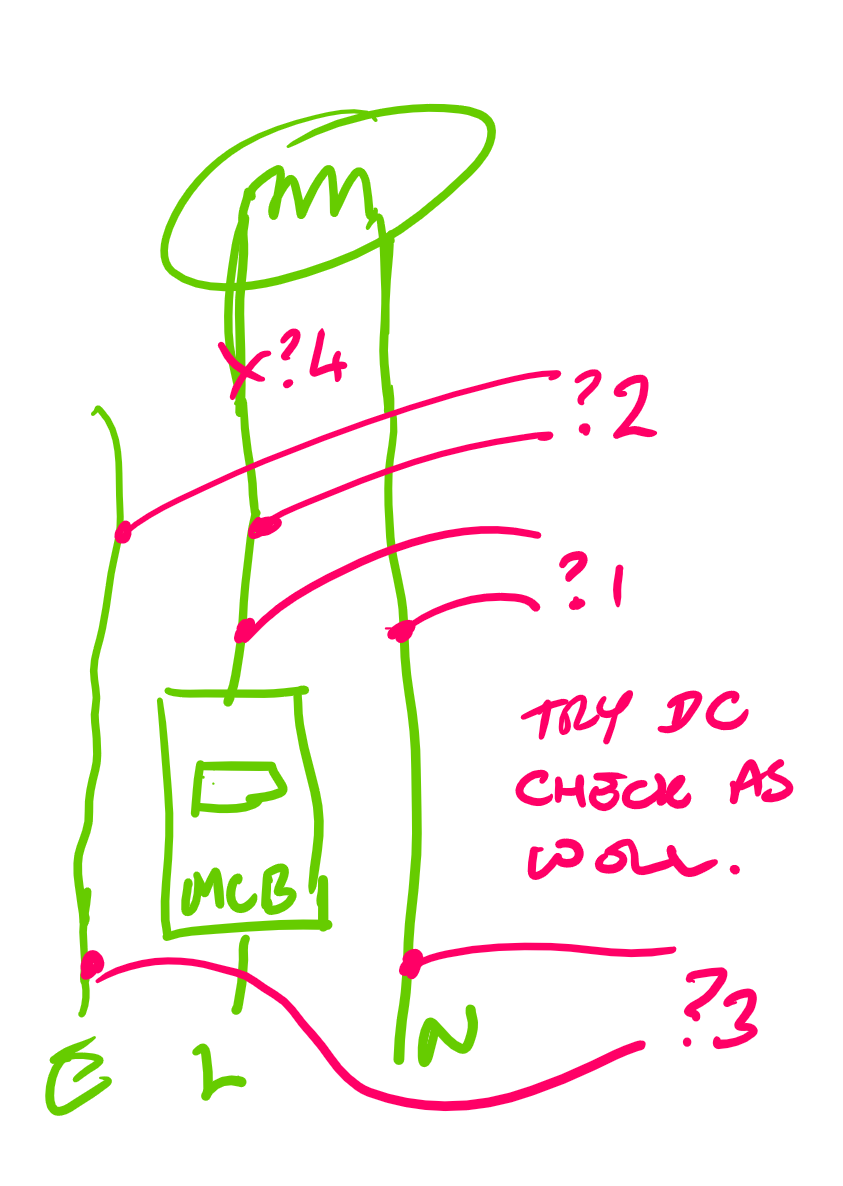

Why does it read 10V when it's off?
We have a lighting circuit running through a 6A MCB. It has a junction box connecting just two cables which are supply cables. When the MCB is on it's reading around 239V and when the MCB is off, it reads 10V. Is that acceptable or should I be looking for some sort of fault?

It is not fool proof but perhaps test a couple of places WITH THE MCB OFF, the meter on 600V range and with safely insulated probes - see dia below, ?1 = what I think you are doing plus also try ?2 and ?3 to see if the neutral has got away from earth. Disconnect any lamps - ?4 as modern LED and tubes have electronics in them which may be charging, and try the voltage test on the DC range as well as AC to see if anything odd is out there. If it goes away when you disconnect the lamps then its coming from / via them somehow and you might be able to spot where the problem is given the 1,2 & 3 tests at both AC and DC.

A couple of other easy tests to do:
+ Switch off the MCB and leave for 10 mins or so. If the 10V goes away, then it was likely just charge being held in some LED power supplies or similar.
+ If possible, turn the whole consumer unit off and see whether the 10V goes away. If so, there might be some cross connection e.g. on the neutrals, between circuits.
>>> the other circuit connecting to the junction box was removed some time ago
I might also be inclined to double check whether this was fully disconnected. Know what that circuit was used for?

Probably ‘ghost voltage’ being induced from other circuits the cabling for your circuit runs alongside. Impossible to say for sure without looking at it though

@Alan Ambrose , @MikeSharp01 , @Mattg4321 , @MJNewton , thanks for the replies. I have carried out the various tests after leaving it off for half an hour. When MCB switched off L/N = 9V, L/E = 9V, N/E = 0V. Turned the whole CU off and L/N = 0V. So my conclusion is that, it is, as suggested 'ghost voltage'. Every day is a school day.

>>> ghost voltage
I'm thinking it could also be a crossed neutral. You have RCDs in that consumer unit?
Another simple test - turn CU on and all MCBs off. Your stray voltage should be zero. Turn the MCBs on one-by-one leaving your suspect circuit til last. See when the ghost voltage turns up.
