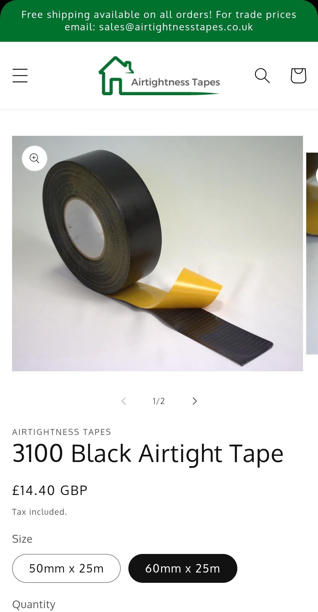

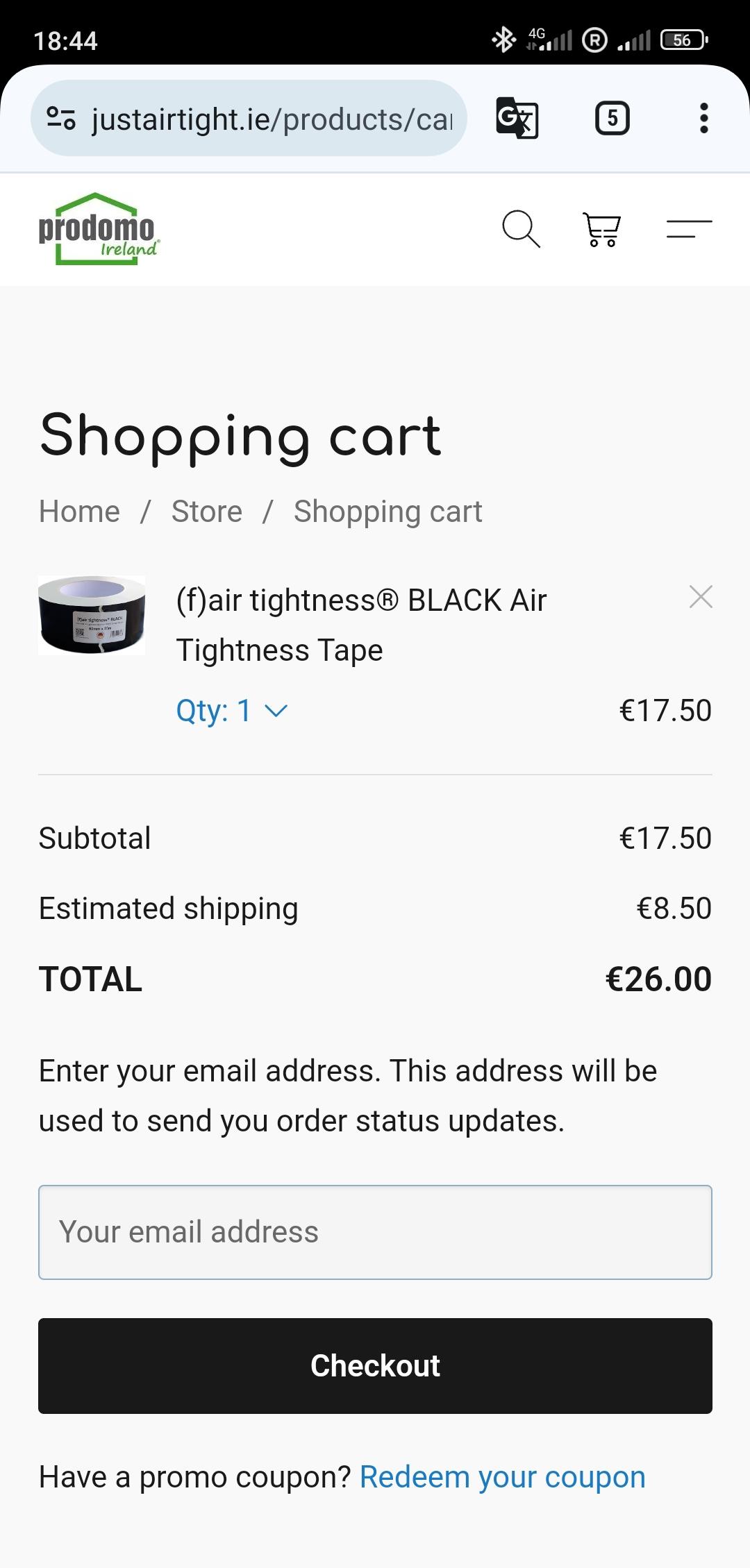

Barny Posted July 16, 2024 Share Posted July 16, 2024 Hi can anyone recommend ducting insulation and airtight tape brands / suppliers for a passivhaus? Ideally, cost effective ones? Our architect has given brand names but I can’t find them for sale in this country. I think the world of insulation and tapes and moved on (EPS definitely has) but my architect is still using his little book for 5 years ago. thanks Link to comment Share on other sites More sharing options...

Iceverge Posted July 16, 2024 Share Posted July 16, 2024 This is what we used. Don't know if they ship to the UK though. I was very impressed, better than the more expensive brands I bought. This one below looks similar but I have never tried it. Might be worth a punt on one roll to try. Link to comment Share on other sites More sharing options...
