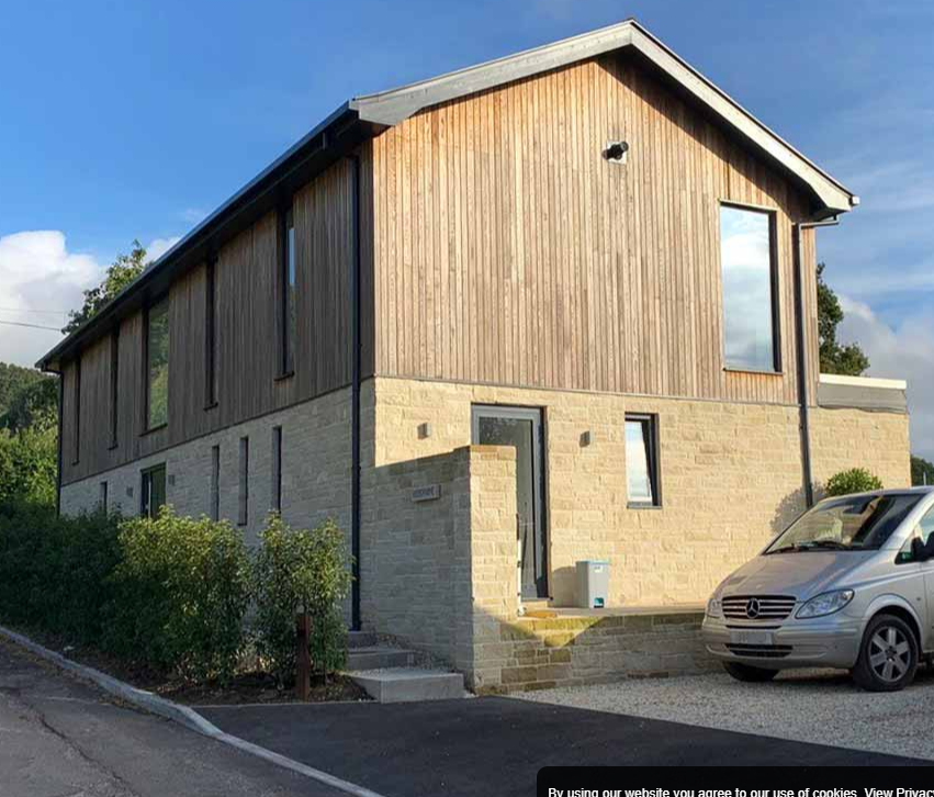

flanagaj Posted July 13, 2024 Posted July 13, 2024 So our proposed design that we want to submit to the planners will be something along the lines of the below, but with a back to front sloping seam sealed roof (minimum pitch for solar panels). What I really like is the way the cladding and the stonework are at the same level on the vertical. If you were to a traditional structure with brick / cavity / block and then counter batten the upper section for the cladding, the cladding would project ~ 70mm proud of the stone, so I am unsure what construction methodology you would need to use? If anyone has a cross section diagram explaining how you achieve this to meet/exceed current building regs, could you please post. Thanks
DevilDamo Posted July 13, 2024 Posted July 13, 2024 Timber frame on top of a cavity wall in which you could increase the ground floor internal blocks and/or cavity to suit. 1
JohnMo Posted July 13, 2024 Posted July 13, 2024 Any would do the job Use what ever method is normal for your area, then trades are easy to get. 2
