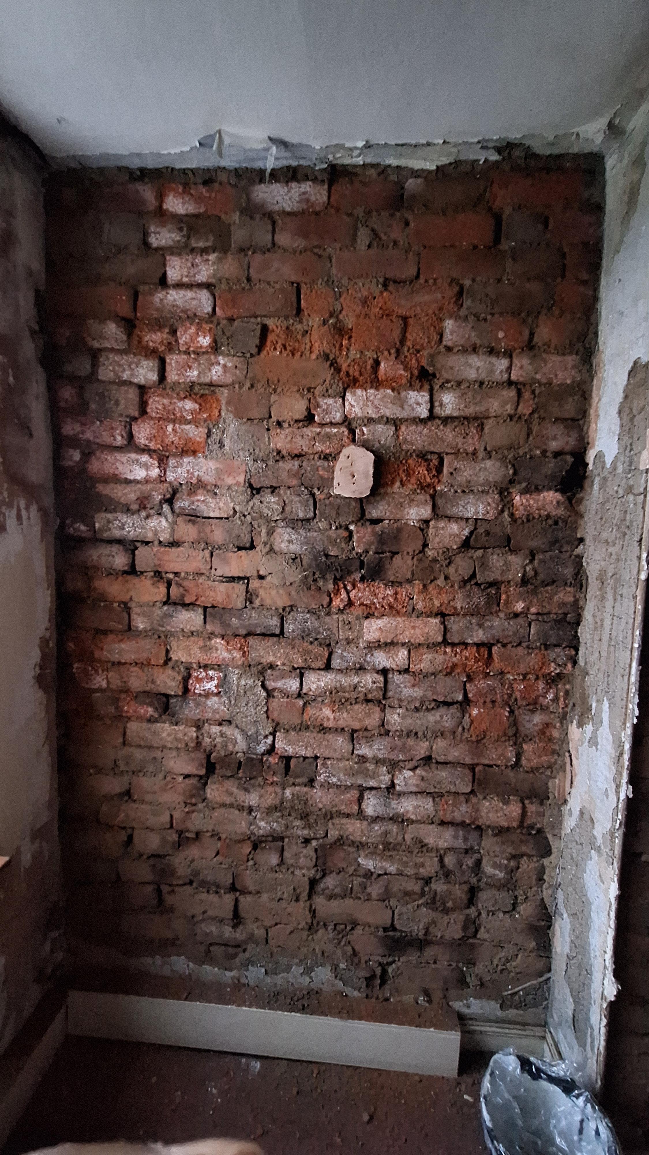

Krishna24 Posted July 12 Share Posted July 12 Hi, Recently, I bought house and found it has penetration damp on gable end. As far as my investigation goes. Source of the damp is faulty points. I have removed all plaster from the wall. Practically. I am down to original brick. I am planning to put insulated plaster board with moisture barrier. Do you think I should be mindful before applying insulated plasterboard. If yes, what kind of treatment should I do. last question, It's a solid brick wall and had paint before I bought the house. Now I found that solid wall suppose to breath. If the breathability issue comes then it will start the problem. So, I don't want to leave the wall as it is after repoint. So, what kind of paint I should use? Thanks for reading my query. Cheers! Link to comment Share on other sites More sharing options...

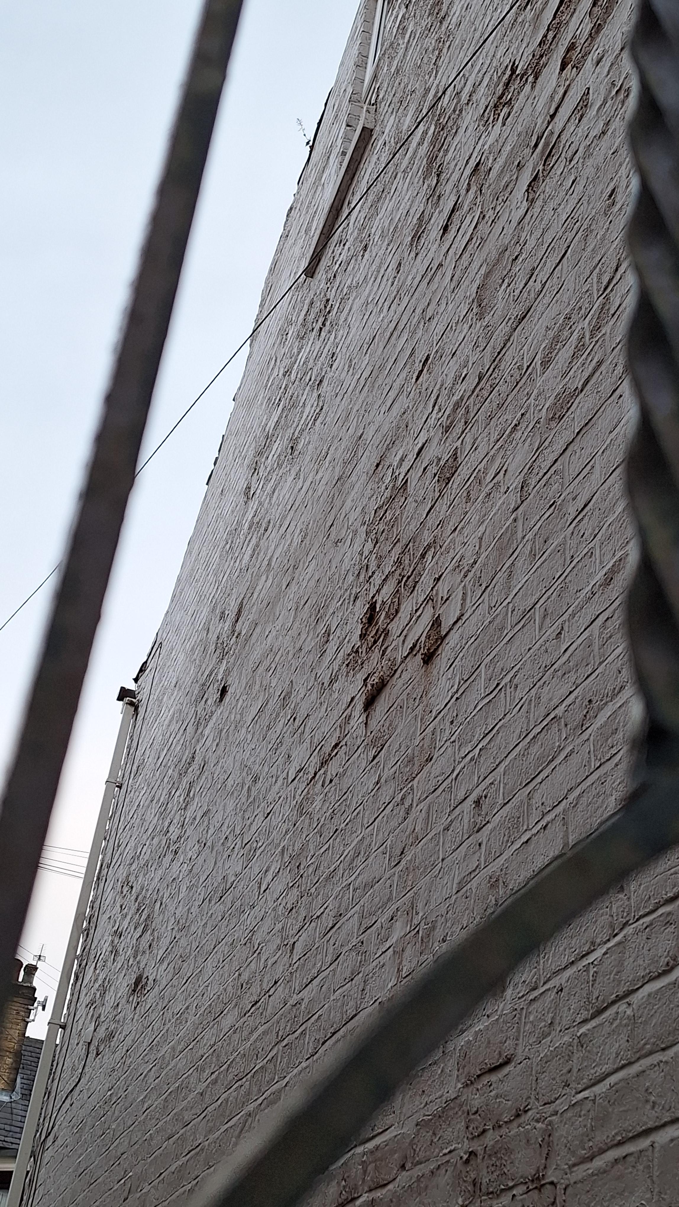

Krishna24 Posted July 14 Author Share Posted July 14 Here are some pictures of the internal and external wall. When I bought the house, each wall had wallpapers and these wall paper were quite thick. After investigation I realise points has gone through first floor. So, whenever it's raining and have wind water is penetrating through. Now, I m bit confused regarding putting a layer of masonry paint. Gable end had paint and can see the some places face of the brick has blow. From research I found that it only happens when. Wall is anablw to breath and moisture is trapped. Do you think I should apply any masonry paint on gable end to stop water going through? If yes what would be the best option. Ofcouse I would prefer wall to breath. Last question, what treatment I should do before plasterboarding the wall? Thanks Link to comment Share on other sites More sharing options...

Mike Posted July 15 Share Posted July 15 18 hours ago, Krishna24 said: Do you think I should apply any masonry paint on gable end to stop water going through? I'd use either or a lime render, preferably over external insulation (but stopping short of the DPC, if there is one), or a vapour-permiable masonry paint, or both. I'd strip the existing masonry paint first, though that may not be easy. Try a paint stripper, or get in a specialist to steam it off. 18 hours ago, Krishna24 said: what treatment I should do before plasterboarding the wall? Internally, nothing - just let it dry out for as long as you can. Then vapour-permiable insulation (if you can't insulate externally) + lime plaster + vapour permeable paint. Link to comment Share on other sites More sharing options...
Redbeard Posted July 15 Share Posted July 15 20 hours ago, Krishna24 said: Last question, what treatment I should do before plasterboarding the wall? Don't plasterboard it! Lime plaster. +1 for external wall insulation, though you will have to build a 'gable ladder' to extend the roof line. Link to comment Share on other sites More sharing options...
Krishna24 Posted July 16 Author Share Posted July 16 Mike, external wall insulation is out of question for now (too expensive). What kind of vapor permeable masonry paint I should use. Any recommendations of website or brand. Thanks Link to comment Share on other sites More sharing options...
Mike Posted July 16 Share Posted July 16 3 hours ago, Krishna24 said: What kind of vapor permeable masonry paint I should use. Any recommendations of website or brand. I don't recall what I last used, but Mapei Silancolor and Emperor would be on my shortlist. By the way, if you do end up painting direct to the wall, remove the point by steam, not paint stripper - you don't want any residue to strip off the new paint. 3 hours ago, Krishna24 said: external wall insulation is out of question for now (too expensive) I guess there's a small chance that a new grant/subsidy scheme may turn up now there's a new Government. Possibly worth handing on a few months just in case? Link to comment Share on other sites More sharing options...
