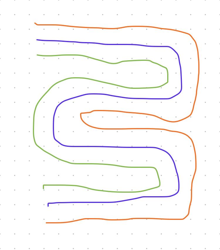

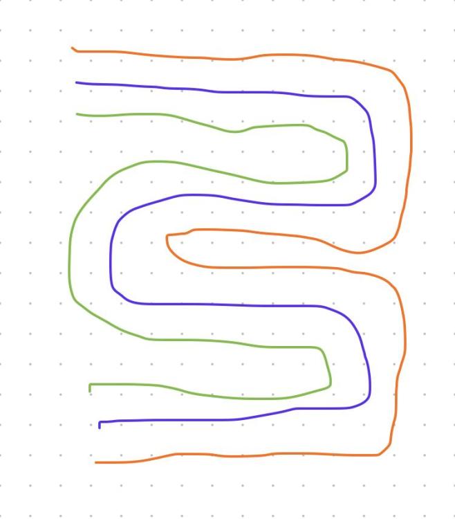

As I think through many different aspects of our forthcoming build few worry me as much as the potential damage to underfloor heating pipes awaiting a protective screed.
Presumably almost all such installations survive being trodden on by the guys laying the screed so I simply needn’t worry so much?  Or are there steps one can take to reduce the risk of damage?

We’re aiming at nicely airtight but wall thickness precludes that level of insulation. However with some psychedelic pipe laying maybe redundancy can be effectively achieved….
I wouldn't overthink it. Those pipes are very hard to damage by walking over them and the like. Obviously try not to drill into it.
To put your mind at ease you could try getting some leftover UFH pipes on marketplace, eBay, that you could try to 'destroy' as an experiment.
