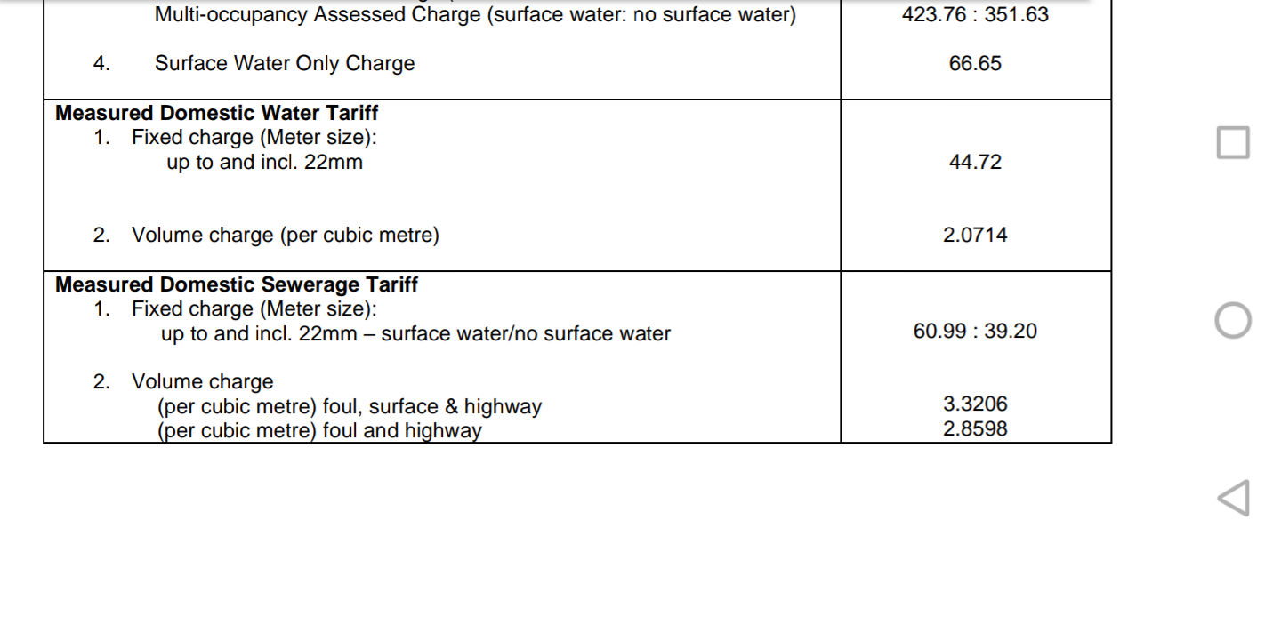

saveasteading Posted July 3 Share Posted July 3 21 hours ago, SteamyTea said: Water a couple of quid, waste over 6 quid. the waste quantity will be measured as your water purchase quantity. 32 minutes ago, Hastings said: Normally 200L/day/person is required That is all water. Rainwater won't be used in the kitchen or basins/bath/shower. Are you sure about 1.3m annually. I saw the weather forecast last night and it looked like 100mm was on its way. Use the met office figures not the tourist board. Joking...don't tell us more or we will work out your location. Link to comment Share on other sites More sharing options...
SteamyTea Posted July 3 Author Share Posted July 3 29 minutes ago, saveasteading said: 22 hours ago, SteamyTea said: Water a couple of quid, waste over 6 quid. the waste quantity will be measured as your water purchase quantity Yes, but not legal, and certainly immoral to not pay for waste. Link to comment Share on other sites More sharing options...
Hastings Posted July 3 Share Posted July 3 (edited) 31 minutes ago, saveasteading said: That is all water. Rainwater won't be used in the kitchen or basins/bath/shower. Are you sure about 1.3m annually. Yes, 1.3m annual, Met Office data. Low lying islands are quite a bit dryer than mainland A&Bute. Rainwater will be used in the kitchen, basins, shower. Just trying to point out in this discussion that any roof design for water collection can only, for the vast majority of UK housing, be a partial solution and therefore unlikely to be cost effective. Unless the law is updated to allow householders to use much less if they want. Edited July 3 by Hastings 1 Link to comment Share on other sites More sharing options...
saveasteading Posted July 3 Share Posted July 3 4 minutes ago, Hastings said: a partial solution I agree. One of the harvesters I put in was turned off by the tenant. I am now having trouble getting someone to replace the pump, as the manufacturer seems to have dropped out of the market.....because it is a small market. Why am I interested still? Because there must be a way forward. But it probably needs joined up thinking, without it being frustrated by the big house-builders. Hence my 'best advice' must be to use water butts and /or a tank for the garden and, if space allows, lose the rest honestly in the ground. When your 1.3m is falling, just think how clean the ground and the air are, unlike the big smoke with pollution and shortage of water. Link to comment Share on other sites More sharing options...
saveasteading Posted July 3 Share Posted July 3 12 minutes ago, SteamyTea said: Yes, but not legal, and certainly immoral to not pay for waste. I was genuinely thinking that is what they do, and it is their chosen method. So how do they quantify the sewage? Link to comment Share on other sites More sharing options...
SteamyTea Posted July 3 Author Share Posted July 3 10 minutes ago, saveasteading said: So how do they quantify the sewage Based on 95% of potable water usage. Then some formula for that incorporates the surface and highways. While it may be a bit hard to find out if one individual is gaming the system, other than through unexpected reduced usage, if a few people on a main sewer did it, then I suspect it would trip a warning. Flow rates in sewers are measured as they need to manage unexpected discharged to the sea/rivers. When a neighbour put a bag of cement down the drain, SW Water sorted the problem very quickly, they did the same when the manhole cover collapsed on my local waste pipe (serves 6 houses). As much as I dislike paying over 8 quid a cubic metre for water, it is really very cheap considering the quality delivered, and what is involved in cleaning it up. There are not many things that can be delivered at £2/tonne to your door, and that are good enough to drink, and who would take away 950 kg of my wee and poo for £6/tonne and dispose of it safely. 1 Link to comment Share on other sites More sharing options...
