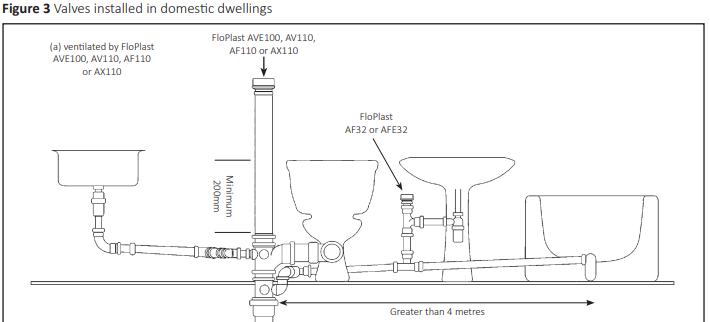

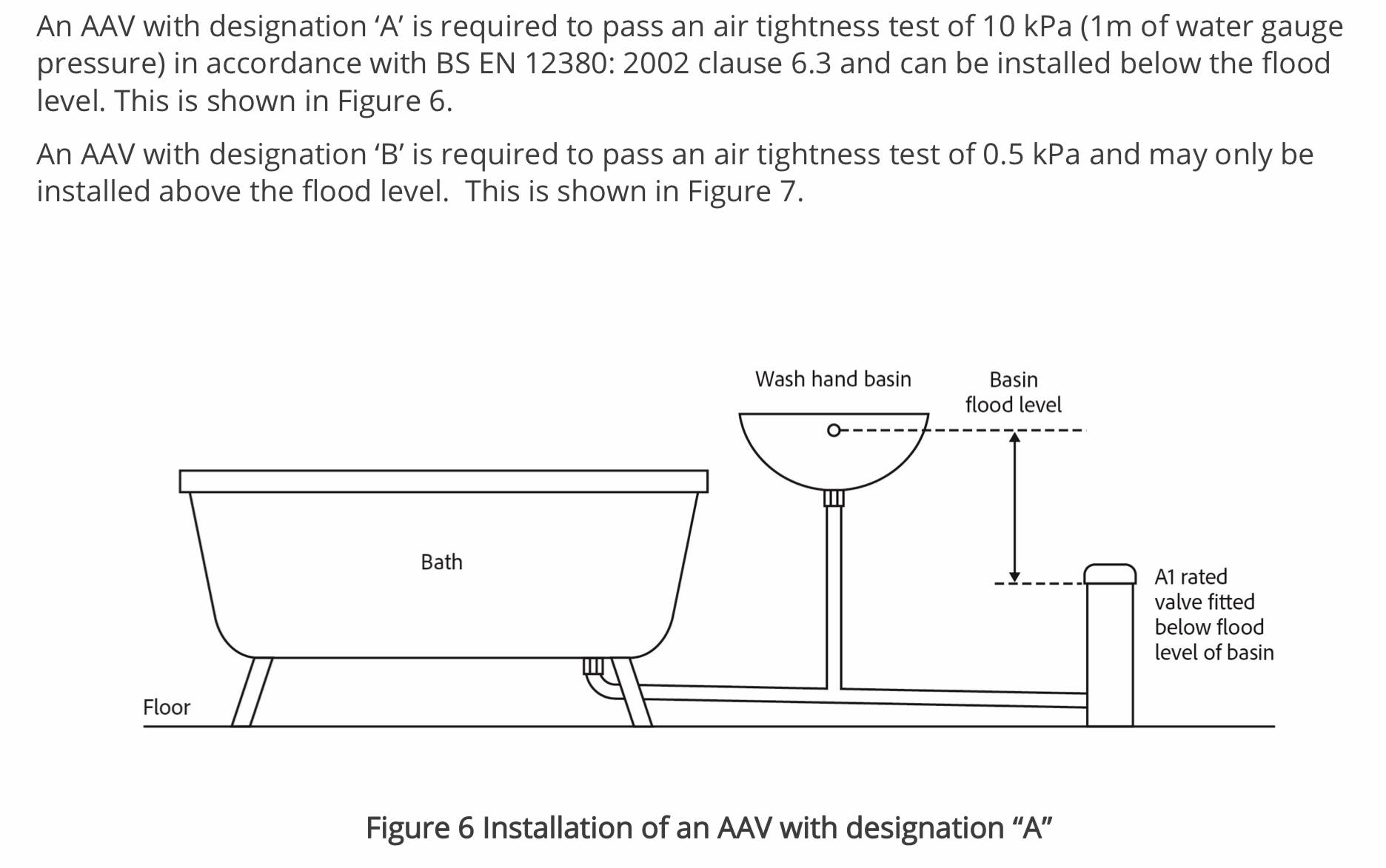

MortarThePoint Posted June 22 Author Share Posted June 22 Thanks @Marvin That is guidance for Polyvalve which may not be a A1 rated which apparently does allow installation below the spill-over level. See below from Floplast. Annoyingly, their picture doesn't actually show it lower than the basin, but the Minimum 200mm and text makes it reasonably clear. Even if it is an OK approach, I would still have to convince the BCO though. "11.5 FloPlast AVE100, AV110, AF110 and AX110 valves must be fitted in a vertical position 200 mm above the highest branch connection (see Figure 3). As FloPlast valves are A1 designated to BS EN 12380-1: 2002 it is possible to locate them below the lowest reservoir being vented." "1.8 FloPlast AAV’s are designated A1 in accordance with BS EN 12380: 2002 and can be fitted below the flood level of connected appliances, in air temperatures between -20°C and 60°C." https://www.floplast.co.uk/uploads/related-documents/BUsohExhe3Mqhq6jYrAqs9kLySHpgjrtGe5hGvjo.pdf Link to comment Share on other sites More sharing options...
MortarThePoint Posted June 23 Author Share Posted June 23 (edited) It's occurred to me that the shower wouldn't be an overflow point as its trap will probably have a non-return valve. I think I'd want the AAV to be higher than the bath's plug hole [1] and probably higher than the toilet pan's rim [2]. [1] The basin joins the same branch as the bath that then joins the stack below the toilets branch. I think that means the basin can't overflow the AAV without already starting to fill the bath. [2] A blockage between where the basin branch joins the stack and the toilets branch joining the stack would overflow the toilet pan before reaching the level of the AAV. Edited June 23 by MortarThePoint Link to comment Share on other sites More sharing options...

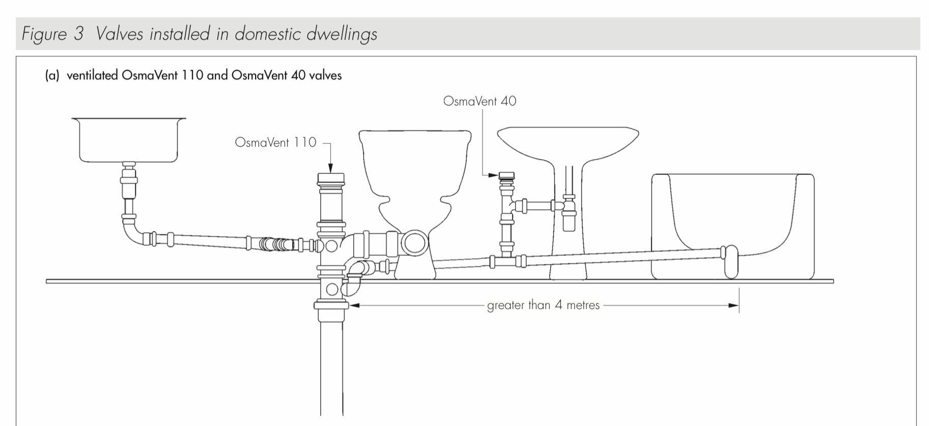

Nick Laslett Posted June 23 Share Posted June 23 (edited) @MortarThePoint I used the Wavin Osma AAV 4S306, which is A2 rated. However the 4S304 appears to be able to be installed below spillover level. https://www.wolseley.co.uk/wcsstore/ExtendedSitesCatalogAssetStore/images/products/AssetPush/DTP_AssetPushHighRes/std.lang.all/ti/on/Wavin_Osma_Soil-Waste_Installation.pdf Quote When used to vent a stub stack, 110mm Air Admittance Valve 4S304 can be located 200mm above the highest branch. The Air Admittance Valve 4S306 must be installed above spillover level of highest appliance. *Edit Just had a looked at the BBA cert for the Wavin Osma AAV 4S304, this gives very clear guidance on installation location. Added another pic. https://wavin-digital-indianajones-prod.storage.googleapis.com/assets/category/1520297e-f72b-4c71-9b89-dc027056ec87/d3c79907-6216-49e4-b861-3f792432bcdc/2b939e03-ca09-4297-8f3b-828b5b200e22 The British Plastics Foundation have a good guide on AAV https://www.bpfpipesgroup.com/media/71872/Air-admittance-valves-for-domestic-properties-v2-Jan-2024.pdf Edited June 23 by Nick Laslett 1 Link to comment Share on other sites More sharing options...
