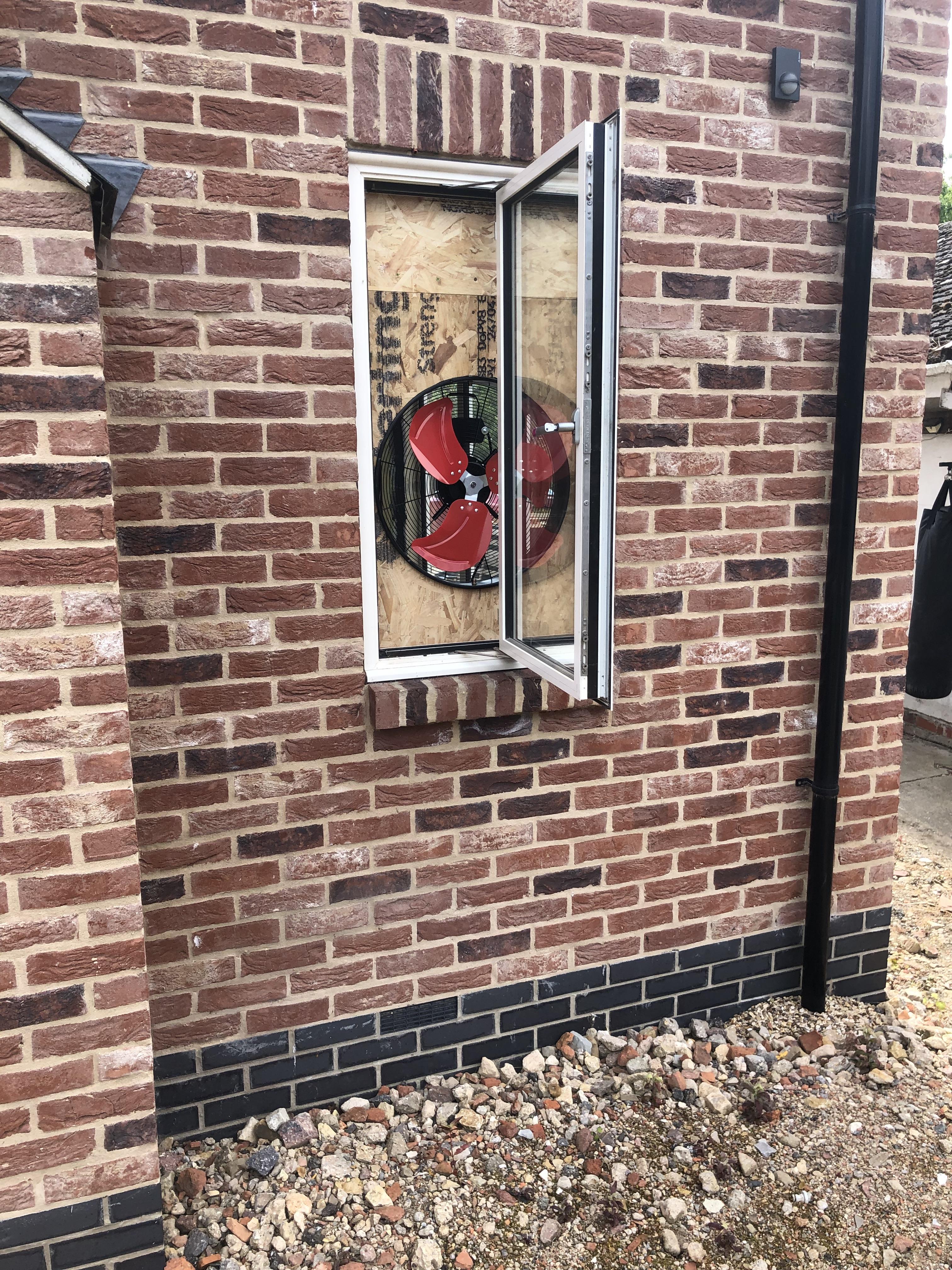

There've been discussions on here doing this with a scrap electric radiator fan.
Mount it to a frame, add a flexible surround (that you can tape to a window or a door), 12 V power supply (ideally variable), and a pressure guage, and you're set.
I’ve done this before, and have a set of recommended parts - links below to a suitable fan, power supply, and differential pressure sensor, total under £200.  You can halve that cost by using a car battery charger and no measurement.

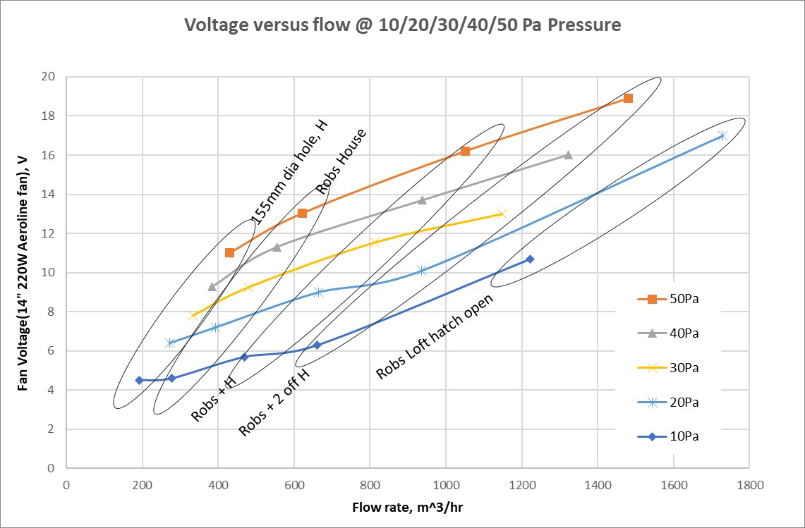

Using those parts, I got the flow versus voltage and pressure relationship below.  Of course, it won’t be super accurate - but what do you expect for £200 of bits?

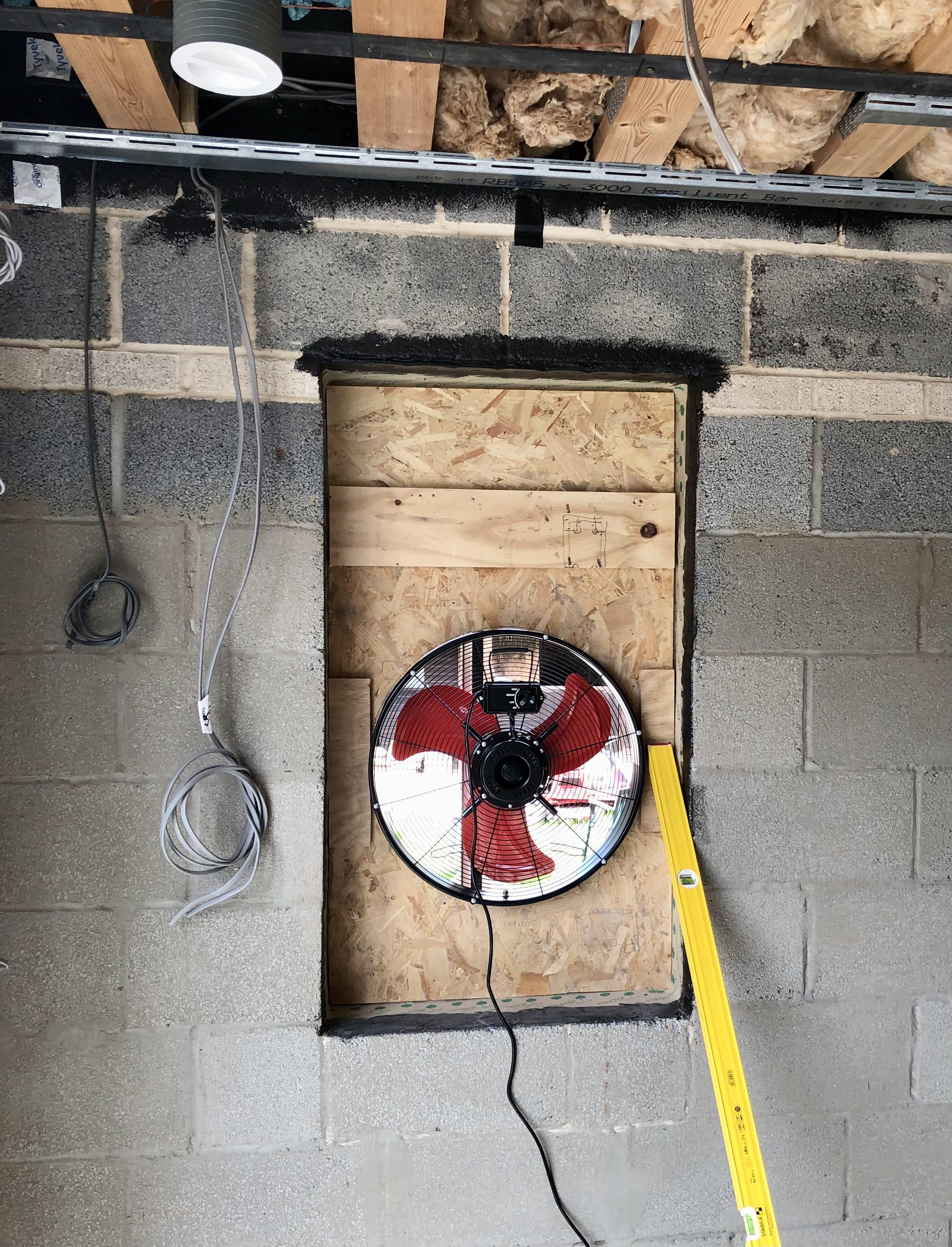

Thanks @RobLe you've gone above and beyond with the links.  I've picked up a fan from machinemart this aft, and ordered another couple of tubs of soudatight.  I'm just constructing something to block up a window opening, when I've done that, I'll depressurise and wage war on sealing what I can.
So you adjust the voltage to hit the target pressure, but how do you measure the flow rate?
Theres a post here by @ProDave that gave me something to work with.  As far as measuring pressures and voltage are concerned it's above my head at this point until I do some studying.
Flow rate is super hard - I was lucky enough to have access to a pro blower door, so I compared results between that fan and the pro kit, and made the graph I attached based on it.  The pro kit itself is calibrated, and has two differential pressure measurements - one to give room-external pressure, and the other measures across an orifice at the fan inlet; the data goes into a PC which uses the calibration data to give the flow.
If you use the same fan type, you can follow the lines graph I made to give flow at a given voltage and pressure.

You could just use a simple orifice plate. Basically a plate Infront of the fan with a hole in it. An orifice plate uses upstream and downstream pressure to determine the flow rate. You need to make it with a sharp edge so thin metal may be easiest.
Use something like the site below to calculate the flow. Use outside air pressure and inside building pressure as the two pressure inputs. So plate has to be outside in relation to the fan, so fan sucking through the orifice.

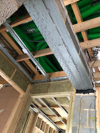

I've got a cavity wall running across my build, and one of these lintels spanning a doorway.
I'd completely ignored this but since I've had a look online it appears these are open at both ends into the cavity, albeit with polystyrene wedged into it.  Would it be ok to membrane over and tape up to seal it up do you think?
I would membrane the lot. Have you sealed the block work? Would that also leak into the cavity? Or is that being plastered later?
