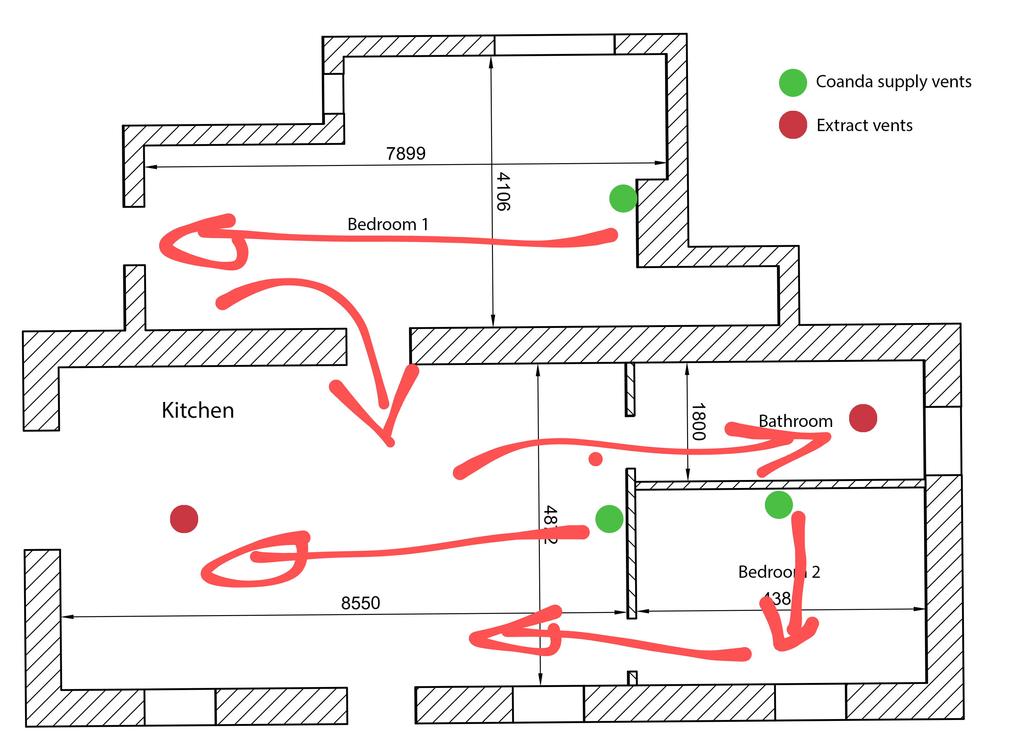

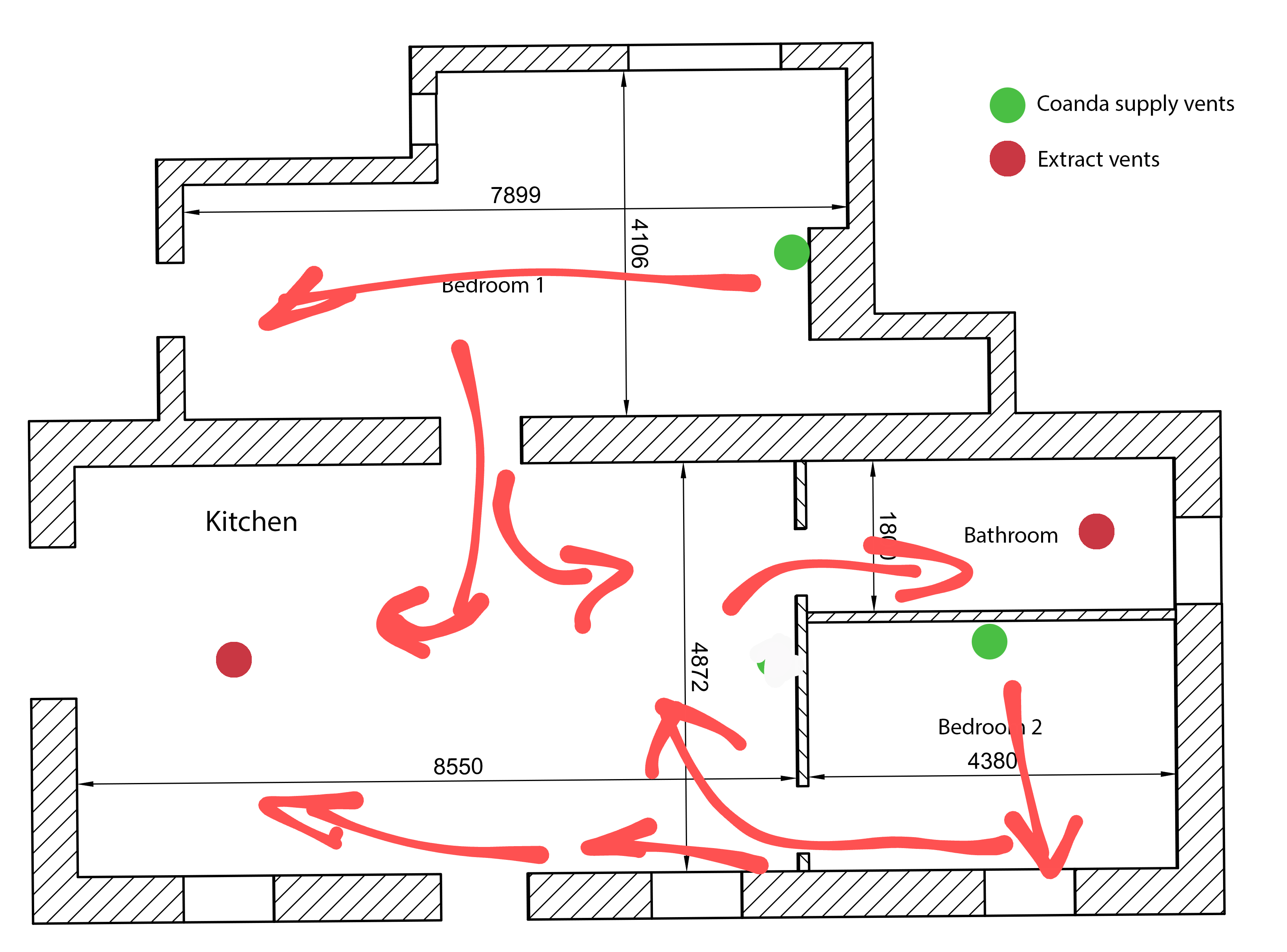

Philxyz Posted June 20, 2024 Author Posted June 20, 2024 Having got a design I now think I may install it myself. Maybe you would comment on my vent positions (see attached image). These are currently more positioned for ease of install. I suspect the far end away from the vent in Bedroom 1 might be lacking flow. How do they look to you?
JohnMo Posted June 20, 2024 Posted June 20, 2024 On 20/06/2024 at 12:30, Philxyz said: How do they look to you Expand I would expect the air flow would be quite good. Something like the attached. But looking at the layout, you could eliminate the lounge supply as you will get good cross flow from the bedrooms, just divide the supply flow to both bedrooms equally. I had just assumed it was an upstairs and downstairs configuration. Once you living with it you may be able to tweek the flows down also.
Philxyz Posted June 20, 2024 Author Posted June 20, 2024 In fact there is a mezzanine above the bathroom and bedroom 2. It will be used for utility and storage (the MVHR unit for example). Not a living arera but will be regularly accessed. Is it worth moving that supply vent onto the mezzanine?
