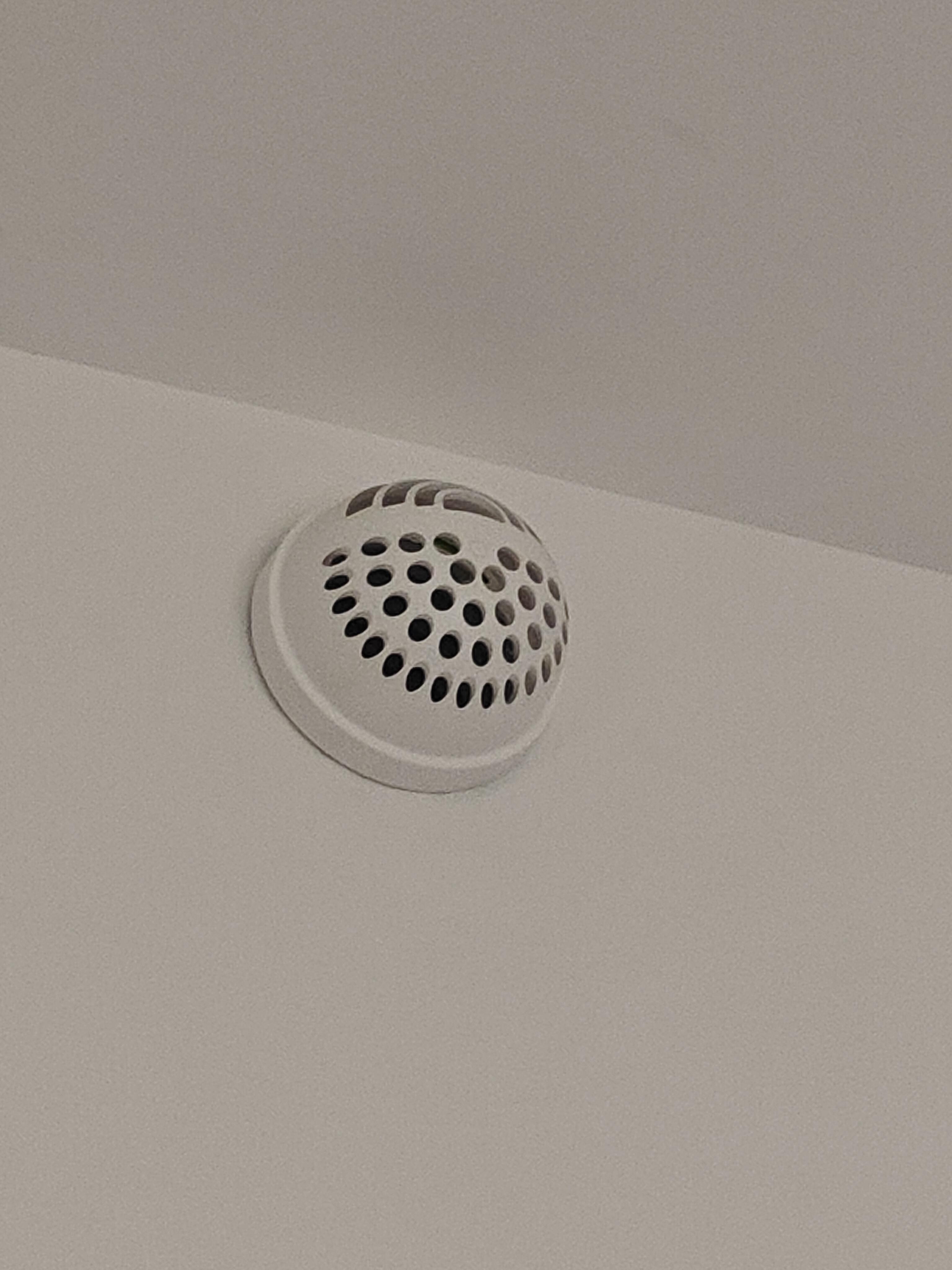

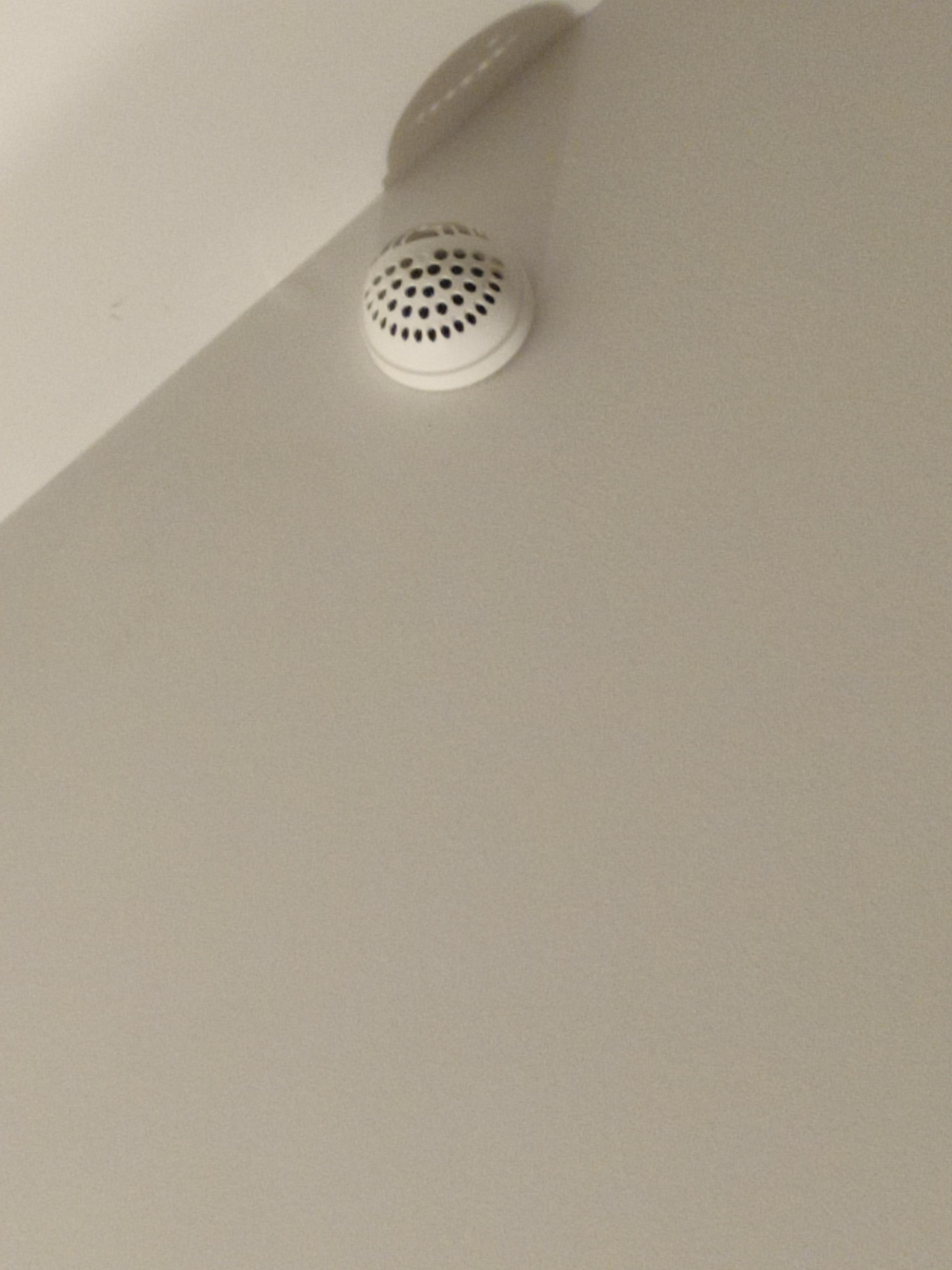

Putting together a parts list, and I cannot find install info for these Coanda grills.
  1. How close should they be to the ceiling?
  2. Can I connect these straight to a duct (eg in my case to a AE48C Bend 90°)?
I am on a steep learning curve and trying to minimise my questions here. Just tell me when you've had enough John!
25 minutes ago, Philxyz said:
  • How close should they be to the ceiling?
  • Can I connect these straight to a duct (eg in my case to a AE48C Bend 90°)?
My centres of duct is about 100 to 120mm from ceiling. I use AE48C bend and 90mm duct either side. I have attached the terminal direct to the 90mm duct. You just leave the duct about 15 to 20mm proud of the wall.17189695656937176880783402721756.thumb.jpg.a814515ea47237db9164db76c924e60c.jpg
