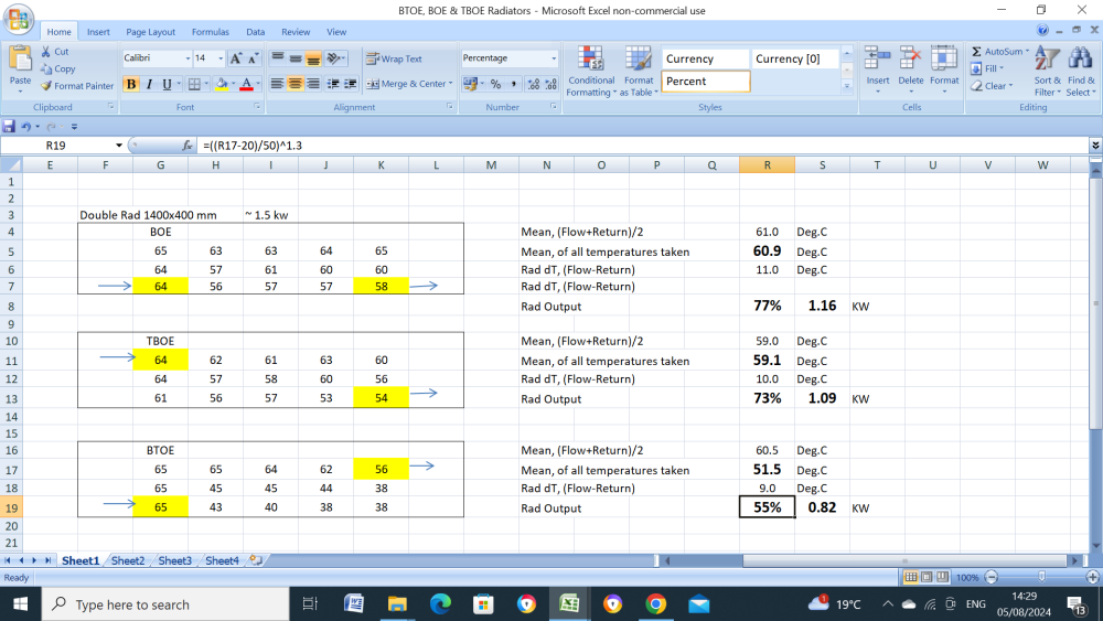

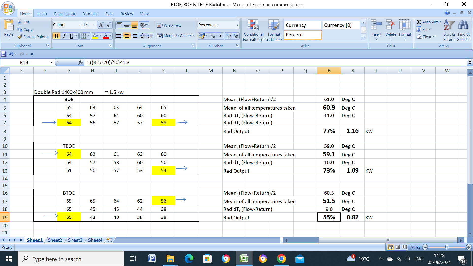

John Carroll Posted August 5, 2024 Posted August 5, 2024 Here are my actual readings. The BTOE is by far the worst, even though the (flow+return)/2 was 60.5C, the actual mean temp was only 51.5C.
Boab Posted February 12 Posted February 12 I was looking at your readings John but the BOE don't look right. The water in is 64 and the water out is 58 giving a difference of 6, not 11 as you state. And regardless of the temp readings at various points on the rad, wouldn't the one with the biggest temp difference from flow to return be the one that is emitting the most heat. So TBOE would be the winner?
marshian Posted February 12 Posted February 12 3 hours ago, Boab said: And regardless of the temp readings at various points on the rad, wouldn't the one with the biggest temp difference from flow to return be the one that is emitting the most heat. So TBOE would be the winner? The radiator with the highest mean temp would be the one that emitted the most heat (that might not be the highest difference)
SimonD Posted February 12 Posted February 12 11 hours ago, Boab said: So TBOE would be the winner? Yes. Like the figures I posted earlier, this provides the best output. Radiator manufacturer figures are usually based on Top and Bottom Same End. But remember that rad output depends on the air temperature differential too. So for example with a flow temp of 70 with return of 50 you have a mean water temp (mwt) of 60. Mean water - air temp differential is then mwt - air temp so output differences between 21 degrees and 16 degrees are as follows: 60-21 = 39 60-16 = 44 To get the actual radiator output you then divide this by the manufactures delta, usually 50 so: 39/50=0.78 44/50=0.88 This means that with a room temp of 21 the radiator output is 78% of catalogue and with 16 degrees it's 88% Which clearly shows that even just 5 degrees has a big impact on output. You then take these results and multiply by the connector emissions factor which for TBOE is 1.05 or 0.96 for BOE Plus there are other factors used for the whole calculation.
John Carroll Posted February 12 Posted February 12 You should use the exponential 1.3, thats why they speak of weather compensation curves even though heat loss is linear but rad output isn't. So its (39/50)^1.3 = 0.724 and (44/50)^1.3 = 0.847 not hugely different to the above but does become significent at low rad mean temps. 1
