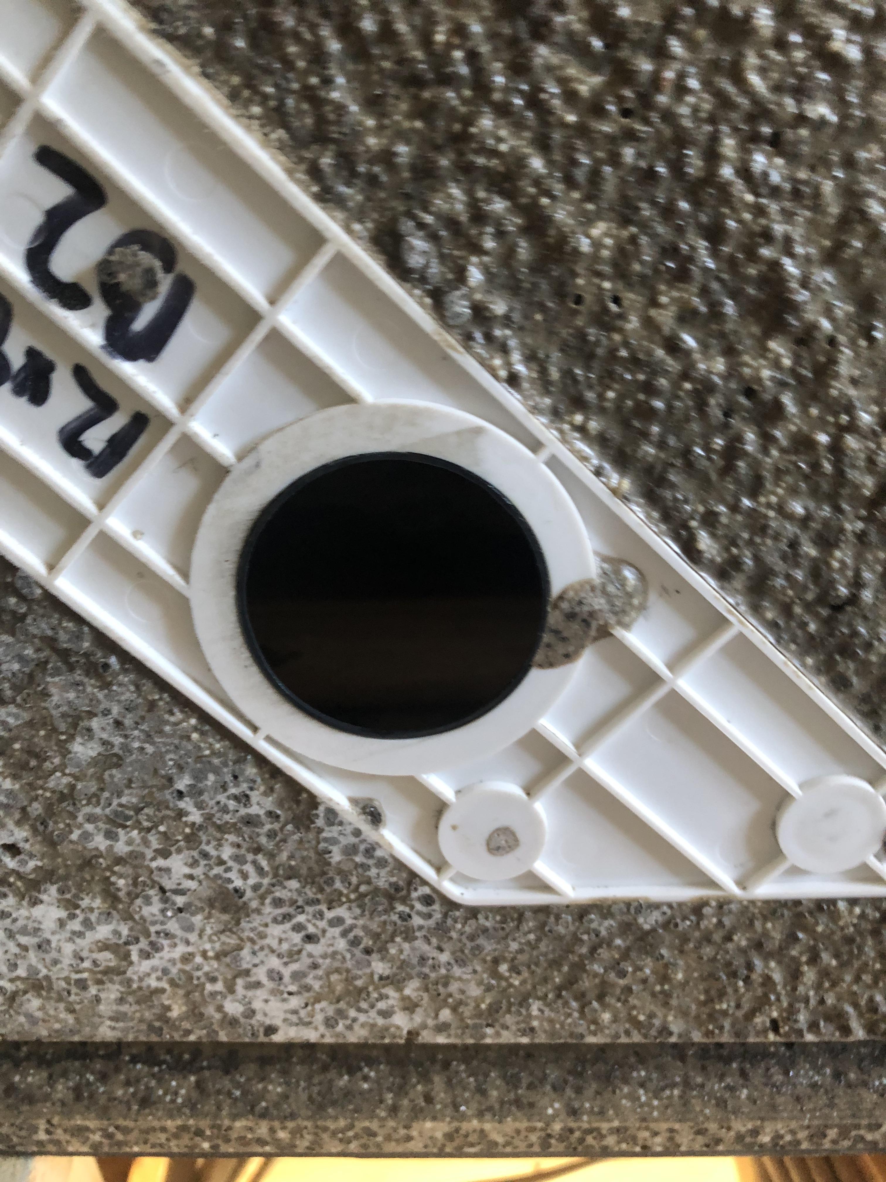

Stone resin shower tray with two outlets, manufactured so that if you have joists in the way you can switch outlet or use both in other circumstances.
 The Outlet has a stone resin snot on it, am I being unreasonable in rejecting?  Technical support have confirmed with me that I might not be able to make a good seal on the trap.
It’s just I’ve had 2 attempted deliveries of replacements showing the same issue, so I’ve started wondering if maybe I’m the problem not the tray🤣

Well it’s stuck/bonded fast and yes I could take a sharp chisel to it, but, if i damage the tray, tech support have told me that it’s on me and 350 notes in the skip.
so get it changed. If it was easy to correct and they cared to do quality control, then it would have been wiped or chipped off at source. Hence presumably it is a highish risk.
How thick is it?
33 minutes ago, nod said:
YES
Is this yes, its a faulty  product or yes take the risk and chip it off, or yes, use it and find out too late if it leaks ?

19 minutes ago, saveasteading said:
How thick is it?
one to two mm at worst.
hopefully another replacement coming tomorrow.  Fingers crossed they have checked the stock before putting it on the wagon.
I'm just having one of those weeks on the build where nothing goes to plan, I just need to get a bit of perspective back.
How thick is it?
I think your being picky
Quick tap with a chisel
Zero chance of damaging
Ive a faulty one that I hit several time a with a lump hammer and made no impression
Or send it back
