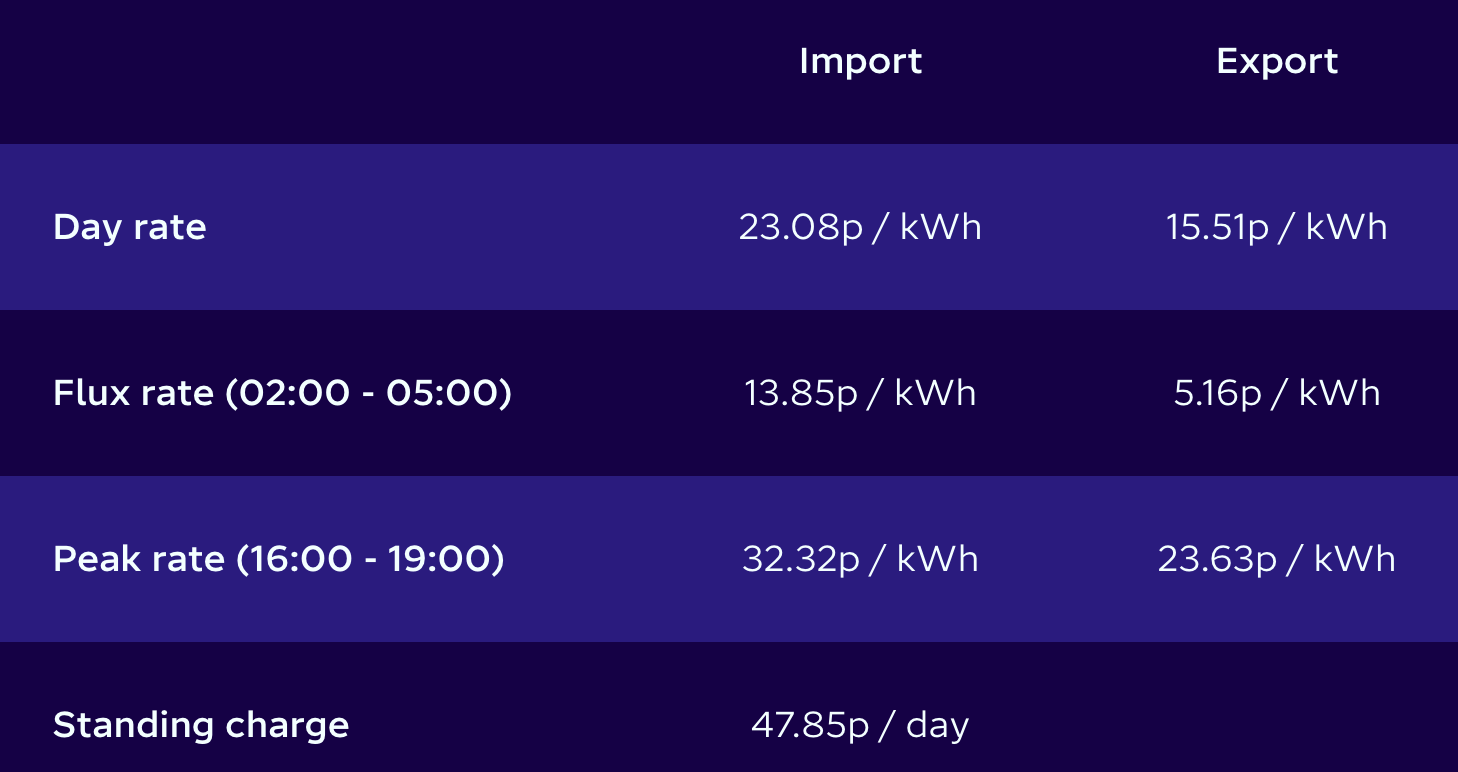

Sorry for the long delay, but to answer your question, my home is pretty smart with Loxone as the central brain. It's interfaced with my (solax) inverter so I know when I have excess power. Secondly it allows me to directly control heating (A2A, A2W ASHPs, including which FCUs should aim for which temperature, which UFH zones should heat or cool). My car charger is also loxone, so if I have excess power I have the option of cooling/heating my underfloor (and I have concrete floors so good thermal mass), export to grid, or put power into my car battery.
I am still somewhat struggling to wrap my head around what's the best to do with excess power. I find myself mulling over @Nick Thomas point:
On 02/06/2024 at 10:46, Nick Thomas said:
I woke up this morning thinking that the 300% efficiency thing is a bit of a red herring here ^^.
If you export at 25p (peak) in summer, then buy at regular prices in winter (again ~25p) to put into your heat pump, it still gets the CoP boost
This seems to certainly be true. So to make that a bit more explicit:
Peak: 16:00-19:00
- Avoid importing - Easy, normally, even on gloomy days.
- Export everything I can - 23.63p gained.
    -> Arguably, fully emptying my battery into export might make sense because importing it during day rate is cheaper (23.08). I don't have that level of control on my inverter I think.
    -> Similarly, not charging my battery during peak might make sense. (noting the above to not have to import during peak)
Flux: 02:00-05:00
- Do everything that can be done.
    -> Wash laundry, wash dishes, heat hot water, heat/cool slab, charge car.
All other times:
- Charge battery if possible
- Do normal things
I guess I'll have to take a look at my inverter to see if I can tell it to do the above.
I wouldn't worry too much about doing this. I've read that the difference between peak export and normal rate import is there to compensate for the inefficiencies in battery storage, although I forget where.
On Octopus Go Intelligent, cheap rate import is 7p and export is 15p - so that's a lot more than compensating for the inefficiencies of battery storage. So dumping what's the left in the battery before reloading it at the end of the cheap rate makes sense.  But disable any diverter during the dump.
