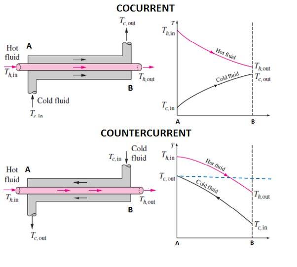

JohnMo Posted May 16, 2024 Share Posted May 16, 2024 24 minutes ago, Garald said: Just asked an applied friend, and he has a conjecture. Is this it? https://www.heatpipe.com/engineering-manual/heat-pipe-principle-and-applications/?fbclid=IwZXh0bgNhZW0CMTAAAR3xQrm_78fPi0UOOwRZvEYPSuy8r1Atsg9g5ALqL1trhn65aqvViZ6tgQk_aem_ASjRtEBhO0MTBUHkK_BqoJqJDEcObo2s0pIrxF4ZWED0yDAxIgtn3VCF2OWCIEW27dVGLj4-U9egT6L7gMAfaLax No, it's just a cross flow heat exchanger. Hot air from house goes in one end of the exchanger (end A) and cooled air come out the other end (end B). Cold air from outside enters at end B and come out to feed the house at end A. Imagine a tube, inside a tube, the inside tube is the outgoing flow, the annulus formed between the tubes has the incoming flow. Both flow in opposite directions. If the tubes were long enough the temperature of the air at both ends of inner and outer/inner tube annulus would end up at the same temperature. As heat always moves to cold. If the heat exchanger was 100% efficient the mid point between end A and B would be at half the difference between inside air temperature and outside air temperature for both incoming and outgoings air streams. But because they are not 100% efficient you get a slight difference in temperature at end A and B between the incoming and outgoing flows. No magic going on. Link to comment Share on other sites More sharing options...
Garald Posted May 16, 2024 Author Share Posted May 16, 2024 (edited) 1 hour ago, JohnMo said: No, it's just a cross flow heat exchanger. Hot air from house goes in one end of the exchanger (end A) and cooled air come out the other end (end B). Cold air from outside enters at end B and come out to feed the house at end A. Imagine a tube, inside a tube, the inside tube is the outgoing flow, the annulus formed between the tubes has the incoming flow. Both flow in opposite directions. If the tubes were long enough the temperature of the air at both ends of inner and outer/inner tube annulus would end up at the same temperature. As heat always moves to cold. If the heat exchanger was 100% efficient the mid point between end A and B would be at half the difference between inside air temperature and outside air temperature for both incoming and outgoings air streams. But because they are not 100% efficient you get a slight difference in temperature at end A and B between the incoming and outgoing flows. No magic going on. But this is not what the diagram you post yourself shows! If it were just what you say, the exhaust temperature would be a little higher than 12.5C, and th supply temperature a little lower than 12.5C. That's not at all what the diagram depicts. Edited May 16, 2024 by Garald Link to comment Share on other sites More sharing options...
Tumble Posted May 18, 2024 Share Posted May 18, 2024 These heat exchangers aren’t working on the bulk energy of the air, but rather the local energy at each point in the exchanger. As these are contra-flow exchangers the hot extract air entering is exchanging heat with the supply air right as it exits. As the extract air progresses through the exchanger its temperature will drop as the energy is extracted until it’s basically at the external air temperature. Does that help? I’ve also found this diagram, which shows the difference between a parallel-flow and contra-flow exchanger: Link to comment Share on other sites More sharing options...
Garald Posted May 18, 2024 Author Share Posted May 18, 2024 2 hours ago, Tumble said: These heat exchangers aren’t working on the bulk energy of the air, but rather the local energy at each point in the exchanger. As these are contra-flow exchangers the hot extract air entering is exchanging heat with the supply air right as it exits. As the extract air progresses through the exchanger its temperature will drop as the energy is extracted until it’s basically at the external air temperature. Does that help? I’ve also found this diagram, which shows the difference between a parallel-flow and contra-flow exchanger: Ah, that's very nice! Thank you! Link to comment Share on other sites More sharing options...
