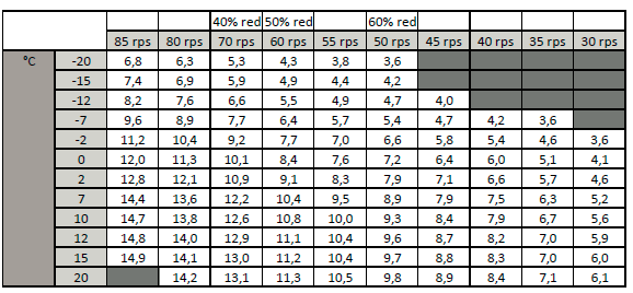

CalvinHobbes Posted May 14, 2024 Author Posted May 14, 2024 (edited) So 2nd quote in and it gave quite a lot of info. Only thing is they missed that it's 3 phase. Is there anything you think I should ask? Also I thought we had to get aluminium rads upstairs? Edited May 14, 2024 by CalvinHobbes

sharpener Posted May 14, 2024 Posted May 14, 2024 (edited) 10kW is massive for a modern house, maybe up to 400 sq m. This unit will actually produce 11.6 kW at -1C OAT and 45C flow so where did they get the 10.8 from? see the chart below. The 7kW unit will produce 9.25 kW under the same conditions so is spot on for your heat loss. This will make a big difference as the 10kW is really a dumbed down 12kW and is likewise a twin-fan unit so too big (in England) for deemed planning permission and needing a planning application. Do you really want the bedrooms to be at 18C, many ppl would find that uncomfortably hot. They have shown rad flow 45C return 35C. But the Vaillant HP will always produce 5C delta T so something is wrong here too. The schematic shows a buffer (why?) but only a single, UFH, heating circuit however there is a schedule for radiators as well. The parts list does show a VR71 wiring centre which you will defo need to control rads + UFH + DHW. It should appear on the schematic as item 12e but it is not there, confirming they have proposed the wrong schematic. Edited May 15, 2024 by sharpener 1
CalvinHobbes Posted May 15, 2024 Author Posted May 15, 2024 3 hours ago, sharpener said: 10kW is massive for a modern house, maybe up to 400 sq m. This unit will actually produce 11.6 kW at -1C OAT and 45C flow so where did they get the 10.8 from? see the chart below. The 7kW unit will produce 9.25 kW under the same conditions so is spot on for your heat loss. This will make a big difference as the 10kW is really a dumbed down 12kW and is likewise a twin-fan unit so too big (in England) for deemed planning permission and needing a planning application. Do you really want the bedrooms to be at 18C, many ppl would find that uncomfortably hot. They have shown rad flow 45C return 35C. But the Vaillant HP will always produce 5C delta T so something is wrong here too. The schematic shows a buffer (why?) but only a single, UFH, heating circuit however there is a schedule for radiators as well. The parts list does show a VR71 wiring centre which you will defo need to control rads + UFH + DHW. It should appear on the schematic as item 12e but it is not there, confirming they have proposed the wrong schematic. Tremendously appreciated! I have sent him your comments and will report back.
