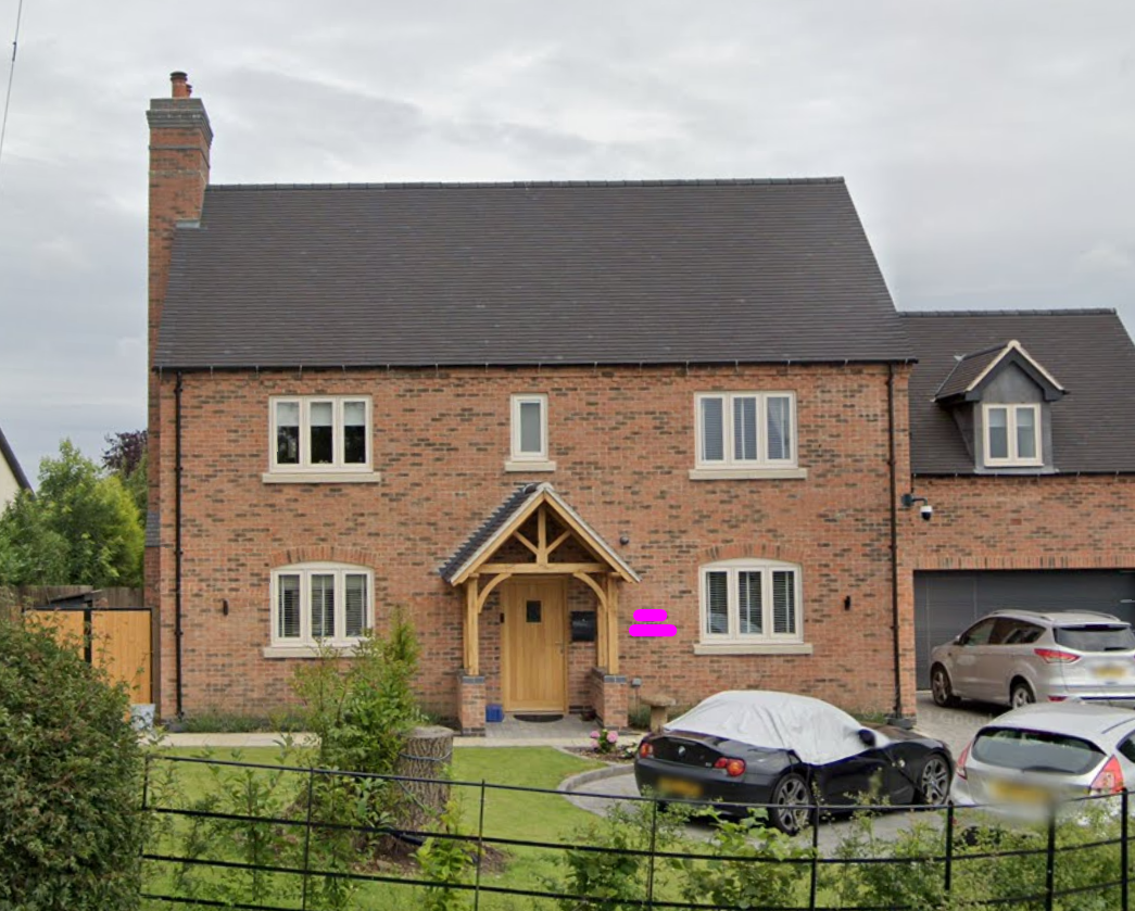

I have flush casement windows from deceuninck, got them for a great price and they look amazing compared to standard UPVC.

As an aside the Z4 is for sale for a very reasonable price.
