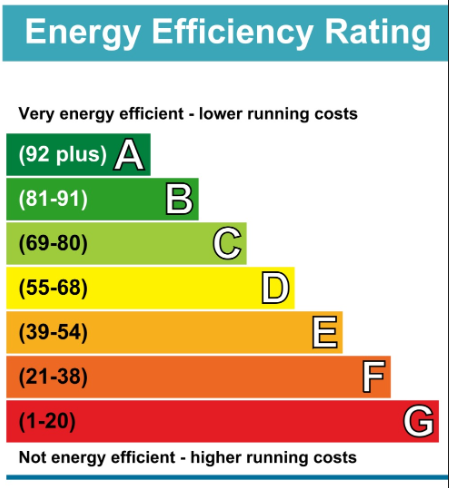

Our work should also increase our EPC, but that wouldn't be difficult as it is currently 4, yep 4, not a typo, and that was with 200mm of loft insulation

Not sure what you mean by a '4' as EPC ratings are A to E?
Not exactly - the A to G ratings are just simplifying the presentation of the result. There is an actual numerical score underneath
