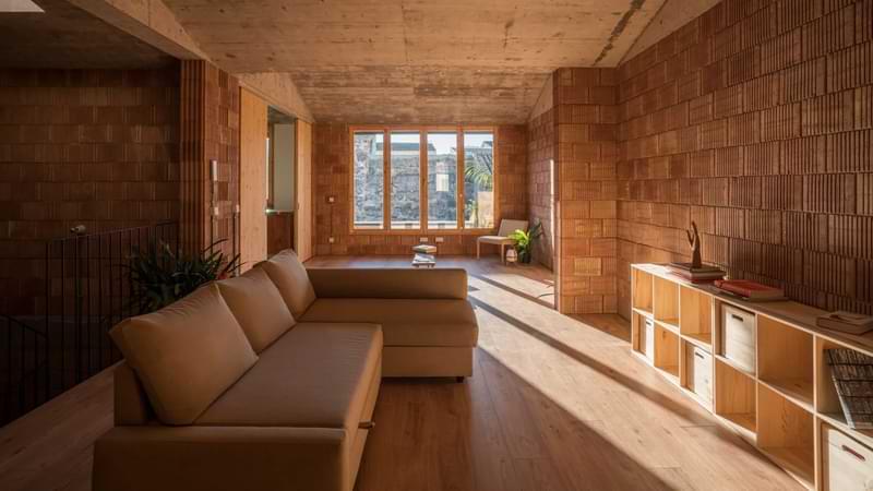

Adaman Posted May 3 Share Posted May 3 (edited) Hi all, I did a lot of research into breathability because I wanted to do a barn conversion. In the end we found a lovely plot with great views and an existing project, already authorised. The climate in northern Spain can be harsh in the winter, cold winds from the Atlantic, rain, humidity, in the summer it can be damp too but can also reach high 30s (ºc). The plan state that the building will be made with hollow clay bricks - Termoarcilla - in spanish, photo attached, sorry don't know what they are called in English. The question I have is if it even worth it, going down the breathability route? The building already has a ventilated concrete slab, building code will require a damp proof course. There should be no danger of rising damp. Planning to include continuos exhaust fan in the bathroom and HRV in the house. Inside I still feel that hemp bricks or woodfibre boards are going to be much more cosy than plasterboard. Outside I'd like include ETICS options are EPS, woodfibre, rockwool. EPS would be the cheapest. Only concern on EPS is the fire risk and that I don't really like plastic derivatives, other that that the benefits are cost and longevity. Would any of you guys even consider going breathable on a conventional building? If so why? If not, what would your preffered option be? Thanks in advance and looking forward to your comments! Edited May 3 by Adaman Link to comment Share on other sites More sharing options...
SteamyTea Posted May 3 Share Posted May 3 (edited) Welcome You are asking the impossible really. To get anywhere close to comparing to a typical modern build where you have a vapour control layer (VLC) on the warm side, then more vapour open as you move towards the cold side, you will need to know the mu-value (µ = MN.s.gram-1) of every component you intend to build with. You will also need to properly analysis your local climate as I suspect it is on the cusp of a Northern Europe climate and a Mediterranean one. Different climate zones have different building codes to cope with the local climates i.e. UK uses the VLC on the inside (warm side) and then controls ventilation rates, the Southern USA has the VLC on the outside and controls the ventilation via air conditioning. Try and find out what your local building standards are as the first research, choosing materials is a long way down the list. Edited May 3 by SteamyTea Link to comment Share on other sites More sharing options...
