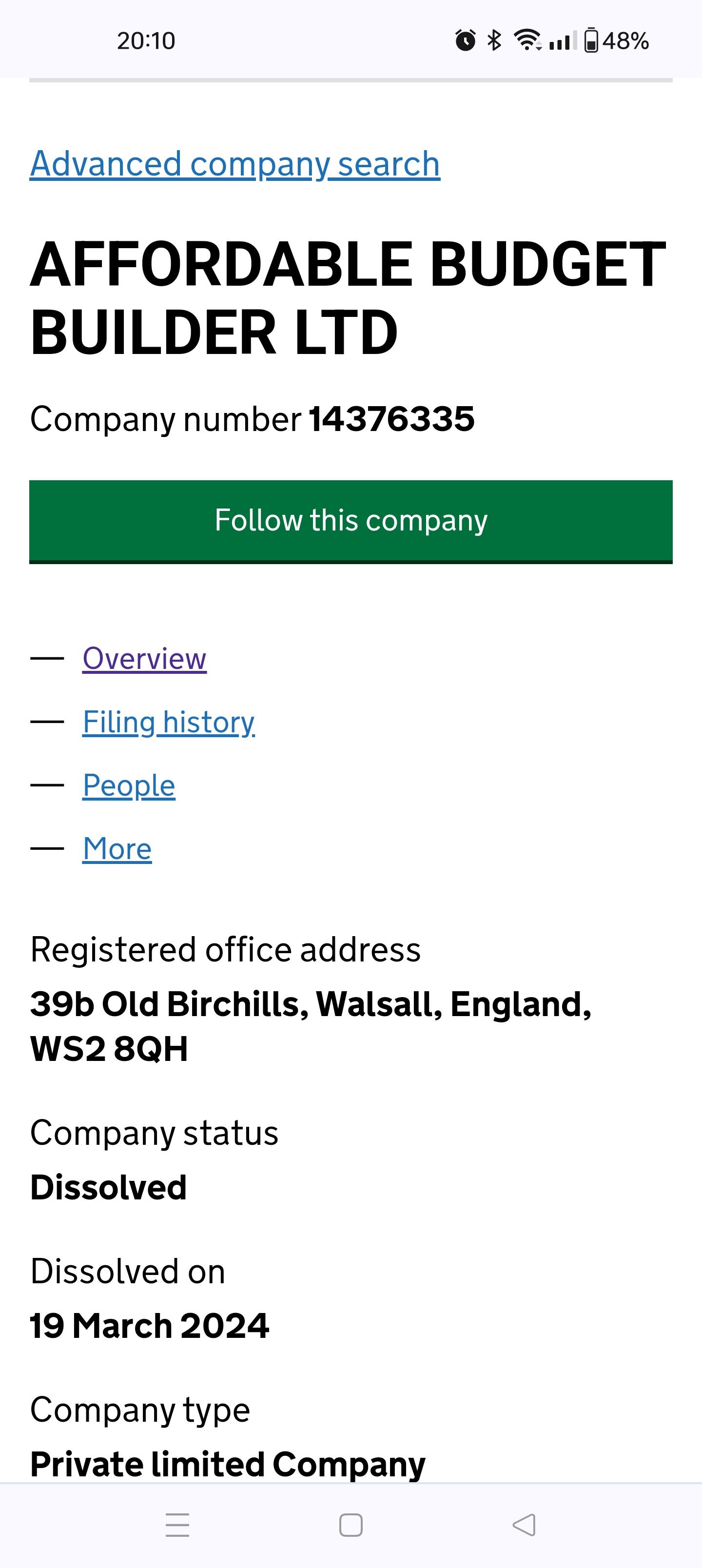

smart51 Posted May 3, 2024 Author Posted May 3, 2024 All three were given architects drawings that specified materials. All three did a site visit and I gave them the same information. The expensive one wrote to us when we got planning permission. The cheap one is called "affordable budget builder Ltd" and put a leaflet through the door. The other was a recommendation from a neighbour.

twice round the block Posted May 3, 2024 Posted May 3, 2024 (edited) 5 hours ago, smart51 said: All three were given architects drawings that specified materials. All three did a site visit and I gave them the same information. The expensive one wrote to us when we got planning permission. The cheap one is called "affordable budget builder Ltd" and put a leaflet through the door. The other was a recommendation from a neighbour. Can't find any search for." affordable budget builder Ltd. in your area that is trading. Could be £20 Limited Company. Steer clear. Builders quite often tout for your work on the back of the planning application's. I'd like to see their last couple of job's and speak to the households if it went smoothly. As mentioned above quality of the window's and the budget for them is a big factor in this build, and it needs to be right. I'm very surprised your architects have not provided contact details of their preferred contractor's. Edited May 3, 2024 by twice round the block 1

JohnMo Posted May 4, 2024 Posted May 4, 2024 On 03/05/2024 at 16:40, twice round the block said: Can't find any search for." affordable budget builder Ltd. First hit companies house h dissolved in March 24. 2
